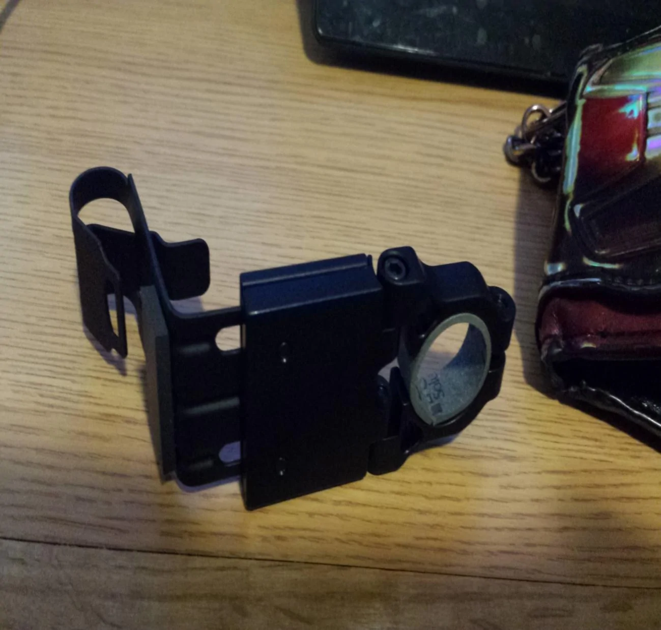

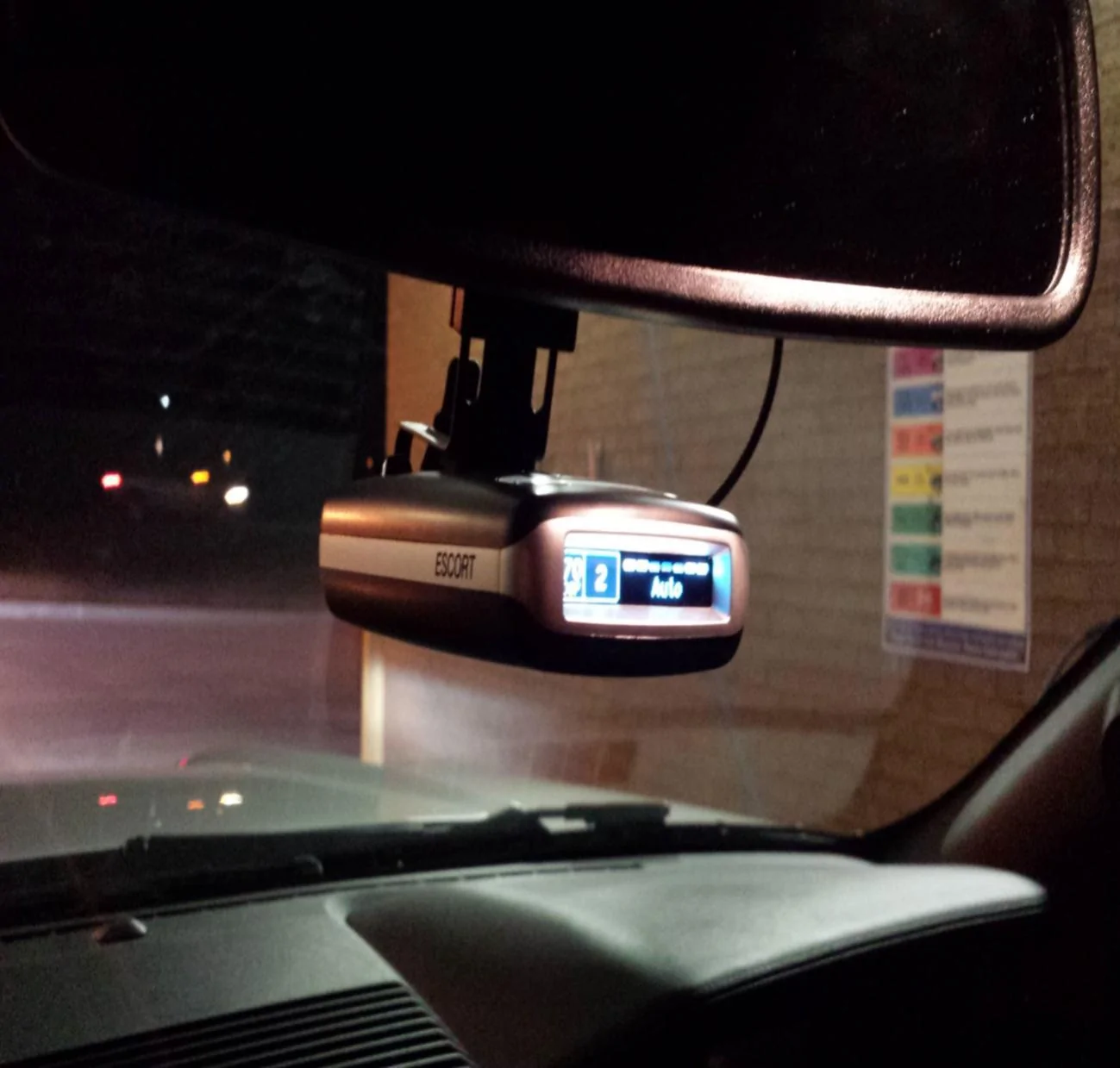

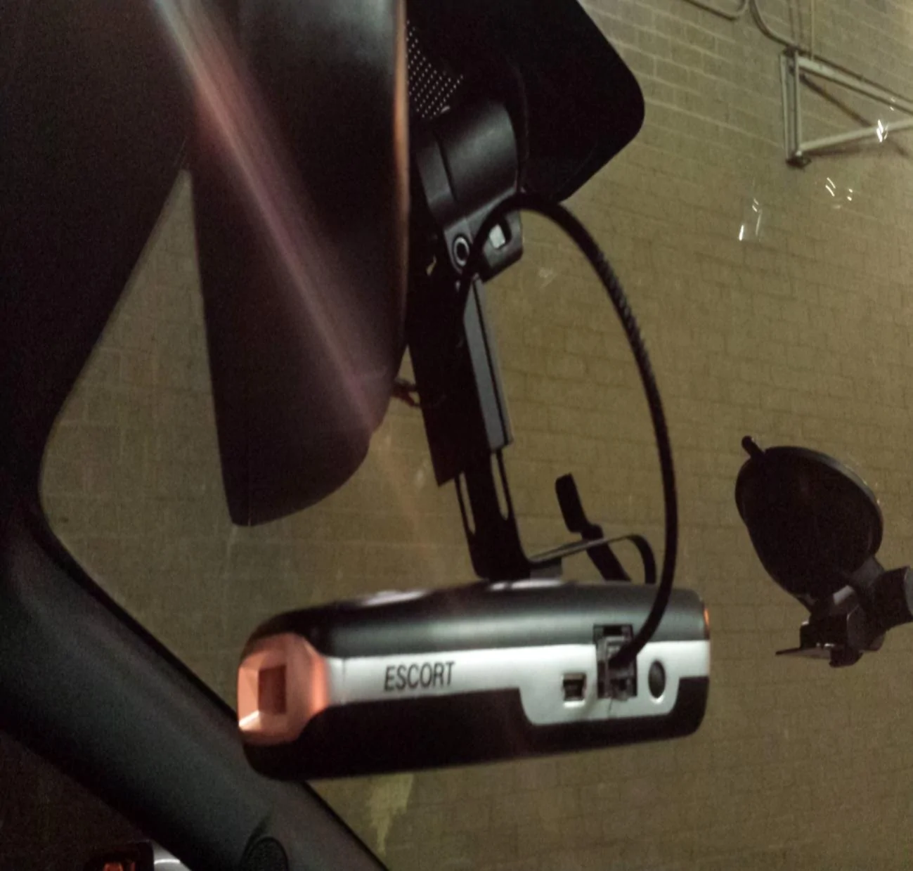

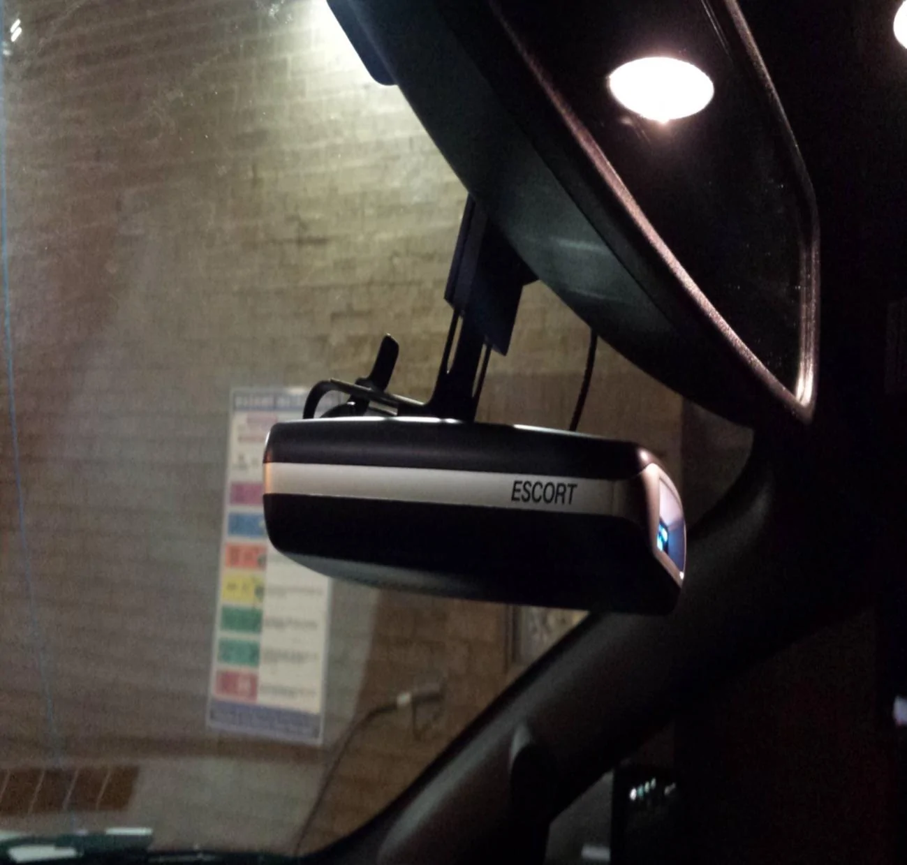

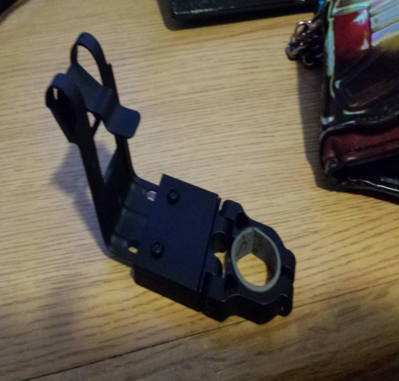

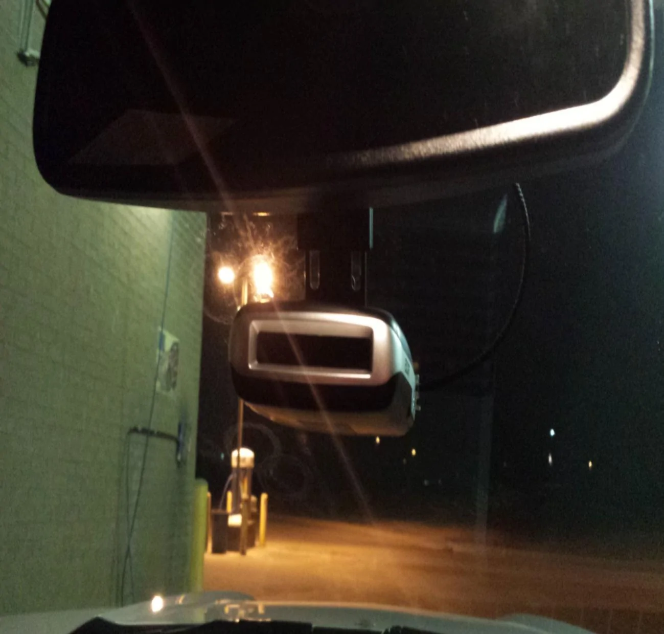

Here's pics of my install with the mirror mount and mirror tap.
A few things to note: the mirror cable is run INSIDE the mirror mount, between the left machine screw and the mirror stem. It runs right into the cable/strain relief collar which my mirror mount is tightened down right behind. Right now I only used one wire tie to basically loop the 9" mirror tap up around the top of the stem. I didn't want to pull it too taut, if only because I sometimes remove it for use in other vehicles (when traveling).
Thanks for the pics and description. One question - can you adjust it to get the detector closer to the mirror?
