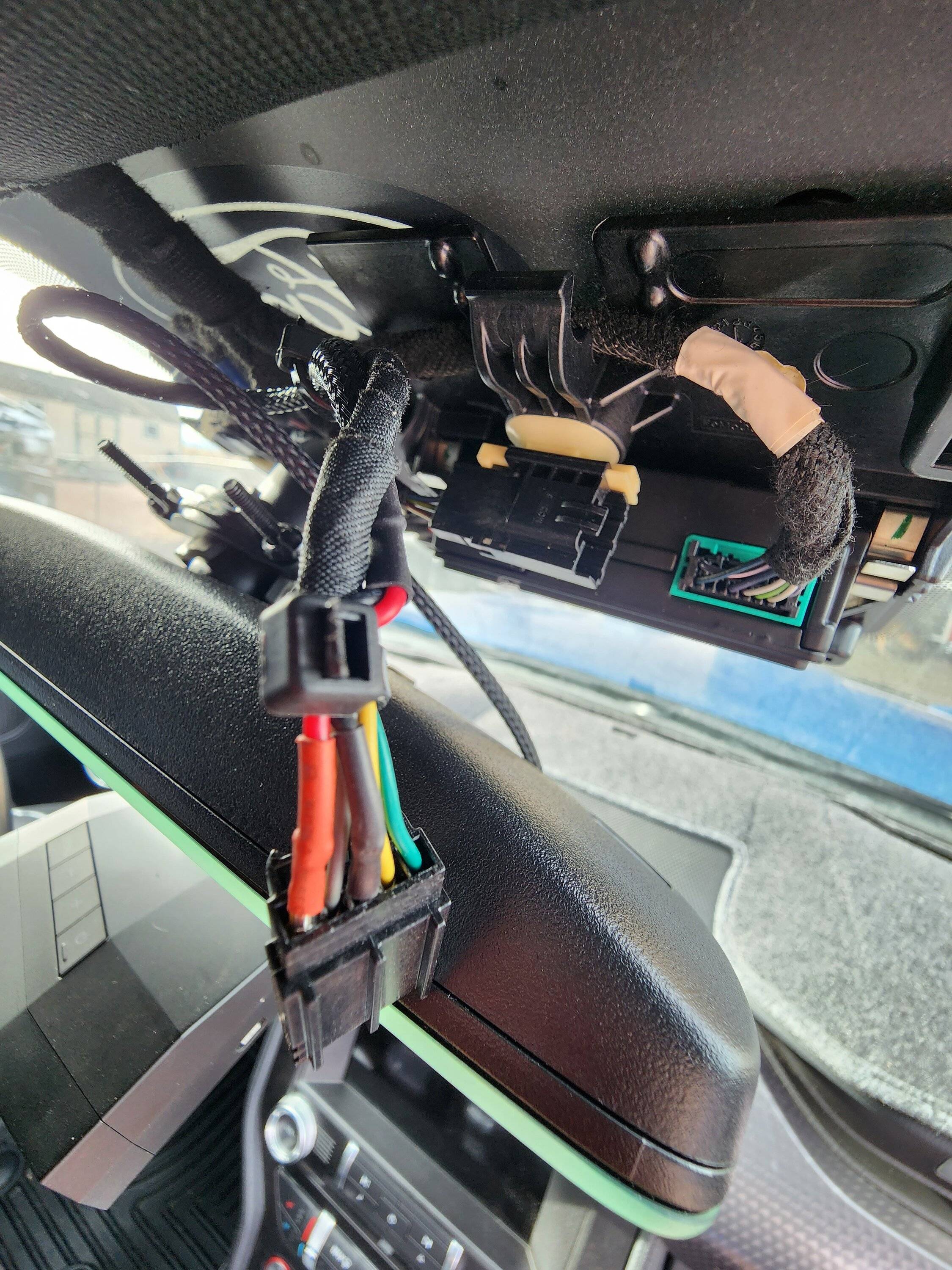

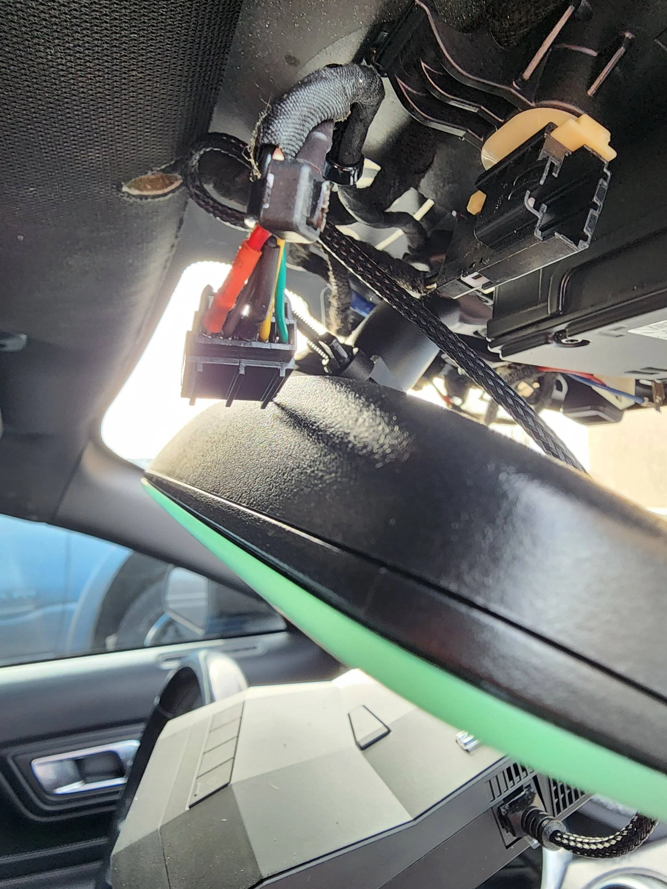

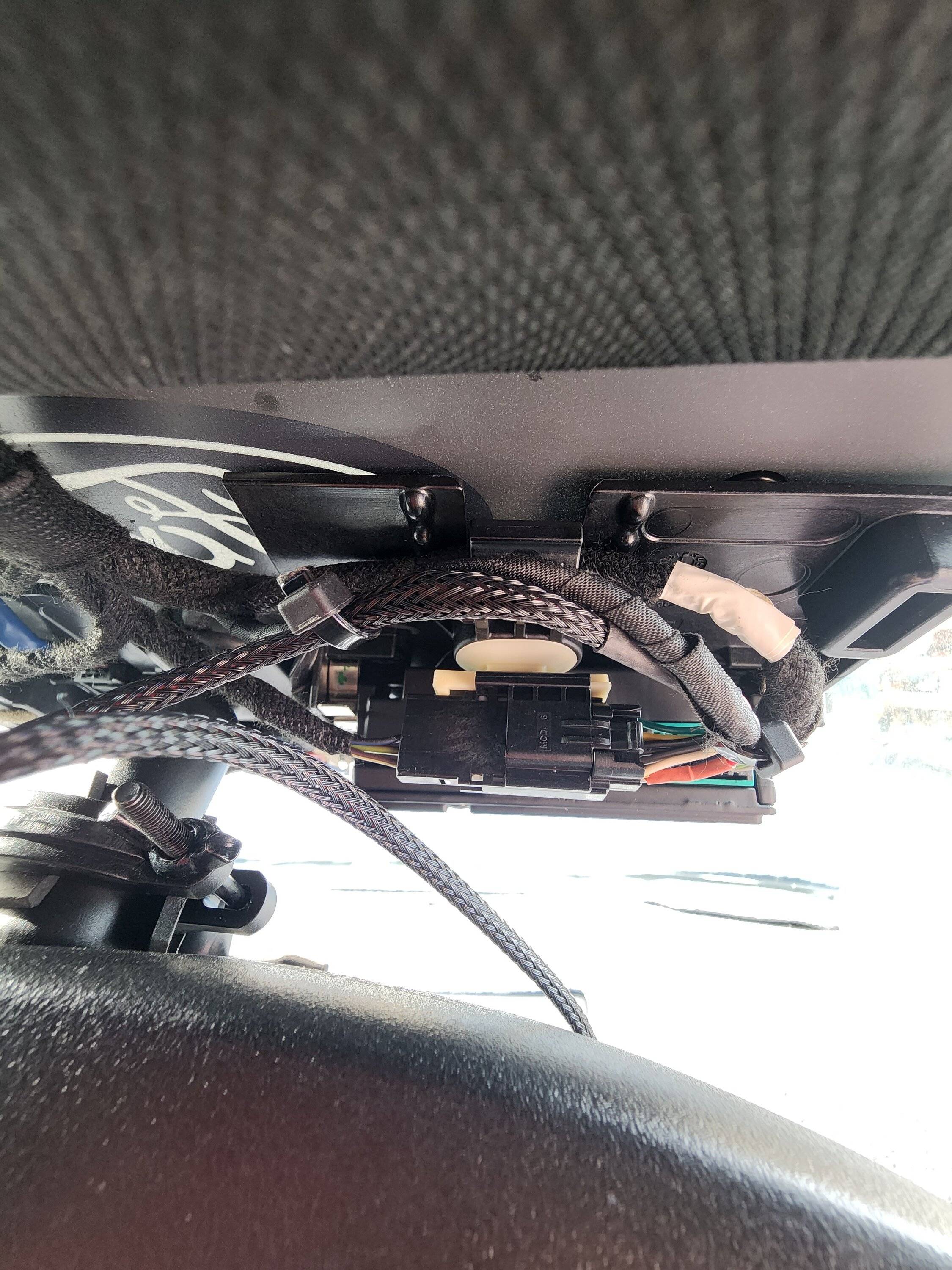

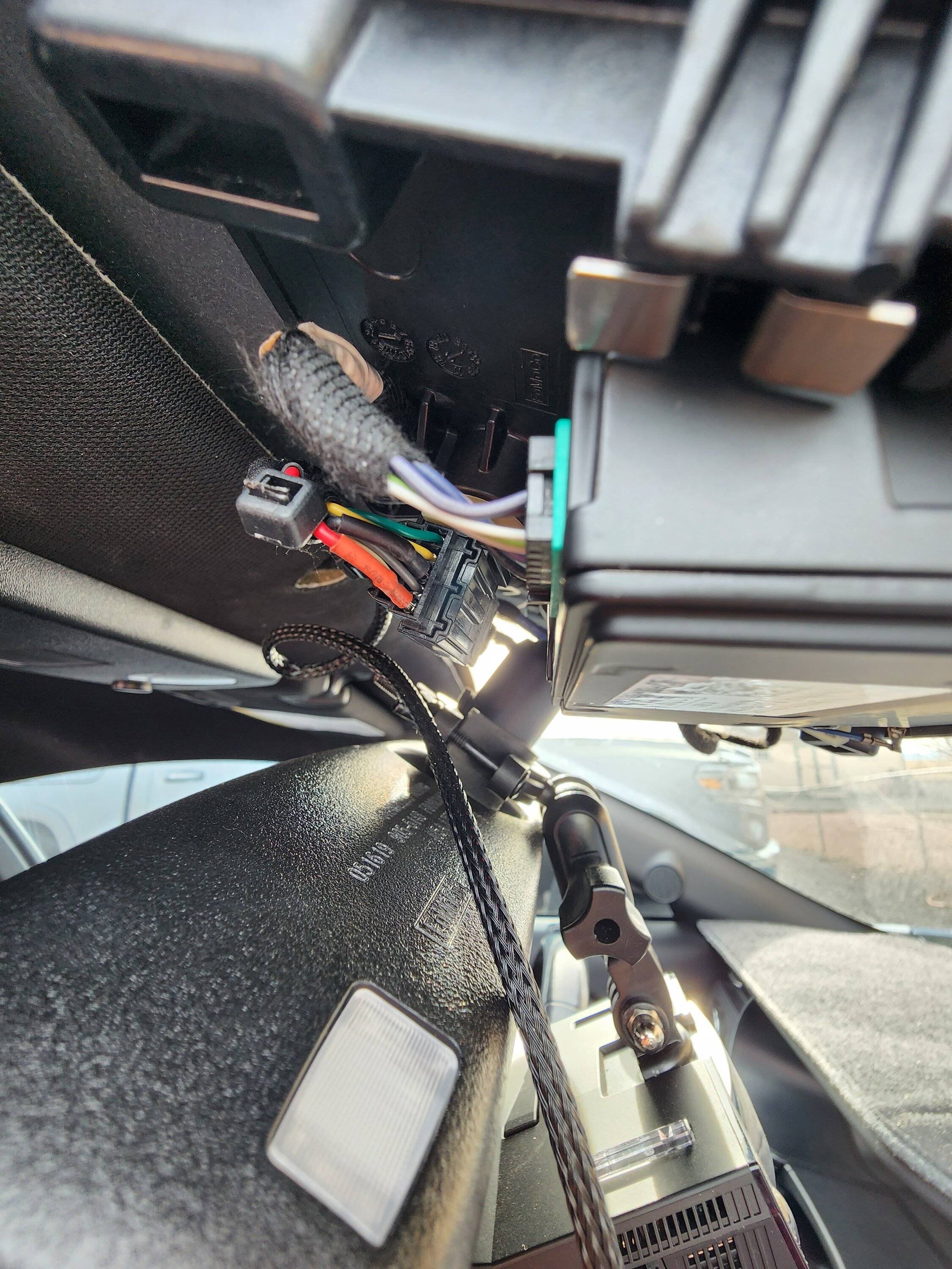

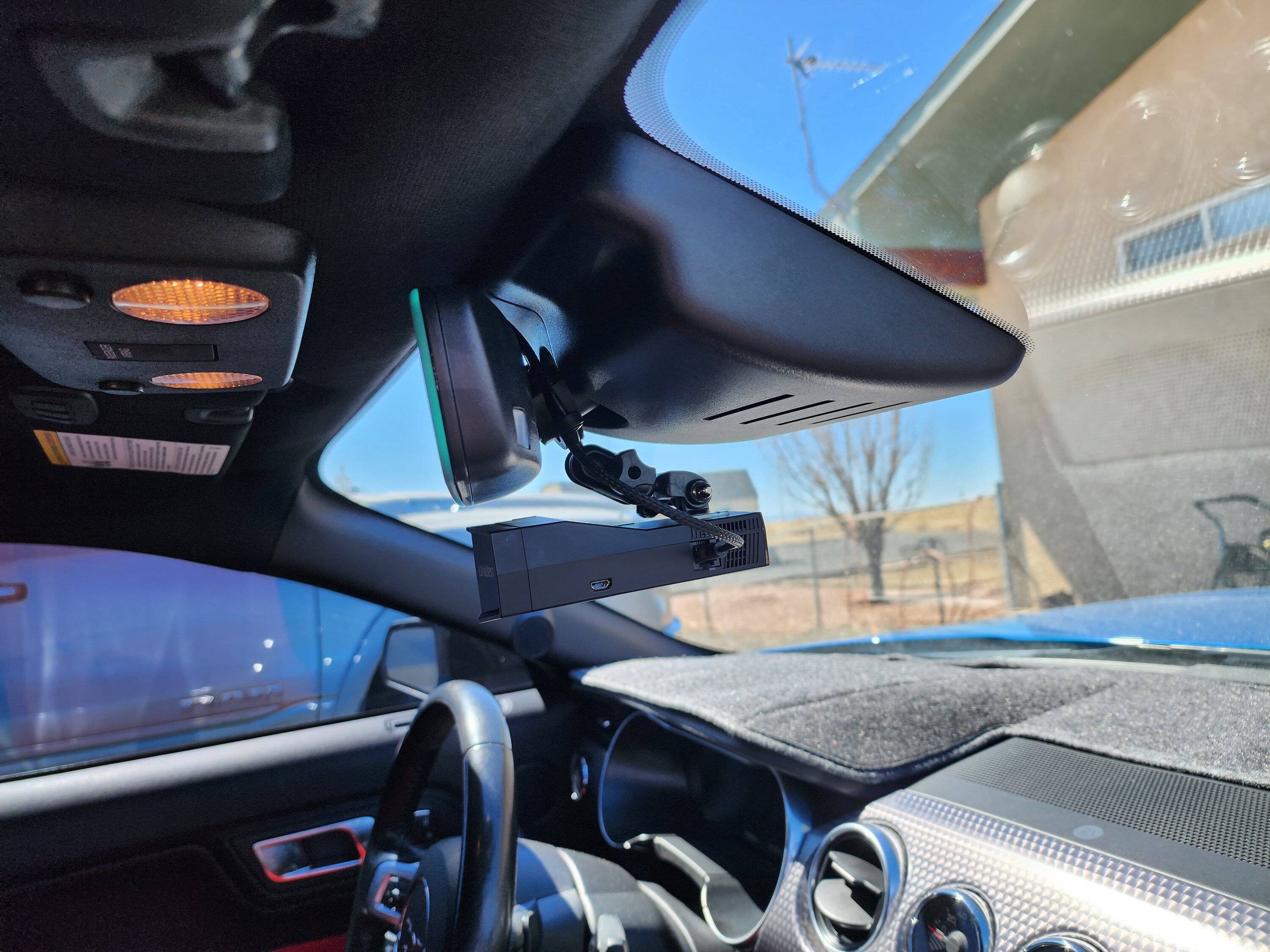

I was concerned about it also, but bought some taps and a mount from Amazon, and it went very easily. Using Uniden R8. The pics probably look confusing, but will make sense one you pop the cover off and watch the video posted earlier.
https://www.amazon.com/gp/aw/d/B082V1245P?psc=1&ref=ppx_pop_mob_b_asin_title
https://www.amazon.com/gp/aw/d/B083JQLQB5?psc=1&ref=ppx_pop_mob_b_asin_title
