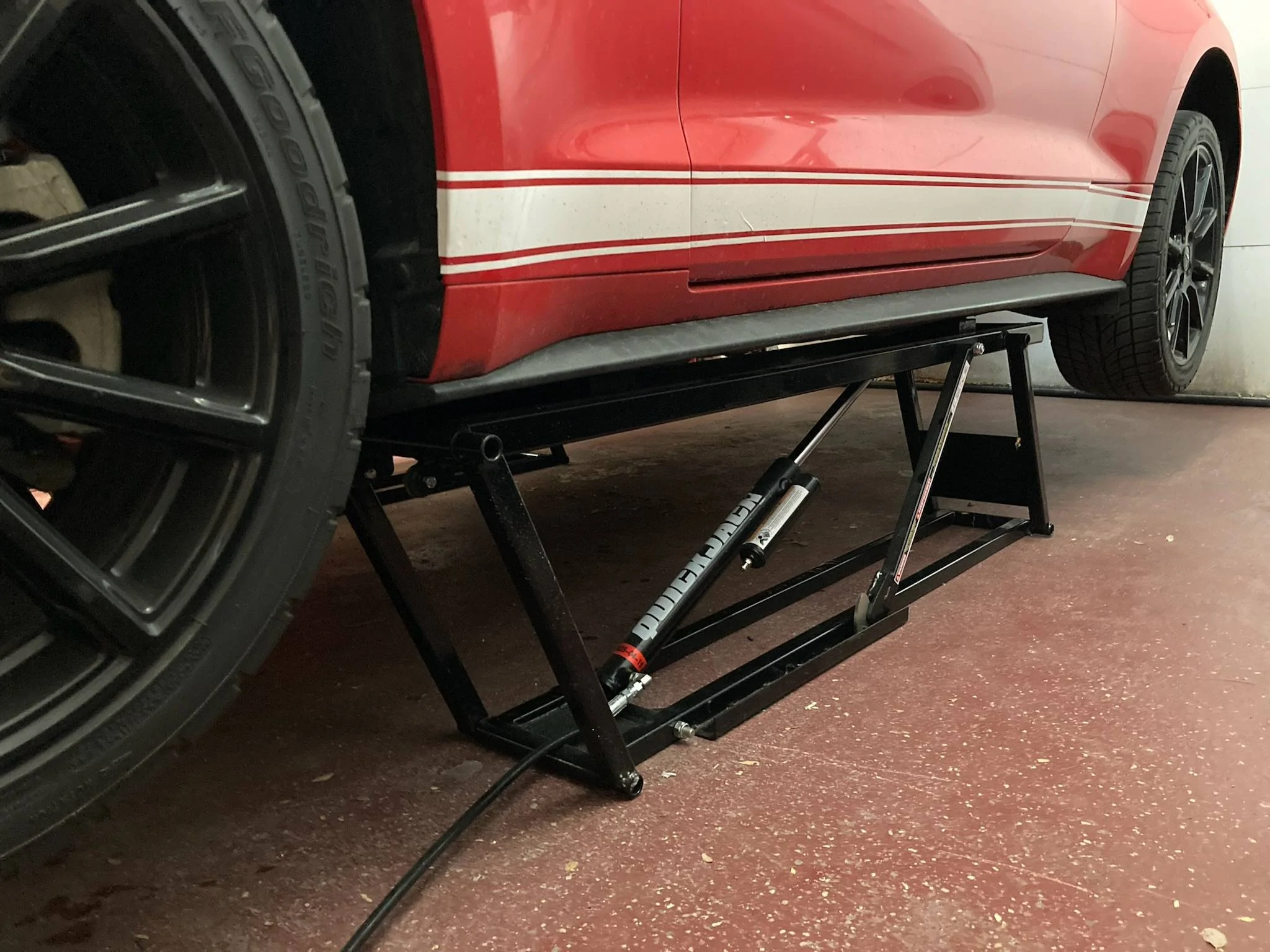

Here, found pictures of when the car is lifted last time to show you where it is best positioned.
Thanks for the pictures, that gives me a better look at everything. Nice to know I can use the rail for the front blocks and then the pinch welds for the rear blocks. Probably go with a 7000TL so I can lift pretty much everything and it's the same size as the 5000TL.
