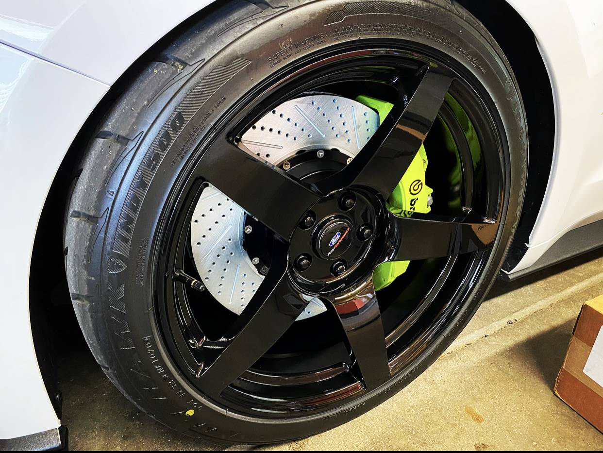

I just did the Baer rotors and I love em. I don’t track mine though so couldn’t tell ya there. And to keep the hats looking like new longer, I put a coat of Adam’s graphene ceramic on them. LOL, don’t judge.
I thought about putting CSL on my Steeda set, but figured it's just gonna get burned off fairly quickly. Interested in seeing how it holds up for you.
Adams ceramic technology to the extreme! Also are those SVE 355 wheels with FP center caps? If so do the caps snap in tightly or are they kinda a loose fit? My OEM Pony caps did not fit exactly snug
