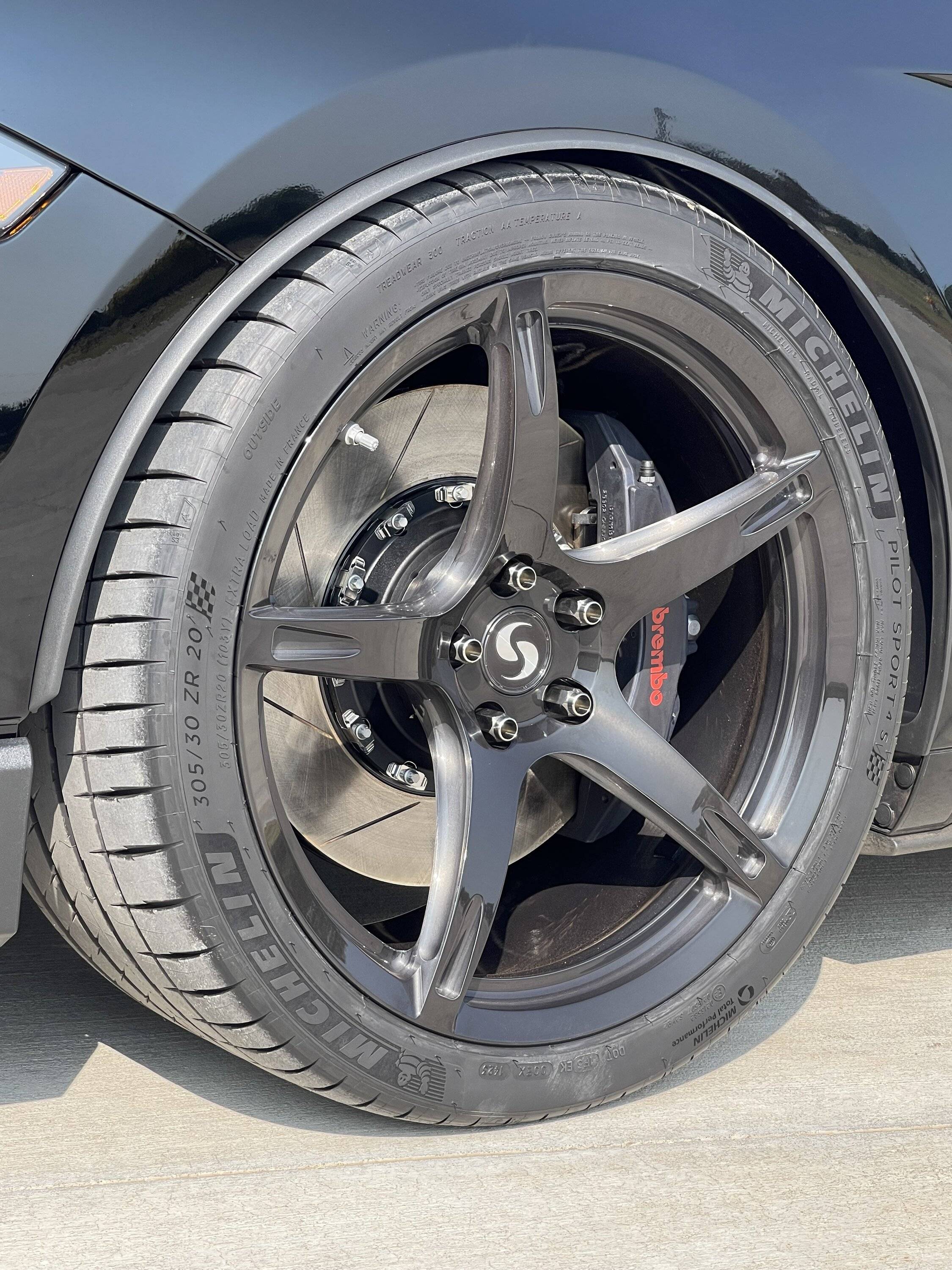

I have the Kenny Bell 2 piece rotors.
In conjunction with forged wheels, I definitely felt the difference in steering response, and for sure the car stops faster when shedding 14lbs off of each corner. (I had the birdnest HP wheel before, which are heavy as shit) Reducing rotational unsprung mass does make a difference.

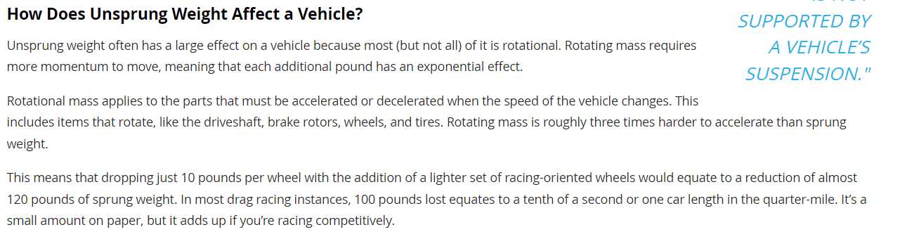

A ChatGPT level of understanding concerning unsprung mass and it's effect on the car isn't really what you need to make an informed decision.
It takes a certain amount of brake disc mass to be able to turn a large amount of kinetic energy into heat. The outer ring of the disc will always be iron and it will always be heavy. The portion of the disc which provides the weight savings is the bell. Changing that part to aluminum will save you about 7# per corner. This reduction in unsprung mass will help the tire follow the road a fraction better. The brake bell is concentrated to the center of the disc, so the reduction in rotational inertia will help the car accelerate just a fraction faster, but it is tiny...I mean absolutely next to nothing.
If you're racing, and lap time actually counts, then lighter discs might get you 0.01 or 0.02 seconds around a full-sized track and you'll be happy to do it. For track days, it's silly. The honest truth is you could go from stock cast iron to carbon and probably not be see it on a watch. You'd probably feel that something was different in the steering, but it's going to be difficult to turn that into actual lap time around the track.
