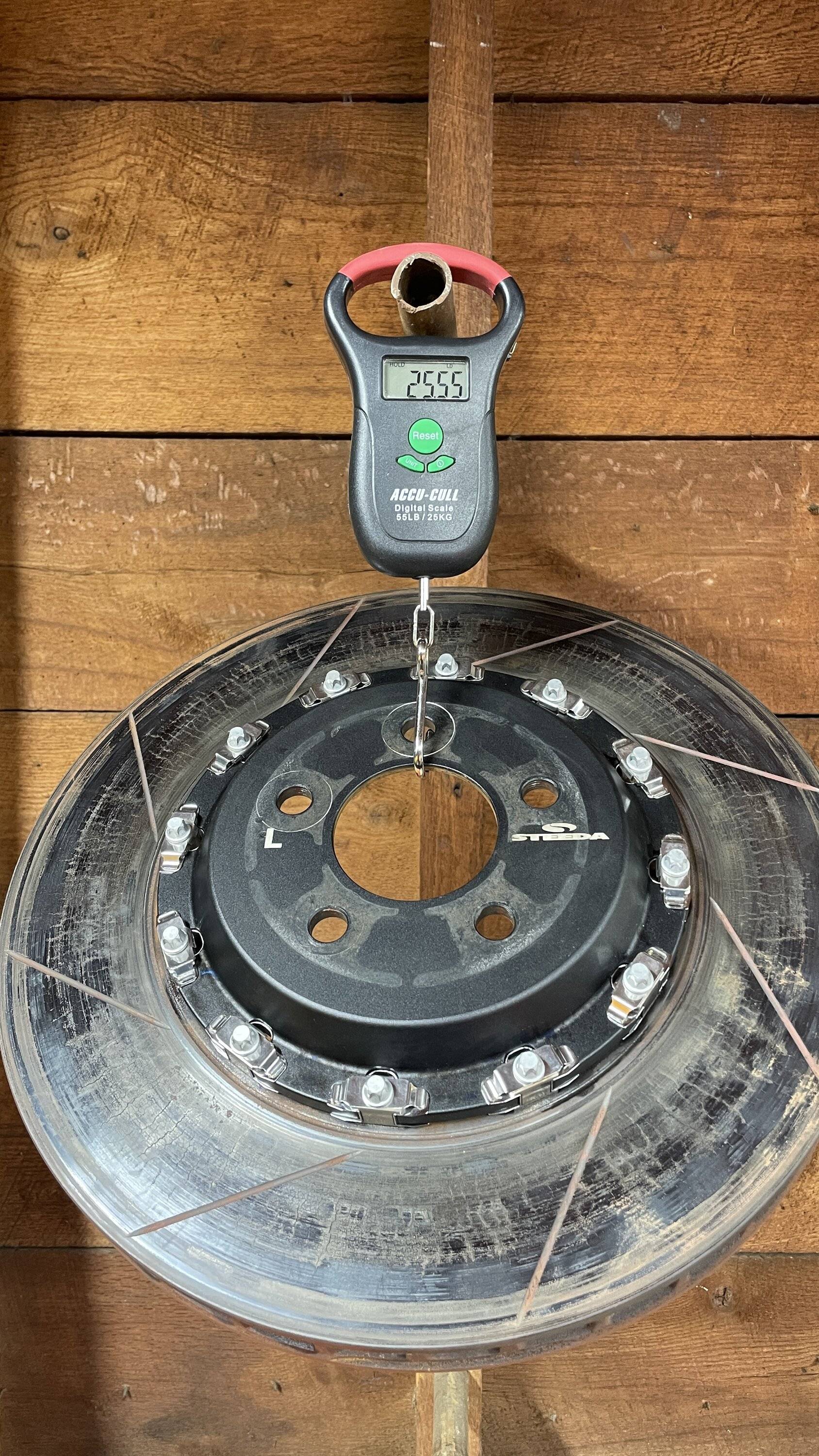

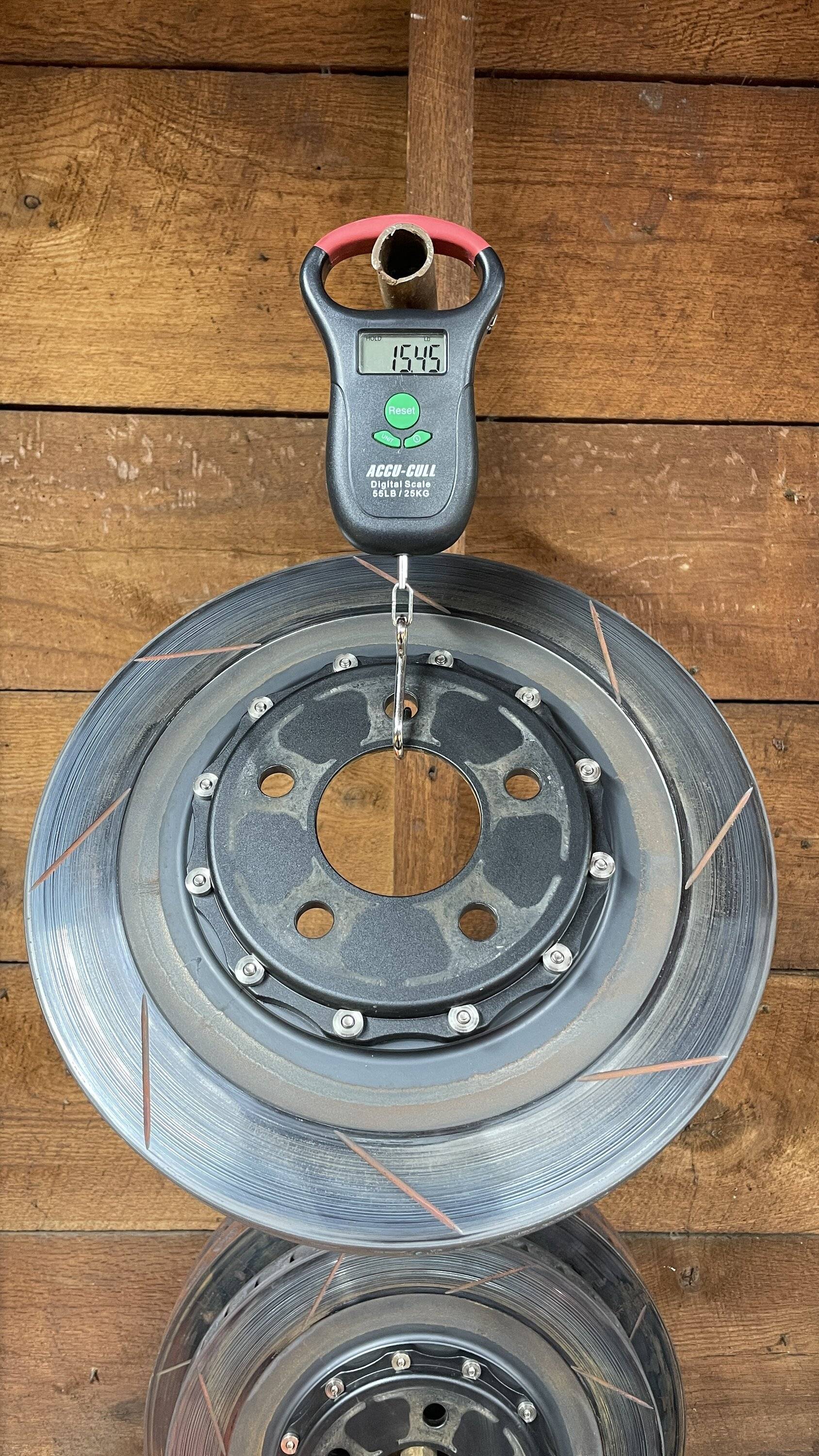

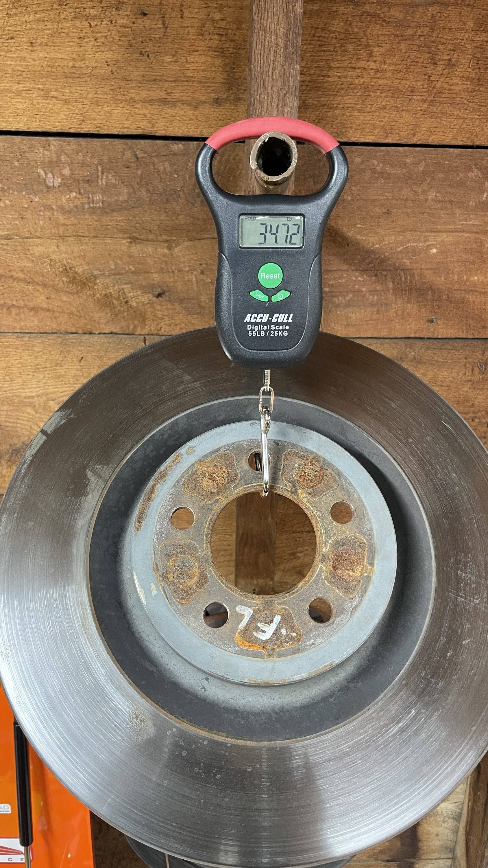

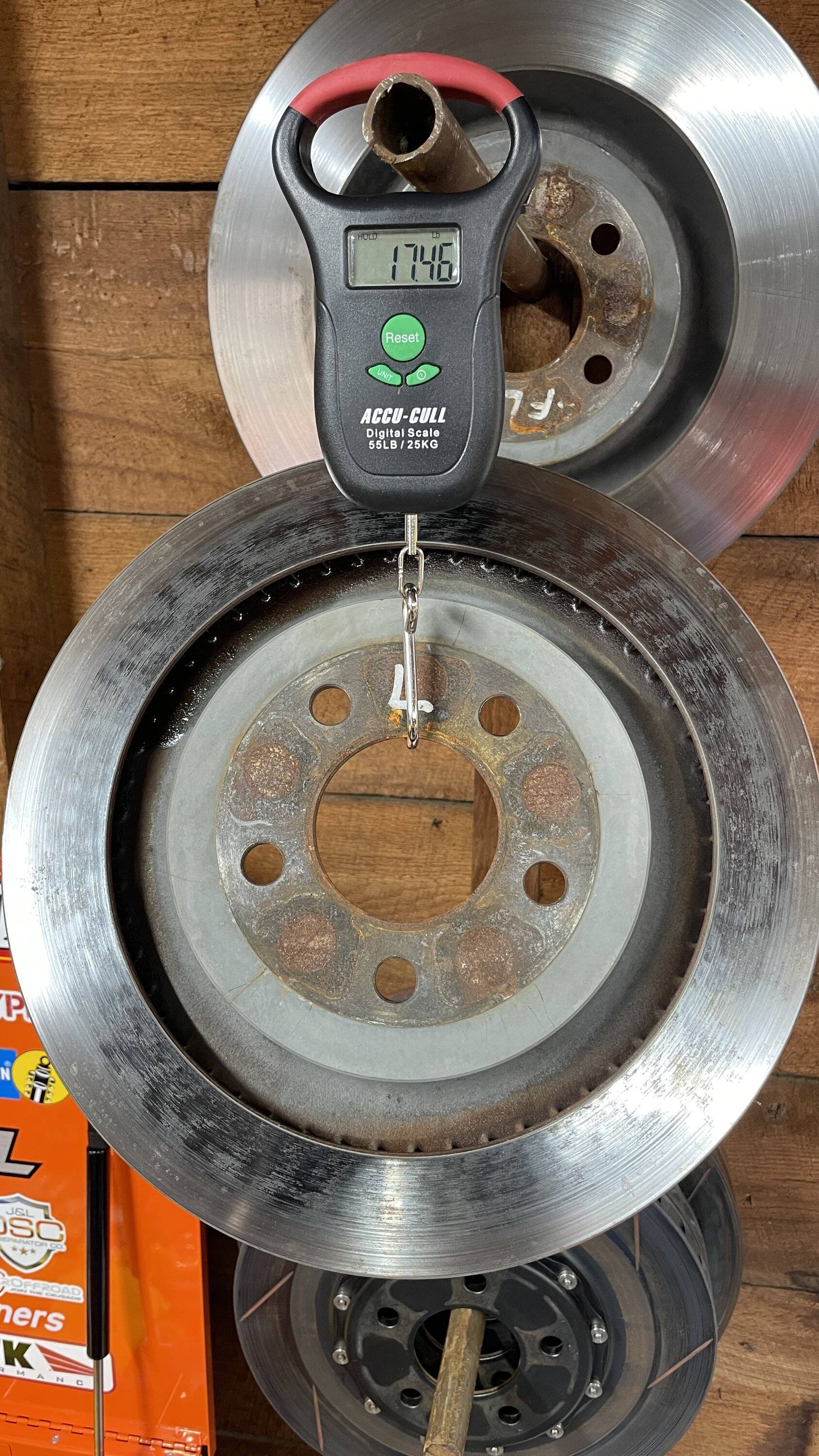

Steeda work good and save weight. Great for a street and light track use. I'll be listing a set that just came off my Mach 1. Im going with AP Racing for more aggressive track use. Ive included stock mach 1 vs steeda weights. -18lbs off the front axle -4lbs off the rear axle
