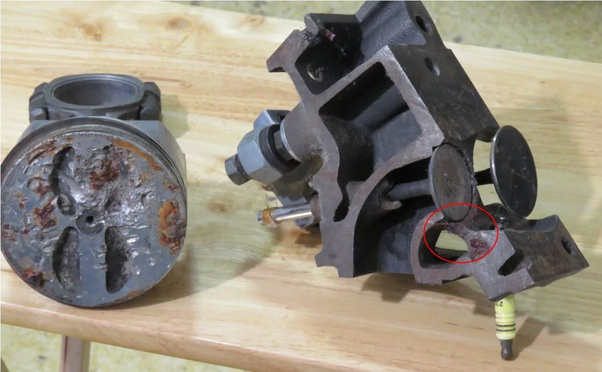

valve float can happen when the valve springs cannot keep up with high rpm's and will cause the valve to make contact with the piston and if you're lucky you'll just have a bent valve stem and/or rod and lose compression. worst case scenario if your valve breaks off then a catastrophic chain reaction of damage occurs from broken head, piston, cylinder walls, crankshaft, ect basically grenading your engine.
That's no joke. I've dropped a valve before, turned that long block into scrap iron...
Norm Peterson
corner barstool sitter
Jul 22, 2013
8,852
4,652
Norm
'08 GT #85, '19 WRX
Yup.
The exhaust valve that used to live in that cylinder was reduced to a bent stick, and was probably the cause of the missing bits of cylinder head around the valve stem that is shown there. The red oval shows where what used to be metal, suddenly became an unwanted branch to a coolant passage.
The next time he-who-shall-remain-nameless got to borrow the same car again, with its new and further improved engine, he wasn't informed about any hard rev limit or that it had been temporarily reset to 4700 rpm . . .
