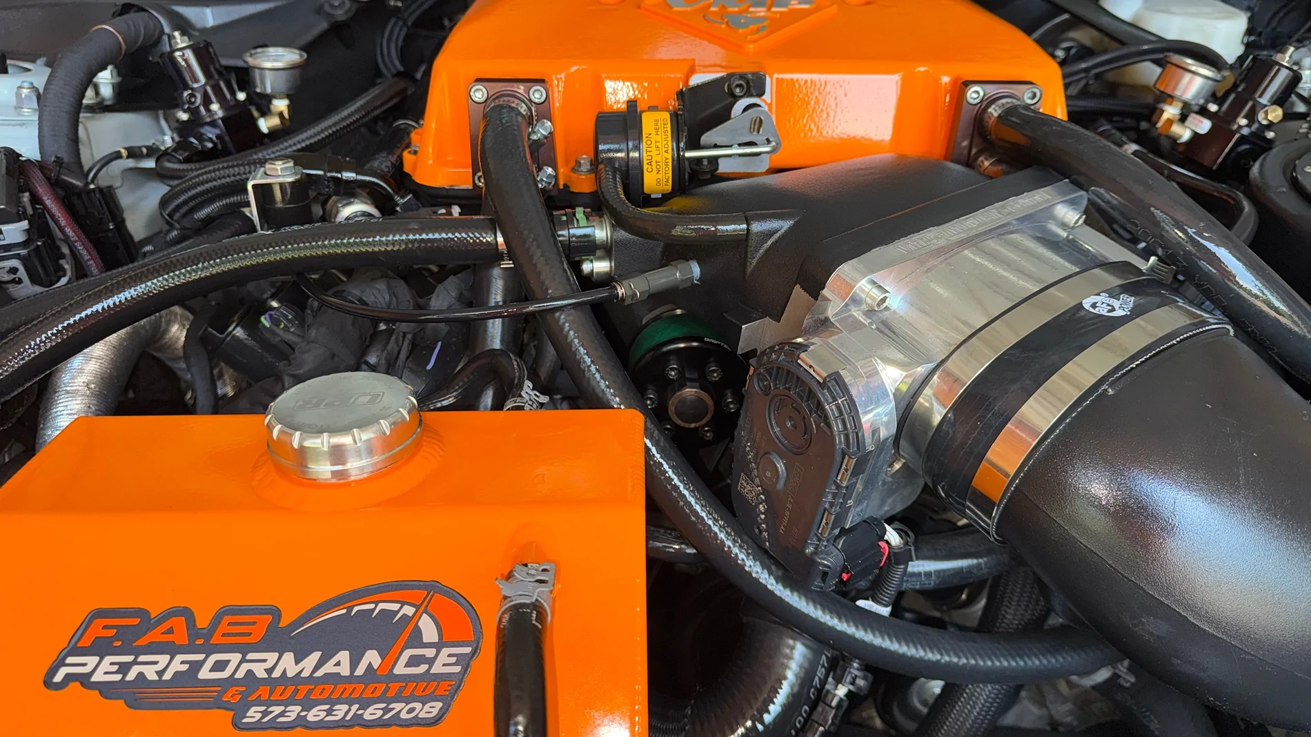

Mach1Racer
Oct 10, 2022
345
556
Everywhere
Mach 1

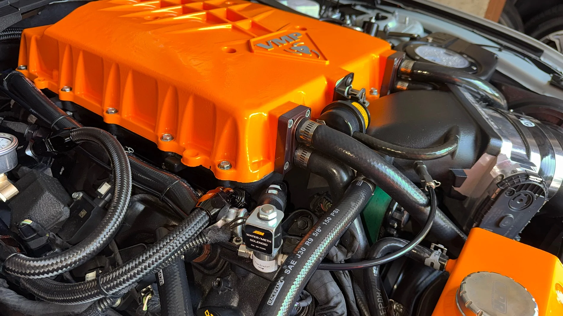

Working fine over here. However, there are good questions about distribution.
I like meth on my GM cars so, I put it on this one. Car is tuned on E85 without Meth and it was added after the tune, data logged for no problems.
The pill is small enough to not cause a huge difference to the O2 sensors. It is just enough to promote cooling.

@Mach1Racer youre running e85 + meth?
I run Pump 93, pump E-85, VP X85, VP C85.
Depends on what pulley I’m running as I change my power/boost based on what doing with the car.
ID 1300’s, dual regulator, twin pumps…
Why you ask? Not to be funny but I know I’m not about to teach you anything. Just being honest.

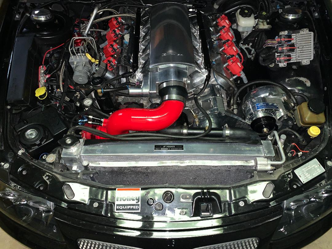

My 447 c.i. (7.3 liters) LSX F1A94 GTO was 93 and twin 1000cc Meth injected.
1000rwhp on a T-56 man.

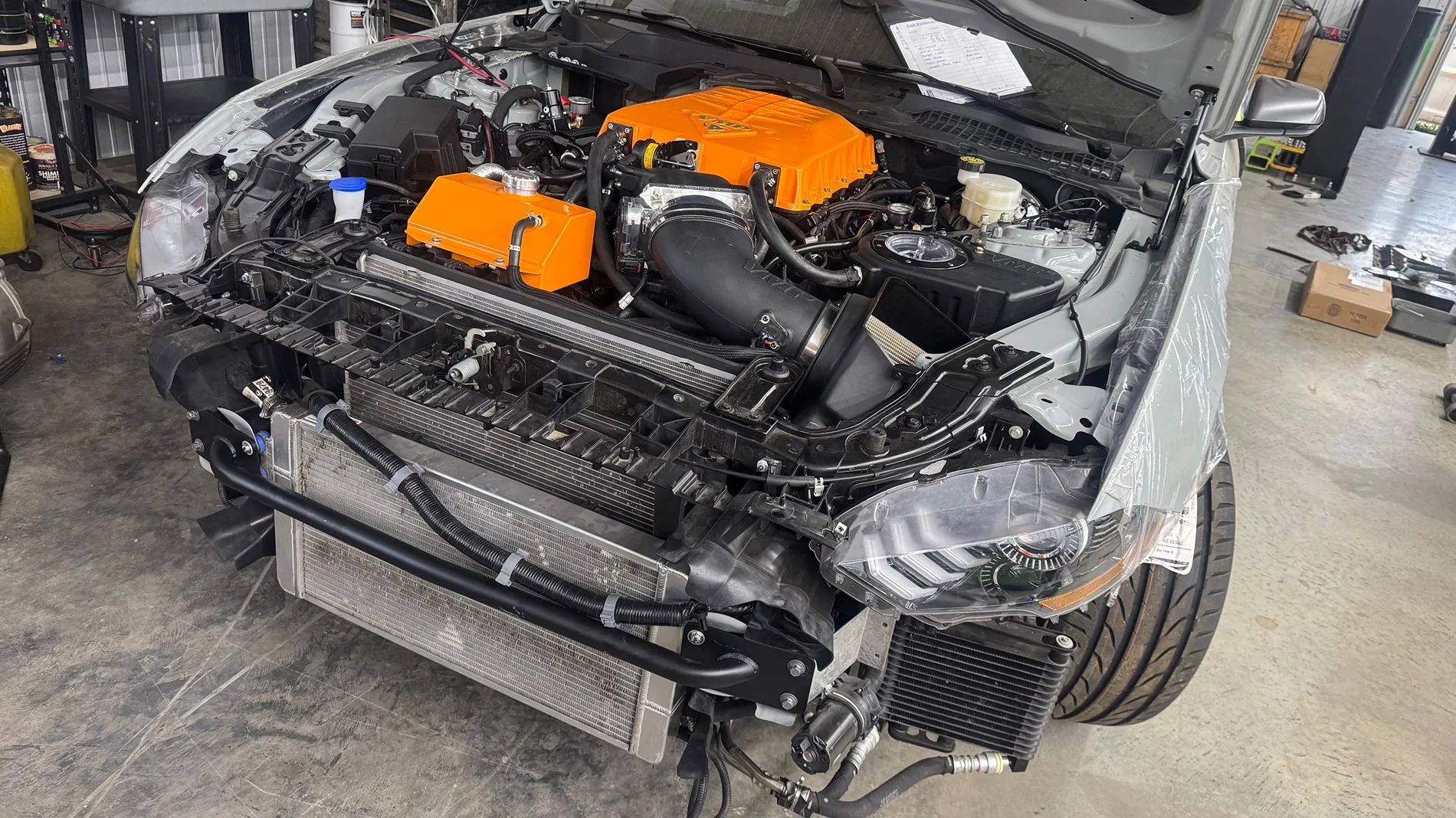

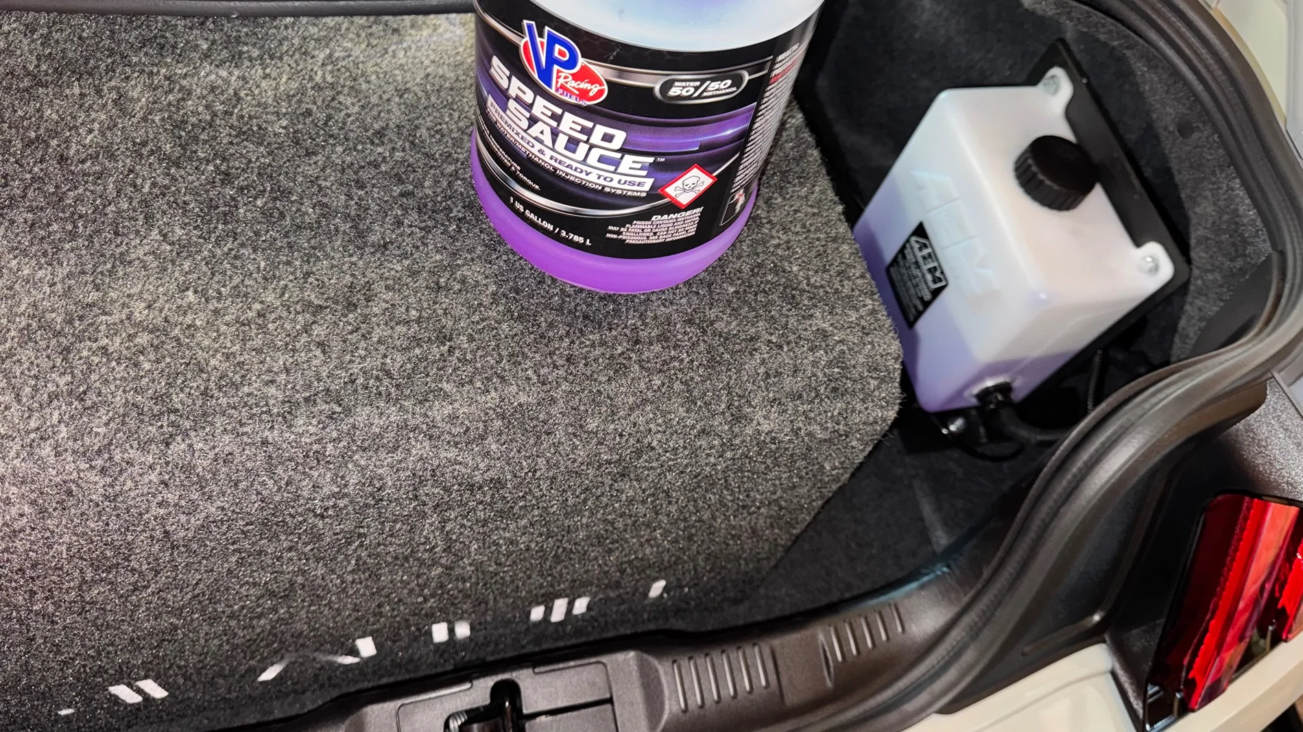

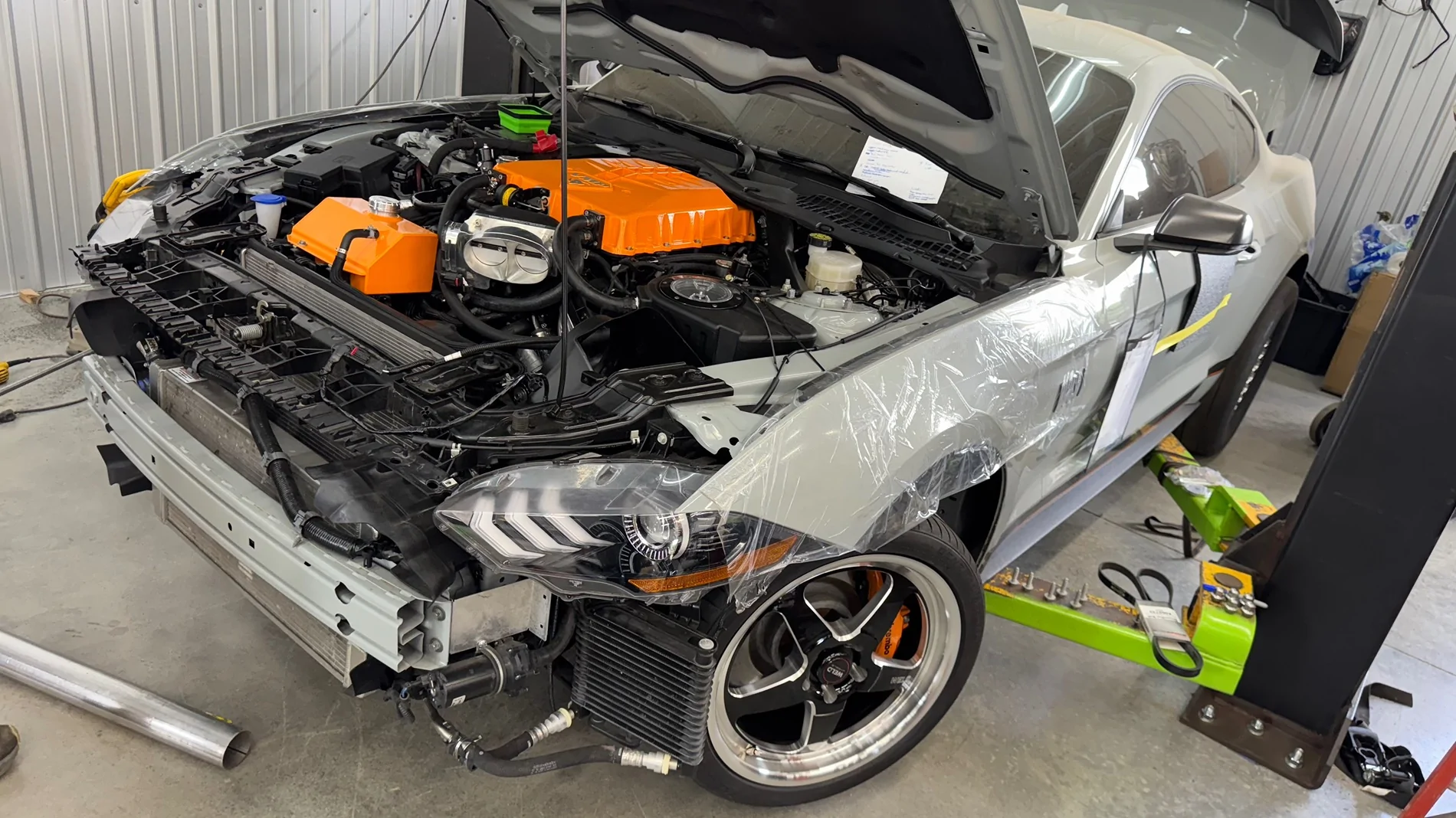

Mach1Racer
Oct 10, 2022
345
556
Everywhere
Mach 1
From the wording it looked like you were running e85+meth, which would be totally unnecessary to achieve peak performance so I was wondering.
Awesome GTO! IMO that and the GXP were some of the best all around performance cars ever made!
I am in fact using the Meth kit at all times. The AEM kit is on a map sensor which I have starting at 6 psi sloping to full at 12psi.
It does help with heat soak on back to black runs when doing roll racing. Usually, they want a minimum of two or three to break a tie.
Therefore, I am constantly doing 3 to 9 runs on the highway against multiple cars from 40mph to 140 or 60 to 160.
The first car to heat soak on a door to door race is the first car to lose. I have employed every method I’m most familiar with.
1. VMP Ice Tank
2. Removed the crash bar for a Steeda Race Front Bumper Bar which saves 10 lb and doesn’t block the Triple Pass Heat exchanger.
3. Methanol injection after the T/B
The car runs consistently and beats some TT cars as well as other SC cars. It is respected for what it is.
Even the 10-sp has been built and flows more Trans fluid and earlier. The trans stays around 130-160 after multiple hits.
Back to the Meth, is it required; NO.
Does it help me the way I’m using it? Yes
It provides extra cooling under boost as well as octane when I’m running pump E-85. In the winter, the E-85 was testing on my Fuel It Ethanol Bluetooth sensor at 71-74% which lowers the octane of the E-85. The Meth cover that as well.
Do everyone need it. No. I want it and use it daily as my lead foot will not give the car a rest.
As for as a GTO, I think I might go back a get another one. I miss that car. Once you beat a auto car with a stick from a dig, there is no re-runs and you aint got shit to say.
