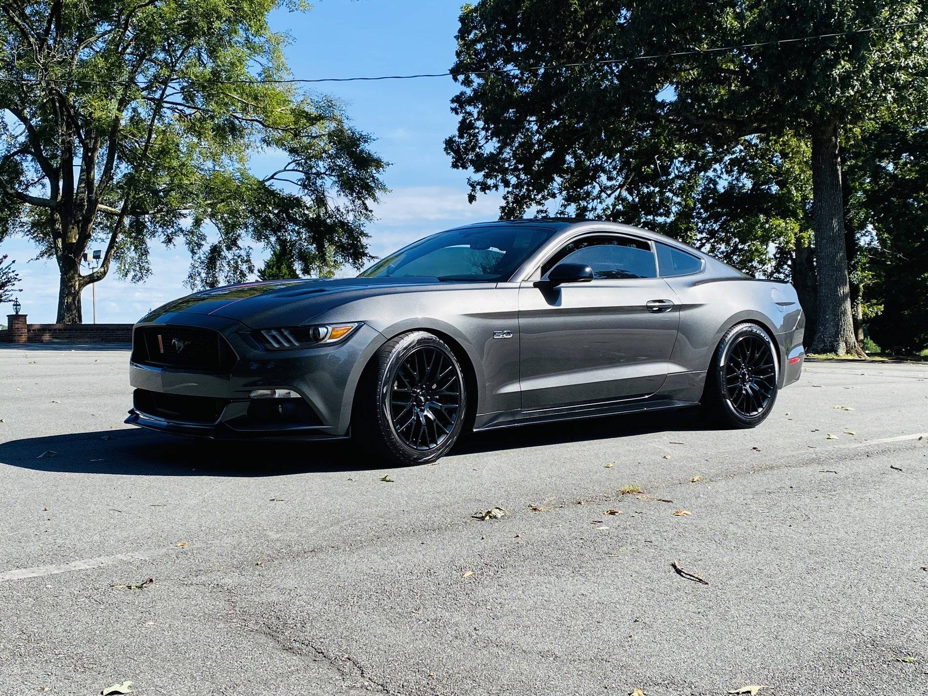

I had 19x9.0 45 offset wheels on 255/40/19 and I put 20mm all around. (25 offset including spacers)
the fronts sank in just a hair more than rear. so I assume that would work for you.
heres some photos of mine with 20mm all around.

oh I misread it, I thought he meant he wanted larger in front, and rear smaller. that would make it squared.
my car being 20mm all around, it looked staggered, but yes. I think 23-25mm in rear would definitely set it off. but too far and it may poke past fenders.
mine 20mm all around, the rear still visually looked further out, I assume the axle is naturally out further than fronts.
