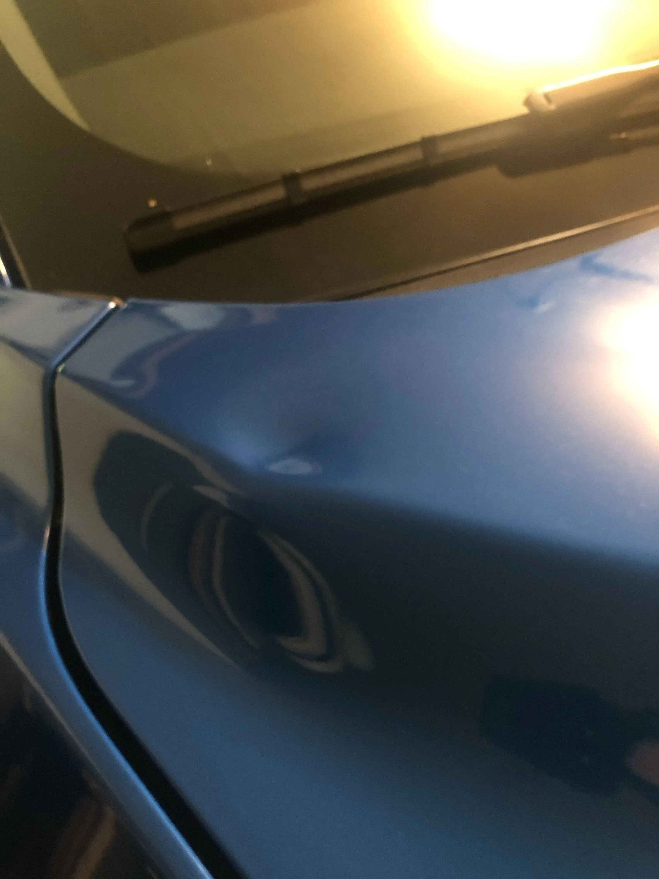

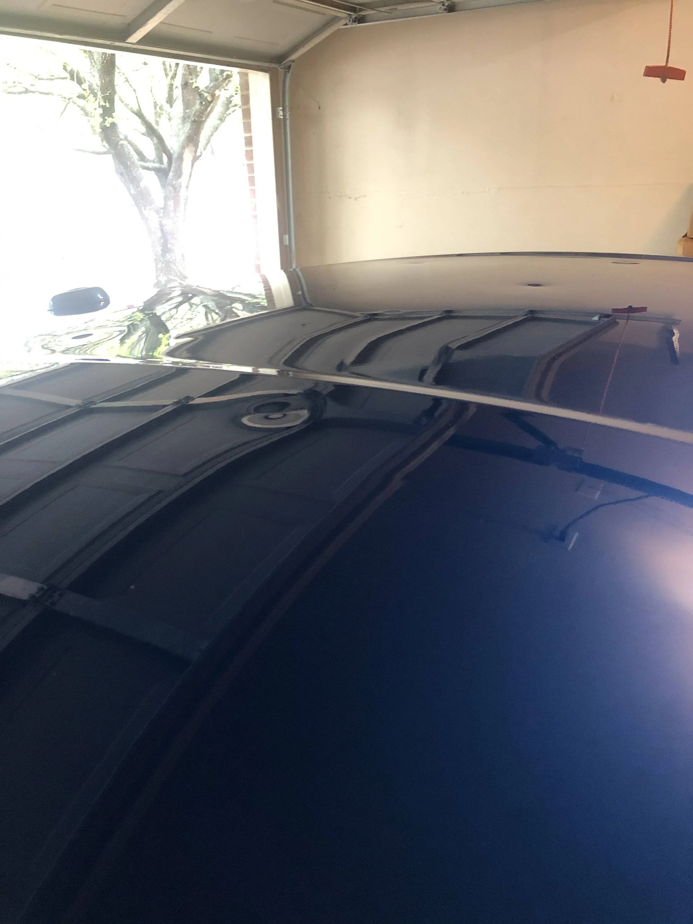

Minor update- Put in my claim today and I am covered and they are making arrangements at one of their approved centers that specializes in hail damage to look at the car and do the repairs there so hopefully it moves fairly quickly especially if it can all be done via PDR.
Just waiting on the call to bring the car into them. The car doesn't look too bad considering but if I had not got it under that roof I shudder to think how it may have looked. I imagine like Bonnie & Clyde's car at the end! :)
