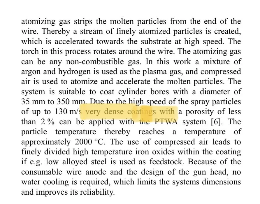

I read up on PTWA and still have yet to determine what’s the actual material. PTWA is just the application process. My assumption was that it’s hard like nikasil or chrome but it could actually just be iron. Anyone have anything definitive on this?

the ptwa cylinders are extremely hard
The coating is very hard, the substrate is still aluminum.
Like Hardcoat Anodizing, the term Eggshell hard isn't a new term in the industry.

Is it settled, Ford PTWA deposited spray is a VN-Cu matrix ?
