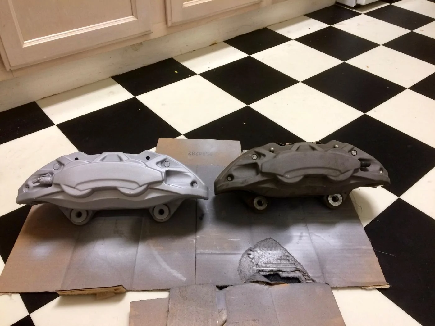

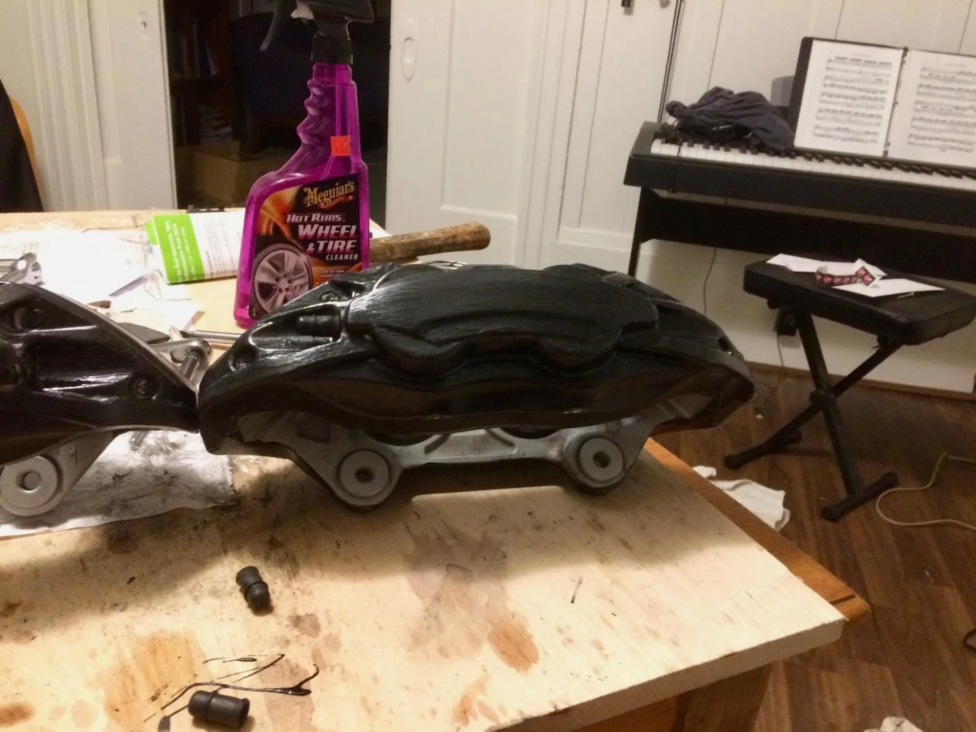

Well...I am receiving my brake caliper paint kit tomorrow. So tonight, I prepared one brake caliper for paint. Here is a side by side comparison between an unprepared caliper and a prepared caliper. 3 hours of wire brush...sanding with 60, then 100, then 150 grit sandpaper. Then 2 coats of VHT exhaust manifold paint as a substitute for primer. Then color sand with 600 grit to smooth finish and key the surface for paint tomorrow.
I hope this will all be worth it.
Tomorrow I will take more photos of the actual process if people are interested.

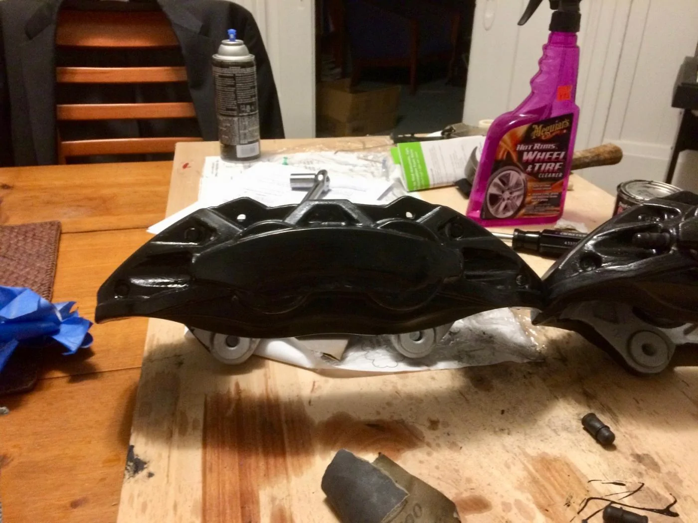

And now the calipers are painted.
Just need to color sand tomorrow then apply a clear coat (not sure if I want to do a decal or not). As an aside, the caliper in the bottom photo looks just as good as the one in the top. The lighting is what makes it look bad.
