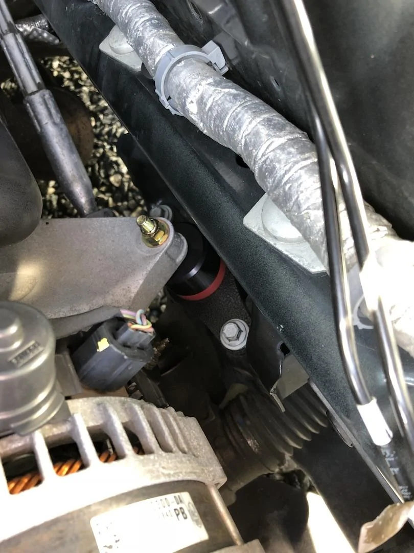

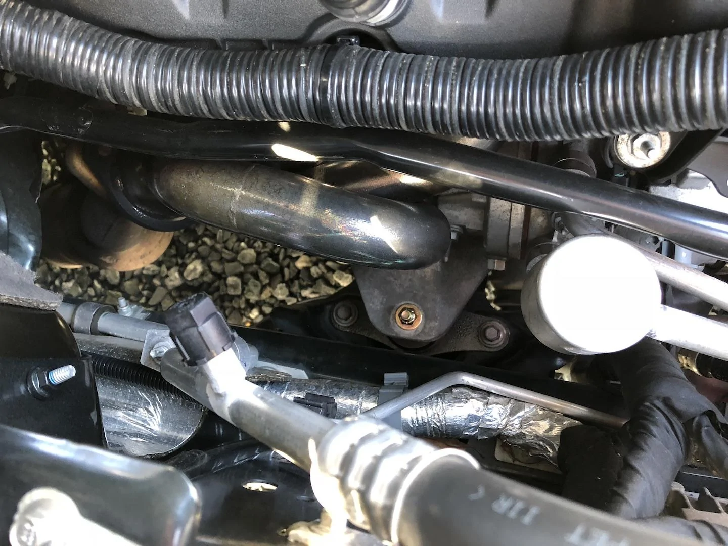

BMR Motor Mounts installed! Install was pretty painless due to the fact that the V6 has a decent amount of room in the engine bay. I was able to complete most of the install from above without issue. The passenger side was the only real tight fit but still easy when you consider what was being installed. I went with the full .5" drop that BMR allows and am happy to report that everything clears without issue. Drive line angle seems to have dropped about a degree from stock.
As for my impressions, they are a bit mixed right now... NVH is certainly increased... During normal driving the increase is hardly noticeable which is something I like. With that said, low RPM high load situations really bring out the vibrations... Over time I will get used to it but I do feel it is alittle excessive in this area. All in all though the handling increase is more then worth it! This car again feels much more planted and composed then it was before the install and I do feel a slight power increase due to less drivetrain loss. To top it all off, These mounts drop about 5-10lbs from the nose do to just how much smaller they are compared to stock.
So would I recommend this? For someone that is not so sensitive to NVH most certainly yes! For those that are sensitive to vibrations, think long and hard about exactly what you want to get out of these mounts and if it is worth it to you.

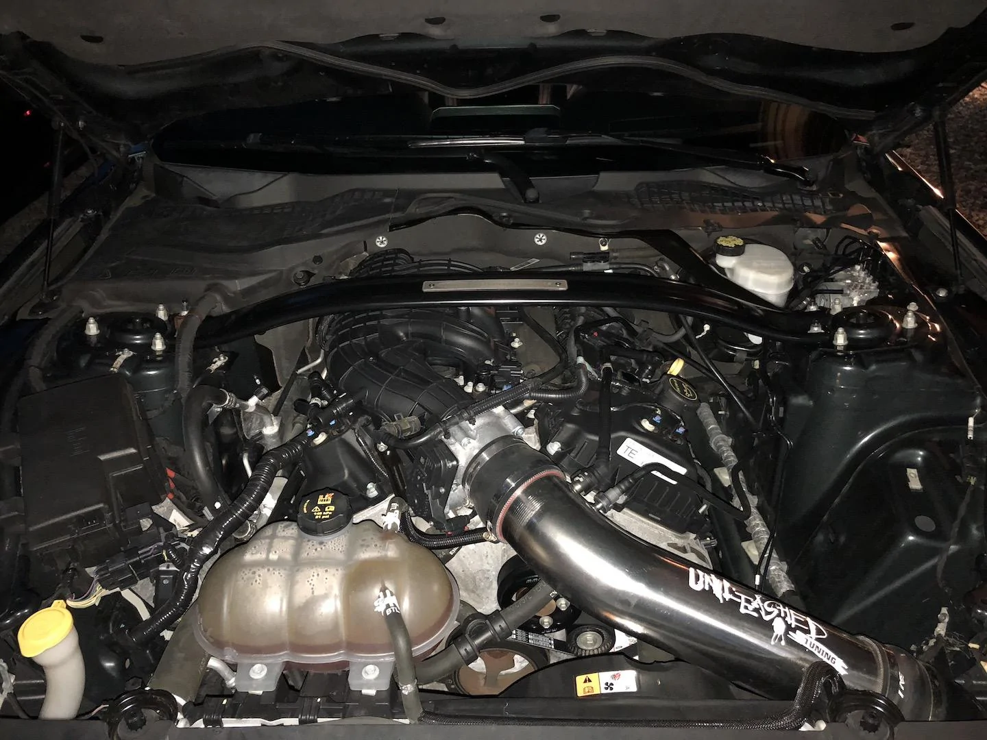

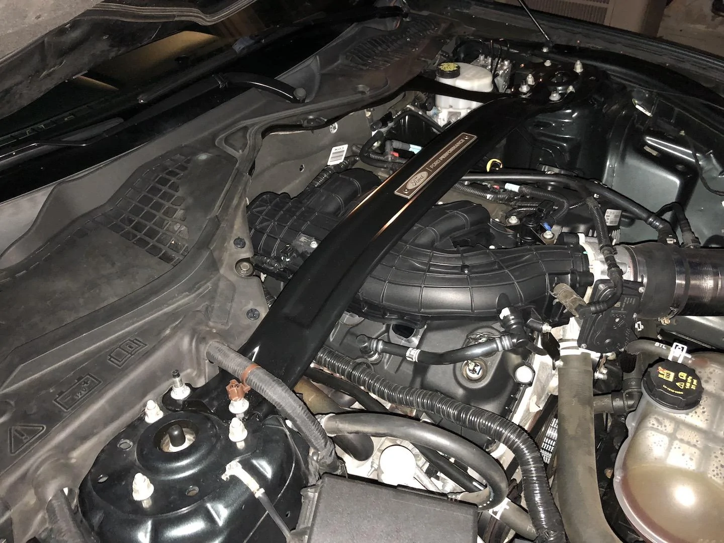

Strut Tower Brace installed and MPT tune upgraded to 93PRX!
Also an update on the BMR motor mounts. I have mostly got used to the added NVH but I still think it is excessive in a few areas. BMR I believe uses 95D polyurethane which is literally a step below hard plastic so I am going to try and make new bushings using a softer 60A polyurethane and see if I can't absorb some of the NVH. A softer bushing should allow for this while still keeping the lower CG with controlled engine movement.
dguzzi
Sep 4, 2017
308
50
Michigan
'16 V6 w/051A Met. Guard w/foundry wheels
Doesn't really look like it needed to be lowered? More important; does it feel different to drive? Or is it mostly bling factor, my car is pretty stiff in corners. (so far) Not poking fun, I'm really curious about it...
zackmd1
zackmd1
Oct 1, 2013
139
5,234
3,266
Maryland
Zack
1970 Mustang, 1965 AC Cobra, 2023 Ford Bronco 2Dr
It did need to be lowered. I have less then a half inch of clearance when the motor was lowered a half inch from stock.
It terms of how it feels, I wouldn’t say it feels stiffer but it does feel more controlled. I can be in a turn and hit a bump and never have to correct or even slightly move the wheel where as I needed to before. It just gives the sense that the steering wheel is directly connected to the wheels where as before there was a slight disconnect.
I will say though that I drove it with just the K brace installed and with both and I really couldn’t tell the difference. So you could just go with the K brace I think and not have to worry about interference issues with the strut tower brace.
Mine will remain on until I decide what FI option I am going with. If I move forward with my Eaton M90 plans then I will have to remove it.

BMR motor mount experiment was a success! Replacing the hard 95A polyurethane for 60A polyurethane dramatically reduced vibration. 99.9% of the vibration caused by the motor mounts has been eliminated and what little remains is not intrusive at all. I would liken it to the vibration increase from installing an aggressive exhaust system. The only area that did not see any decrease in vibration was when the engine is idling. This vibration must be very low frequency that can only be eliminated with the oil filled OEM mounts.
[MENTION=9985]BMR Tech[/MENTION] I would highly suggest you look into 60A polyurethane bushings for your motor mount kits. It just significantly improves the driving experience without much loss in engine control.
