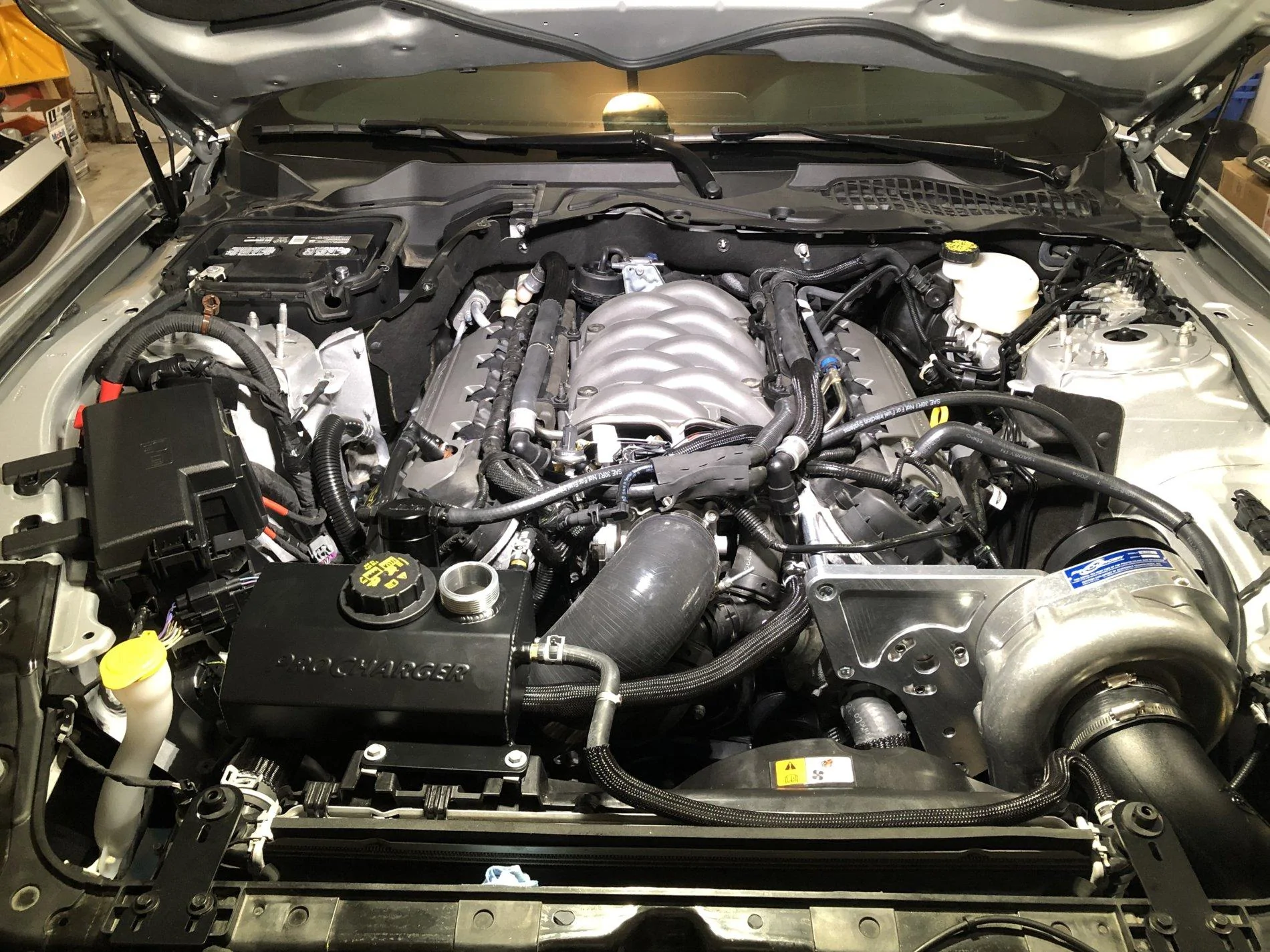

This is interesting...your blower bracket looks different than mine even though we’re both running the stage 2. Did the design change in the past 2 years?
I have never seen that before.... Maybe someone else can shed some light on that.
I assume it's a new tensioner design?
