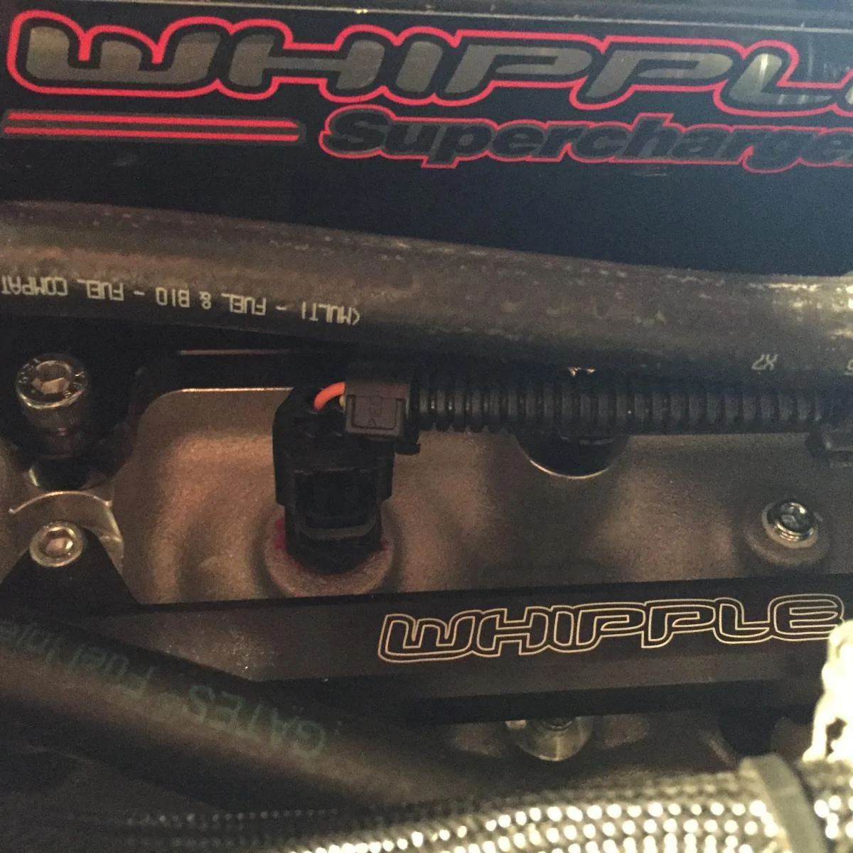

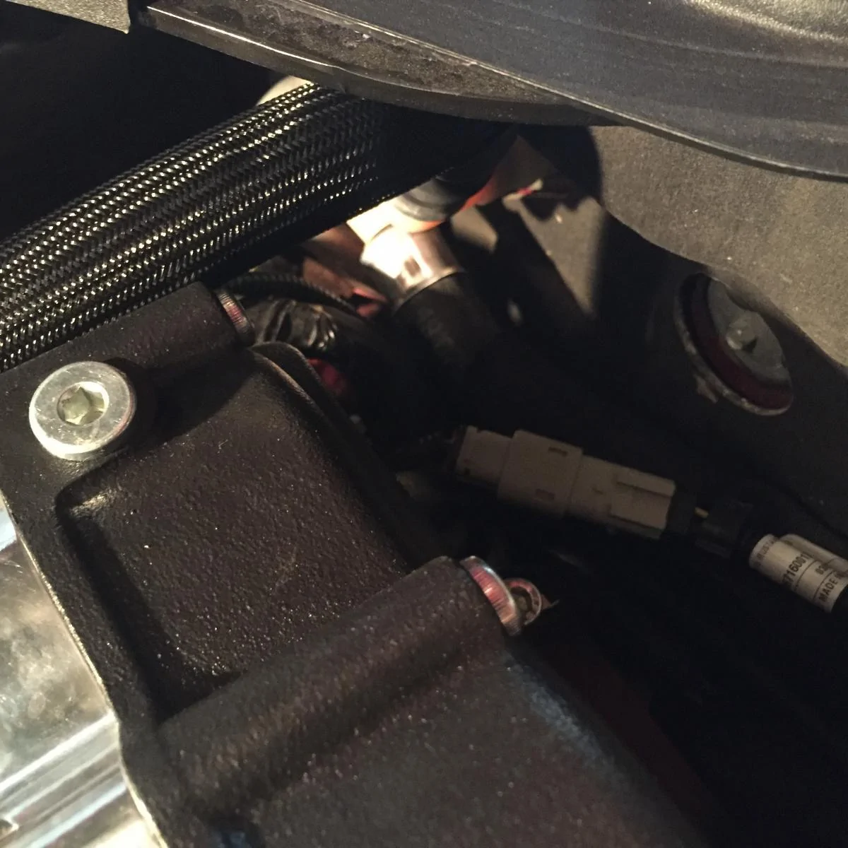

Disregard what i previously pointed out. Now that i think about it, its referring to sensor that was installed on the lower manifold on drivers side. The wire for it comes from the passenger side and i believe it ties into a connector previously used for imrc on passenger sie.
I uploaded two pictures to show the connector on the manifold and the connector it ties into behind the supercharger on the passenger side. Camera is orientated from the position of me leaning over driver side fender.

step 76 is when you plug it in behind the passenger side head...

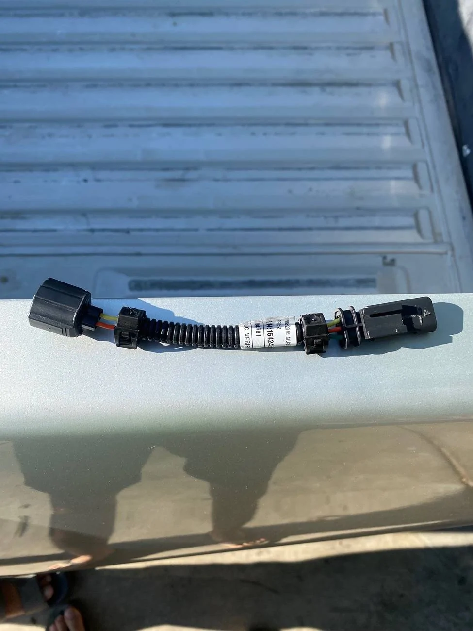

ACT= Air Charge Temperature.
Sensors are pre-installed on drivers side of intake manifold.
Step 76 or 77 depending on revision tells you:
Connect the supplied 3-way to 2-way air charge temperature pigtail at the rear of the passenger side cylinder head to the 3-way IMRC connector. Route to the driver side back of engine for later installation into the ACT sensor.
Step 120 or 121 depending on revision tells you:
Connect the previously installed ACT pigtail to the ACT sensor located on the driver side of intake manifold.
So all you do is connect the previously installed pigtail to the manifold air temp sensor, the only open sensor on the driver side, intake manifold.

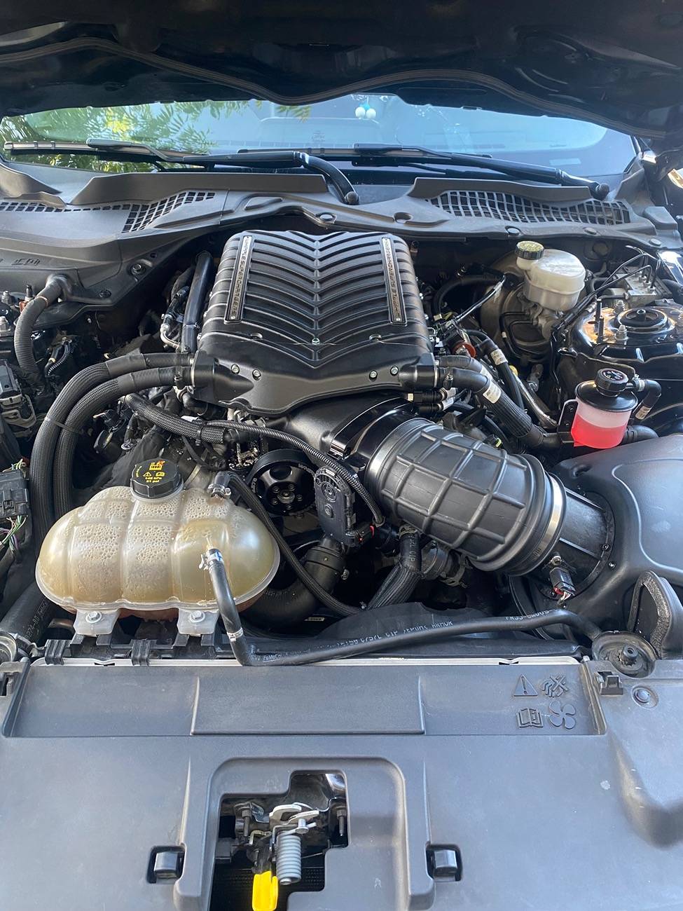

See the post from Whipple right above connected the 3
See the post from Whipple right above yours.
I still couldn’t get it I already connected the harness at the driver side but there is 2 more sensors remaining are they just hanging like that or supposed to be connected somewhere
HKusp
Jul 22, 2021
2,235
2,879
Hampton, Md.
Jason
2018 Mustang GT
This is connected to the driver side
If you are talking about the plugs on the back side of the block, that attached to the original intake for the IMRC's, then yes. You are supposed to tape them up really well. They are no longer needed.
