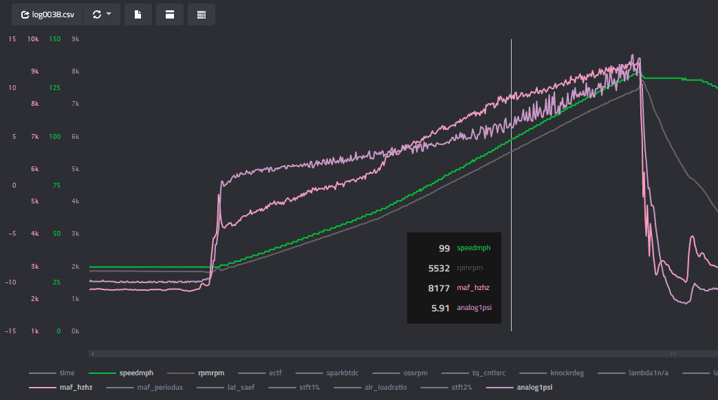

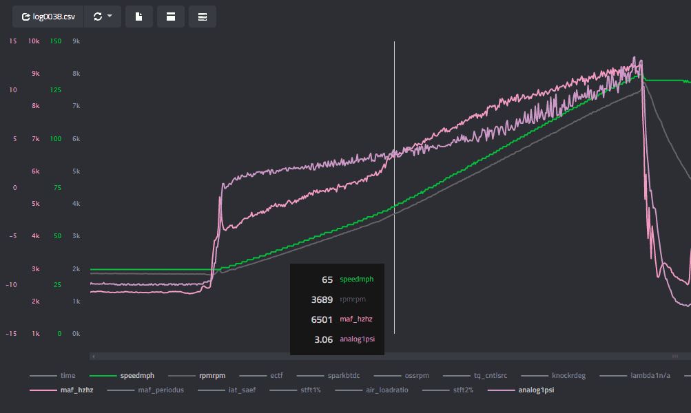

    Ok I’ll probably pick up a 4.25 and go from there for the remainder of this year. I see about 9psi MAX by 7k, and maybe 10 by 7200.

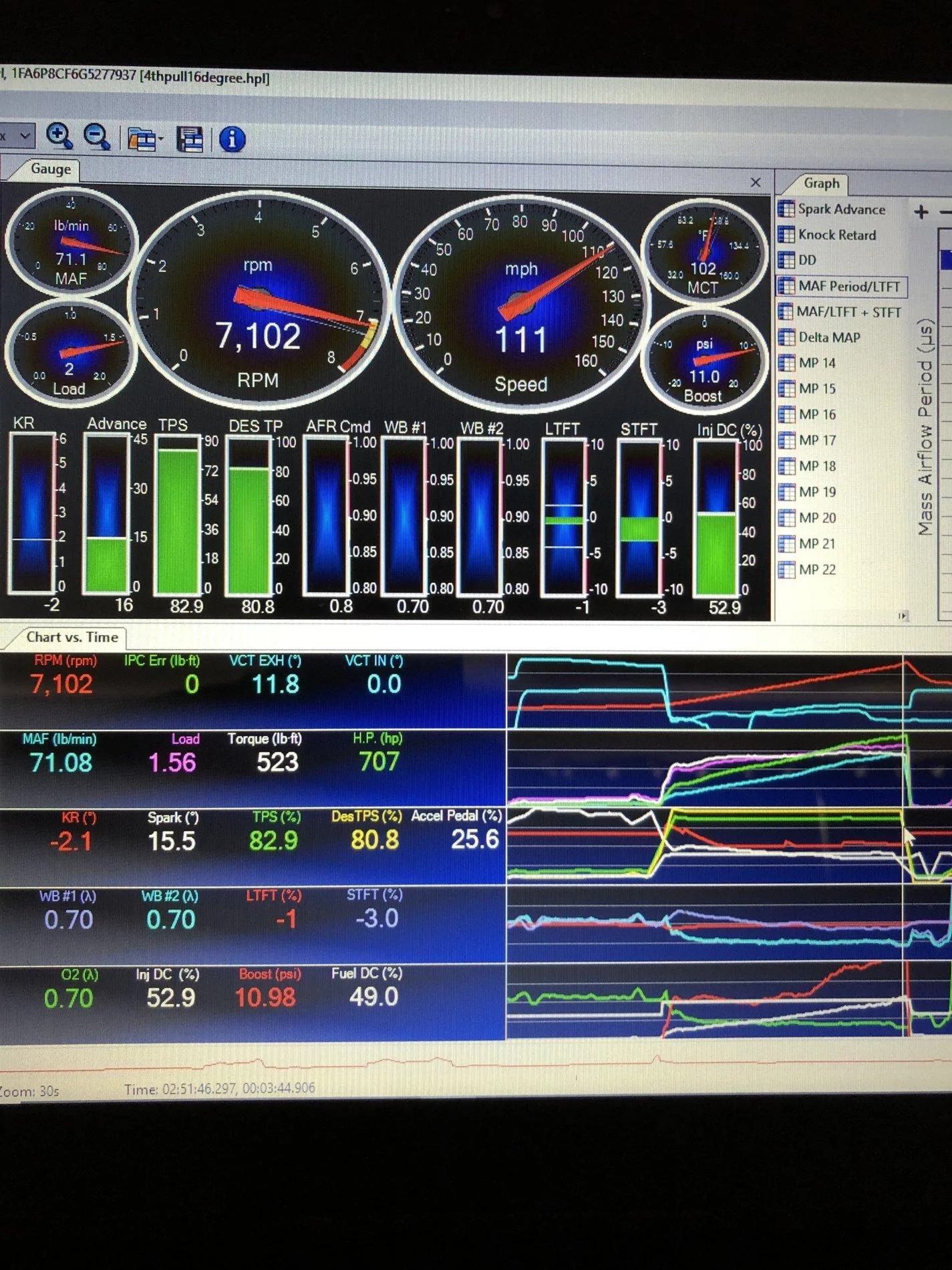

    Who knows, I'm not concerned with boost pressure. 4.25 is easily doable on your fuel system with pump gas. As others said before, get some logs and send to tuner.
