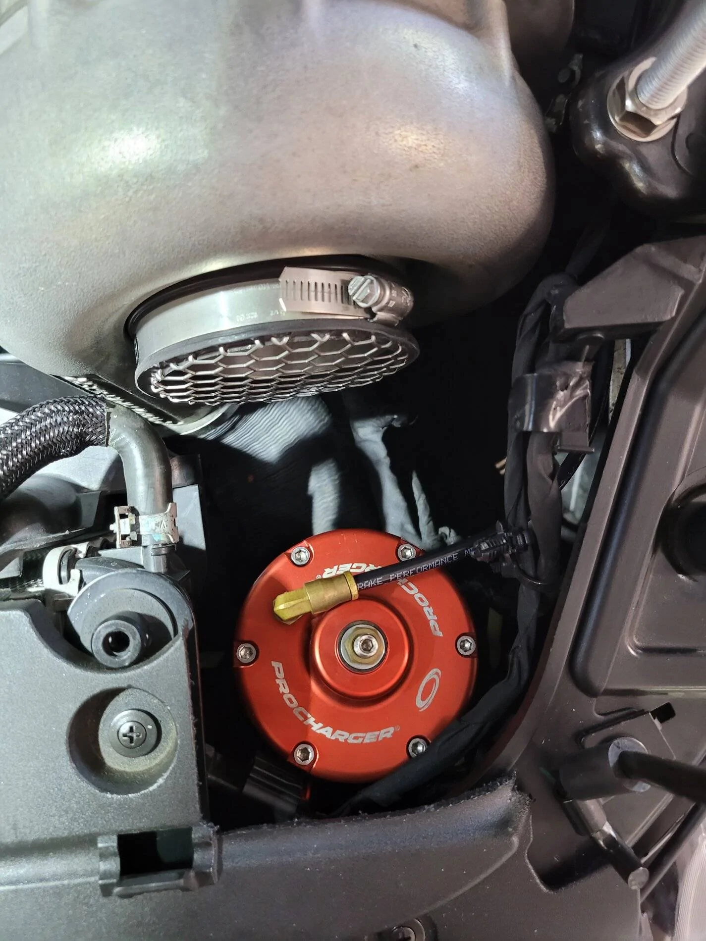

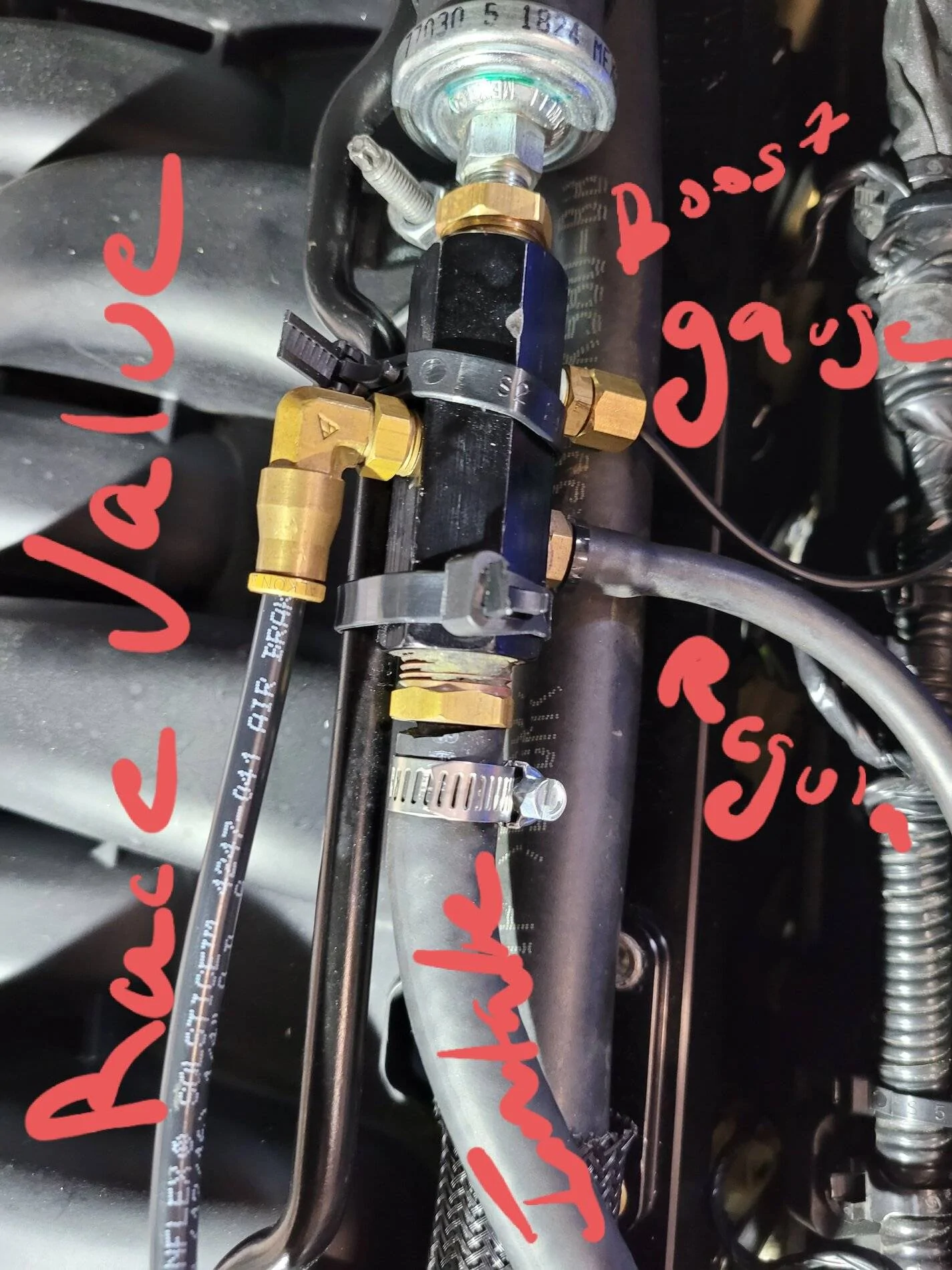

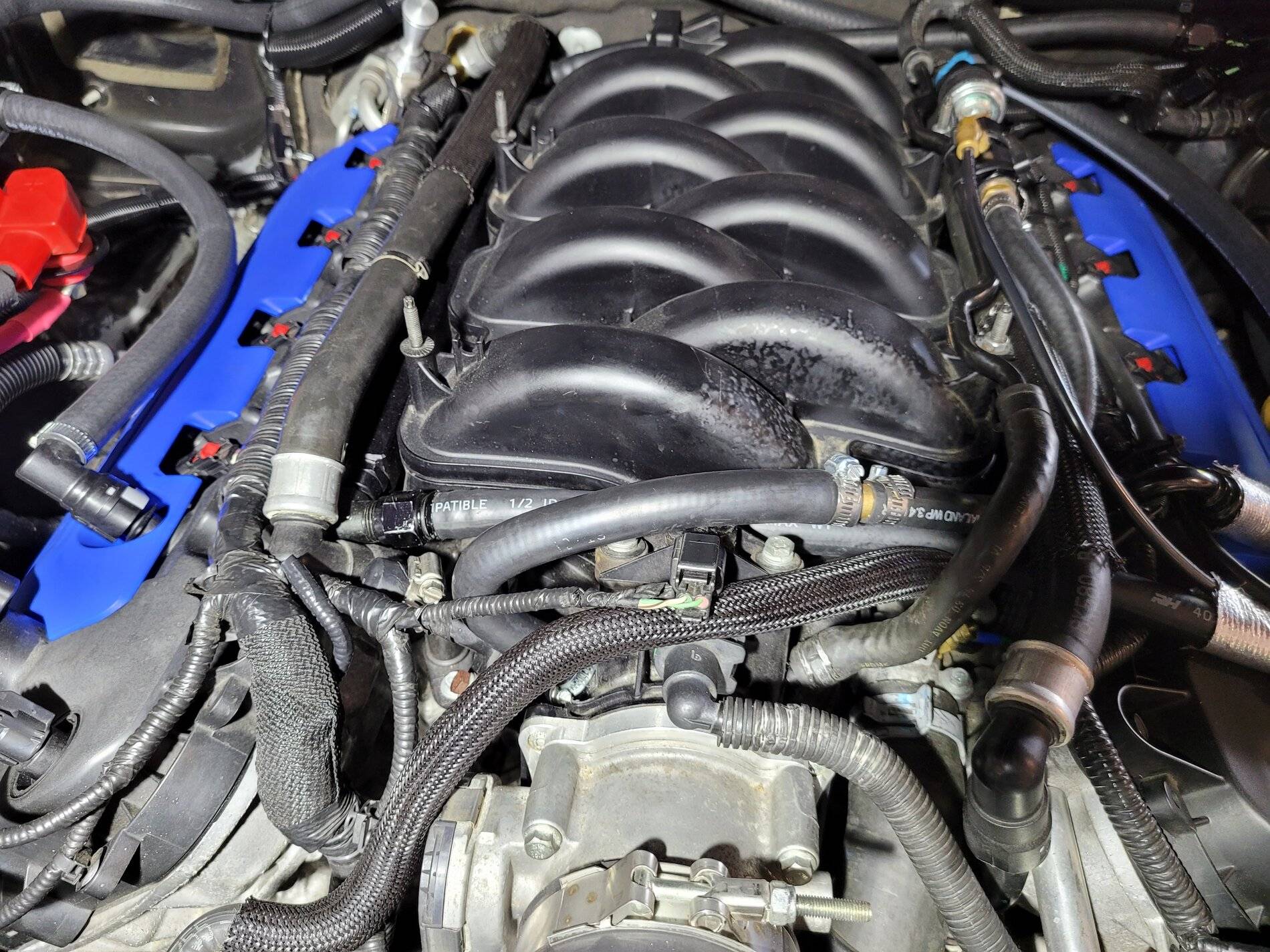

Took the car to the track tonight and it seems to not be making enough boost. Feels like the car is down on HP big time. One thing I noticed is that my red race valve is always blowing out air and doesn't shut no matter the rpm. As the rpm increases, so does the air flow coming out of the valve. It never shuts unless I unplug the air line in the top. The line going to my valve only has vacuum and never boost which I believe to be another issue. At 5000 RPM the car still has vacuum on the line going to the valve. I'm curious what the previous owner did with that setup. My setup comes right off the manifold on the passenger side and uses that for boost reference. I can share pics in the a.m. if anyone has any ideas.

You have to quickly stab the throttle to close the BOV, gradually raising RPM doesnt close it. If you pulled the line and it closed its working right, it saw atmospheric on the diaphragm and the spring pressure closed it. If manifold doesnt get to atmospheric or positive pressure then BOV will continue to blow.
If you have a leak in the line to the bov that would do it. If the line is plugged that will do it. Take the line off at the bov a check. If you have it connected to the wrong port that would do it. If the line is to small that can do it. If the boost from your procharger did not making it into your intake manifold that will do it. Like a coupler falling off. Pictures are worth 1000 words
