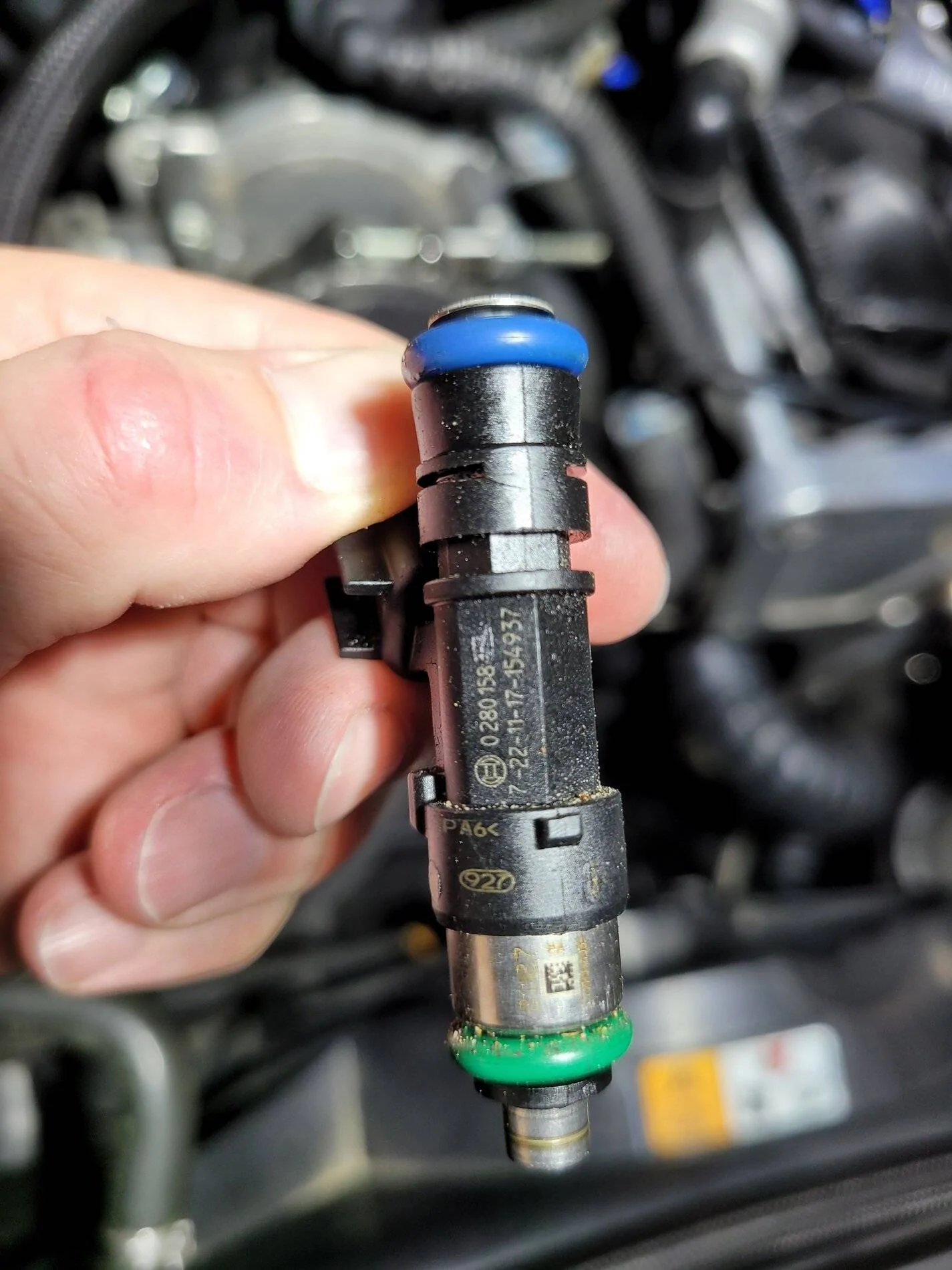

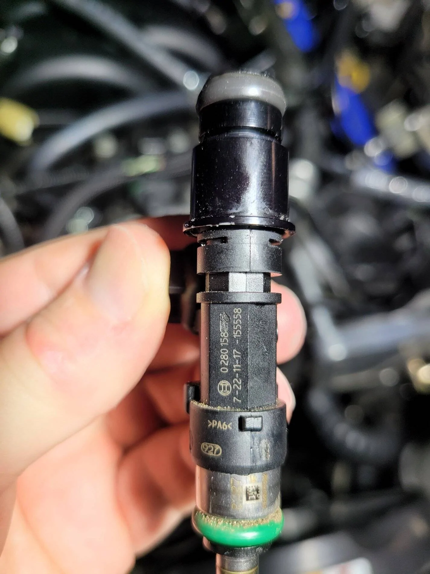

I ordered my ID1700s and will have them by Thursday. Here are the injectors I took out. They look like some stock bullshit to me. Anyone seen these before? I'll be Googling the part# but definitely not the ID 1000s.

Looks like these are 47lb Ford Performance injectors aka going in the trash. Pisses me off. Not sure how my car didn't grenade!!!! Maybe the E85 kept JUST cool enough
