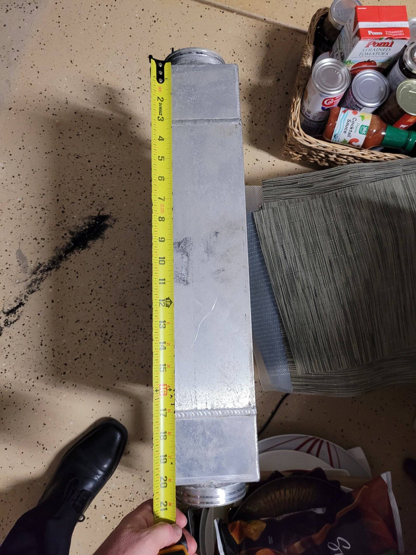

It has 3.5 inlets, I assume it's the stage 2. Don't mind the food next to the intercooler. I am remodeling my kitchen so all that shiz is in my garage. lol. I just checked the log and it actually reached 194 crossing the line.

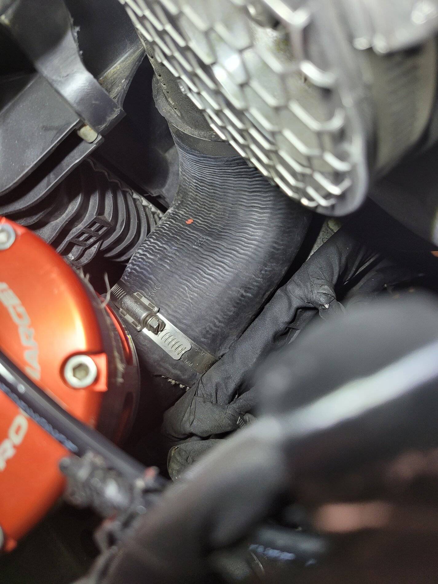

Im almost 100% sure it's the hot side plumbing. The outlet hose makes a sharp 90 and is definitely flow restricted. The guy I bought it from put the race value right at the exit of the blower. The rubber was literally melted inside, so I assume that's the issue.

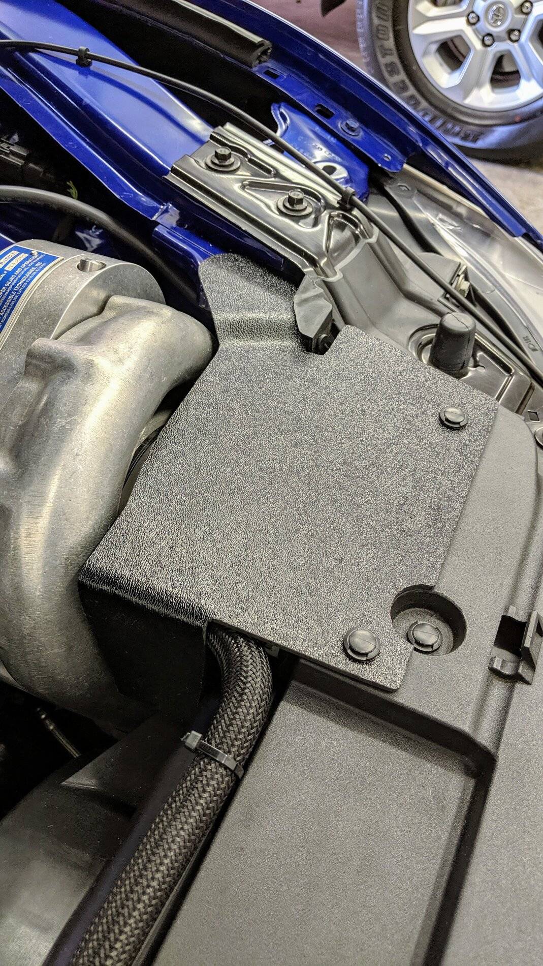

100deg gain over ambient can be seen on that setup when turned up. This is of course over the duration of the pass. 75deg ambient and 175 across the stripe. A few things can reduce iat temps such as increased airflow thru IC, bring cooler air into blower inlet and eliminating or increase the diameter of the blower outlet tube. You are pulling in alot of hot air from the bay with open blower. Fab up a heat shield like i did a few years ago. That will help.
