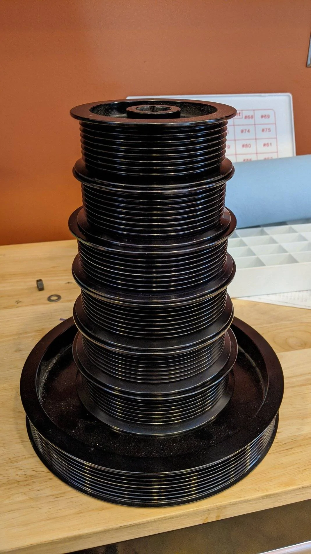

Congrats on purchase. I’d start with fresh plugs, fluids, o2s and compression and leakdown test. For the power that car is looking or should be making I really like the brisk RR12s in the mid to low 20s gap. Since you’re trying to troubleshoot I’d step back to like a 4.38 or 4.5. No reason to blow it up when it’s obvious it’s not liking something. Once it’s running optimized with a 4.38 or 4.50 then throw the 4.0 on.

Good advice, car is on kill with a 4.0

Ya. Probably good advice. You got a 4.5 laying around? I'll buy it. Lol
You should be able to find one if you post a wtb ad here and on the coyote groups on FB, there are centrifugal specific groups for S550s, someone is bound to have one.
