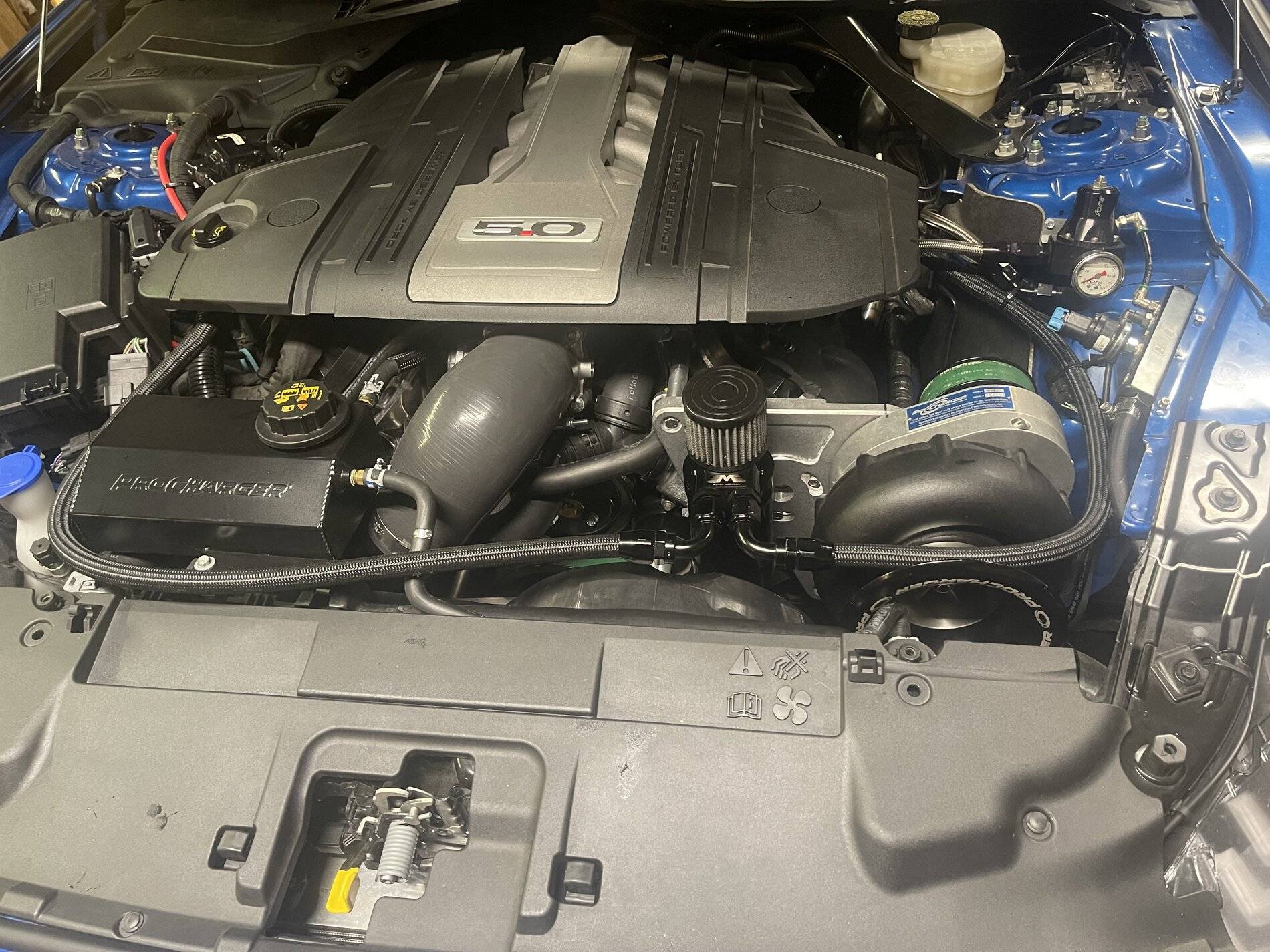

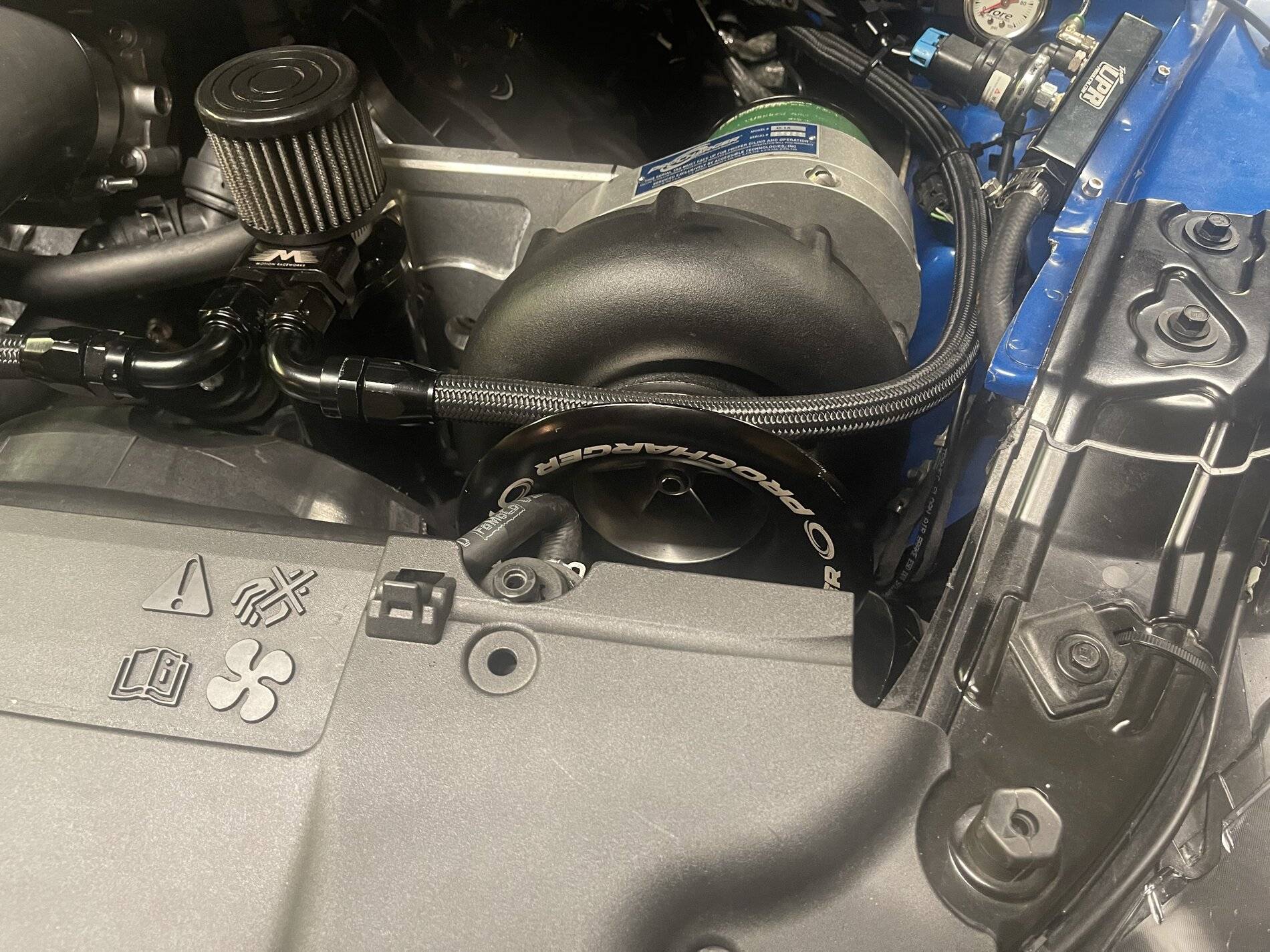

Well i dont think they are made for these cars, but after some trimming on the fan shroud i got her to fit!!!
guys is there another option for the small coolant line in front of it??

That looks good. Haven’t figured out a solution for that hose either. It’s not in a good place for the procharger

Any gains in these? I have one for my vortech and was planning on doing back to back runs at the track once I get everything on the car setup.

I was thinking about trimming the barb way back and installing a tight radius compression type fitting.
The F1A94 is even worse as the impeller is closer to the radiator than the D1X....

Just plug it. all it does is let trapped air out of the radiator. make sure you have all the air out of the radiator then cap it. Or trim it way back then thread it and install a bleeder. Just remember to bleed it if you ever drain the radiator for any reason

I like the catch can setup. is it just vent to atmosphere? It looks like it, you don’t feel like you need any kind of vacuum?
