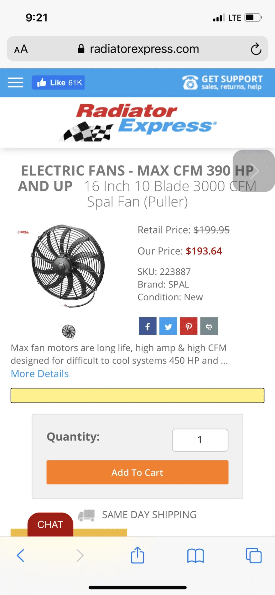

I have the spal fan and shroud that came with the procharger kit. It is rated at 1900cfm i believe. Do you think this is inadequate to keep the car cool. Even at idle the cylinder head temps will get over 210 degrees. And yes the fan is running on high
I Will check the air dam deflectors today and see if there all still in place.

1900cfm is not enough. You need closer to 3000cfm or more. If The air dams are in place the air through the radiator at 55mph is around 8000cfm. You are not getting enough airflow.
Is there a better 16inch fan?
From the searching I did they all seem to be in the 2000cfm area.
