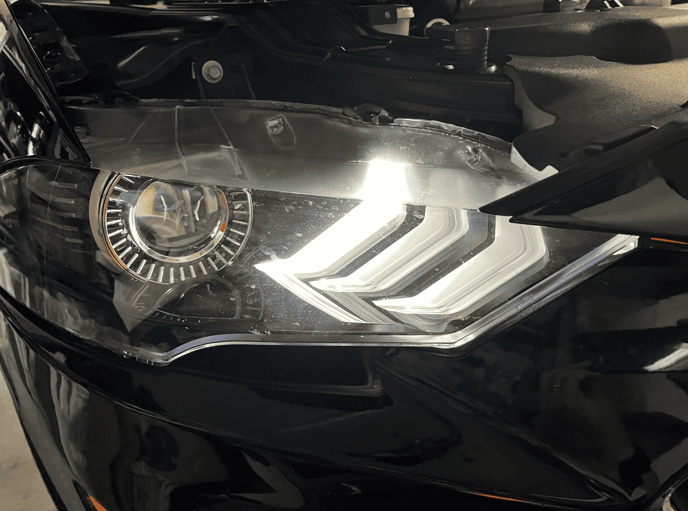

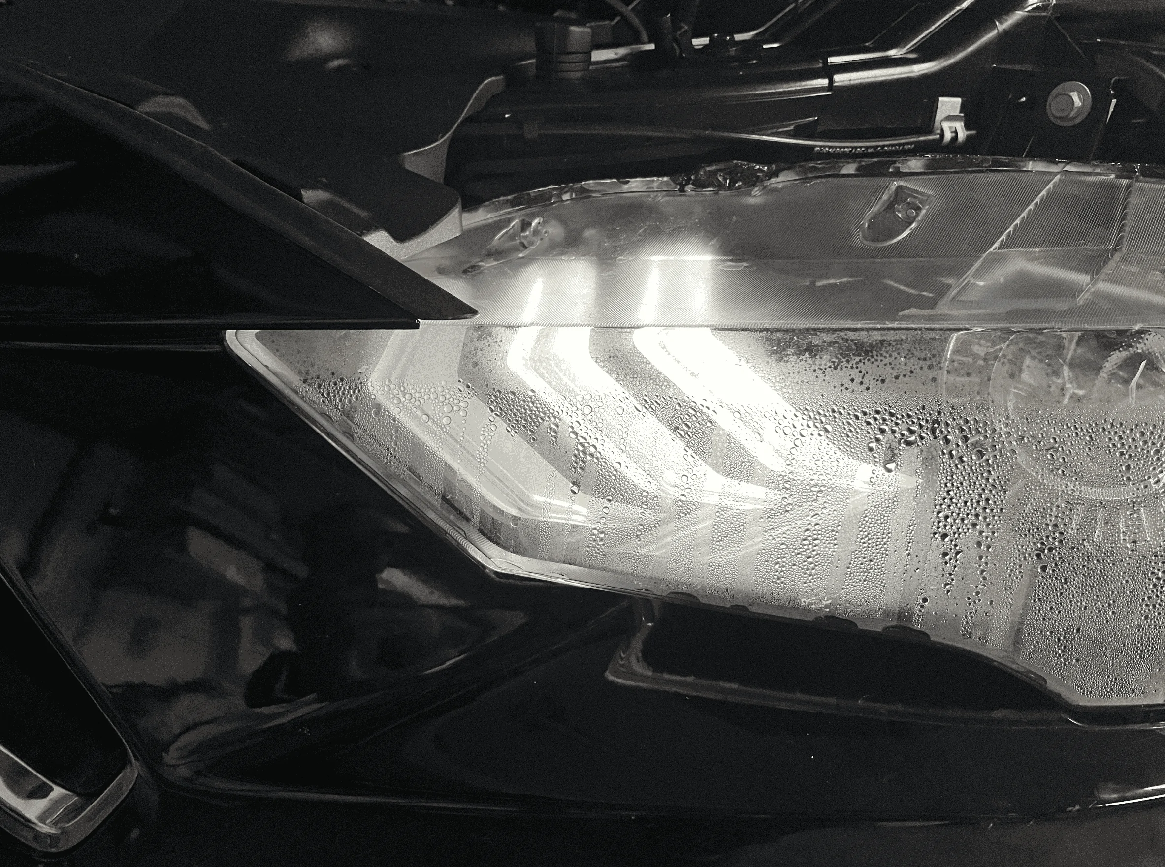

Upon closer inspection today, I noticed that something is off with the blinkers on both sides of the car. In short, on the driver side only 2 of the 3 lighting elements light up properly for the turn signal. On the passenger side, only 1 lights up properly.
Here's a 10 second YouTube video showing the behavior:
Blinkers not working properly
Here are the lights on. On the driver side, 2 of the light elements are on and on the passenger side, only 1 is on. Am I correct in assuming that in both scenarios, all 3 light elements should come on? I believe so but I don't have another car to compare it to.

Yeah, that amount of condensation is egregious. The light will fail in short order from that. I had the same problem with one of my tail lights, but that was covered under my ESP.

All 3 lights should be on, they do not flash with turn signals.

@K4fxd Did I understand correctly that the 3 DRL lights are supposed to be white all of the time? Ie, they shouldn't flash sequential amber for a turn signal?
I can see wire taps in the headlight wiring, so something has been messed with. If the headlight isn't supposed to function as a turn signal, that's probably what the wiring is doing.

That's correct, they just function as running lights

Looks like this is the mod (or something like it). Headlights needed to come apart and be resealed. That explains why the drive side leaks so bad.
https://www.diodedynamics.com/2018-2023-ford-mustang-multicolor-drl-led-boards.html
Either way, this car passed inspection with these obviously bad lights. They are going to have to fix them. Having half of the tri-bar lights burned out constitutes a safety hazard IMO...not to mention the horrendous condensation on the driver side.
