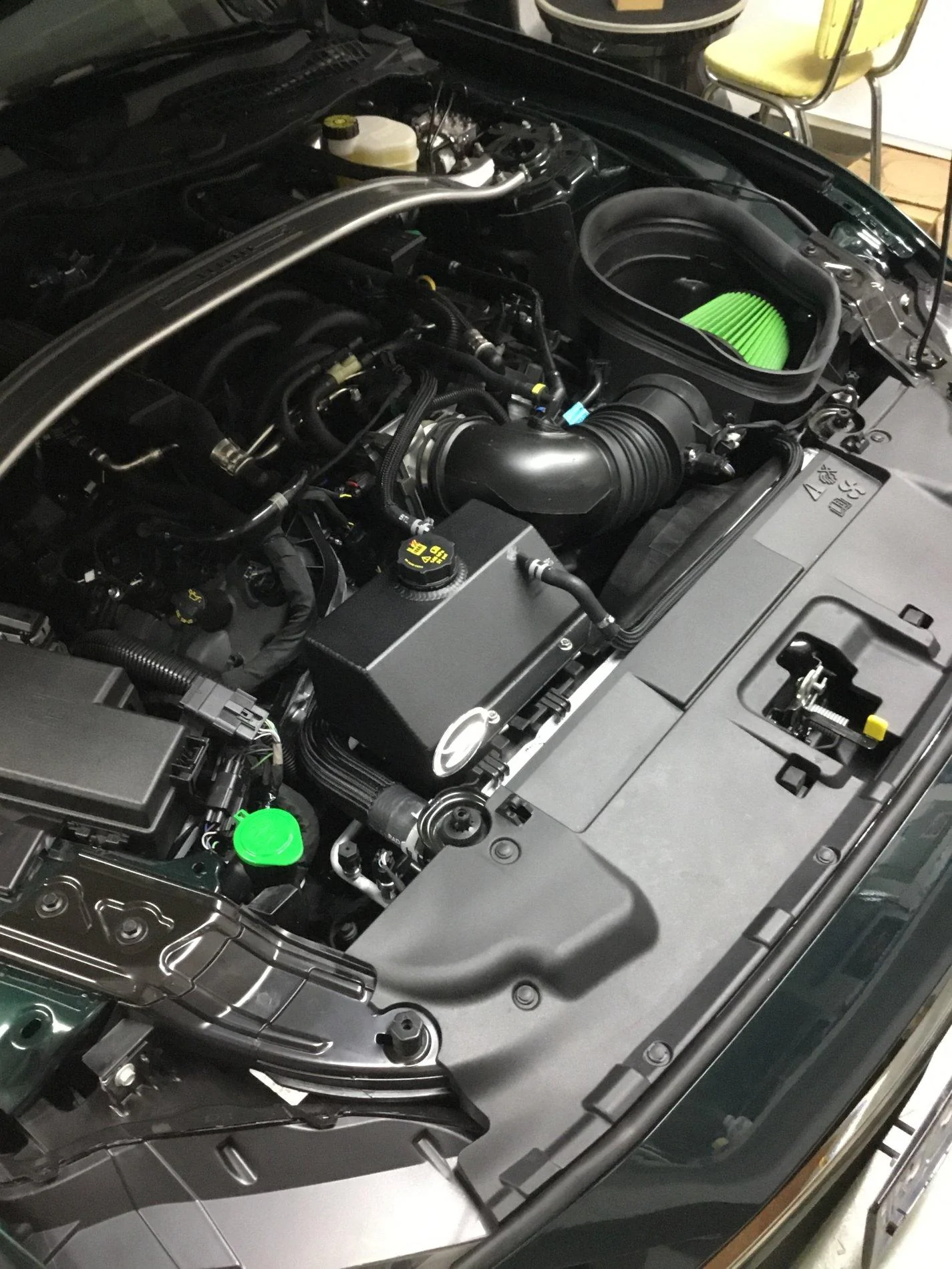

All above recommendations are great!! Steeda Springs installed on mine.. @Shwerin pls note...rear springs are side specific..inform your shop! Front measurements when done.. from fender lip to center of hub..14&3/4”... my rears are on the wrong sides..going back Friday to make it right! The Steeda H-Pipe is in my garage and I don’t know if I’ll install it?? I love the BULLITT sound!! Hood Struts for sure and the Green CAI filter is a must!! lol. IMMHO! Welcome aboard and post some pics!!

Where did you get the green Washer Fluid cap?
