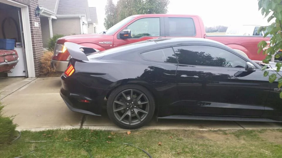

Nice , r u using existing holes or do you have to make new ones ?

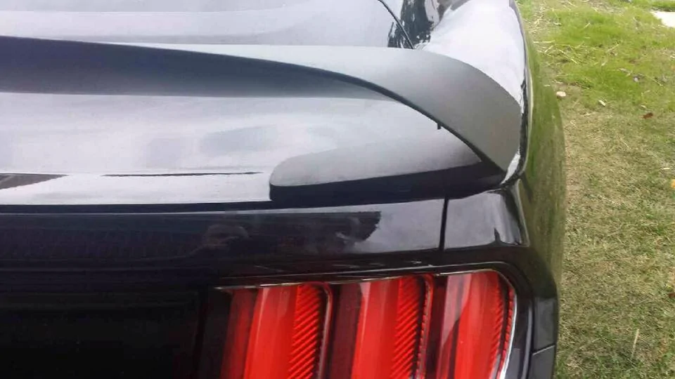

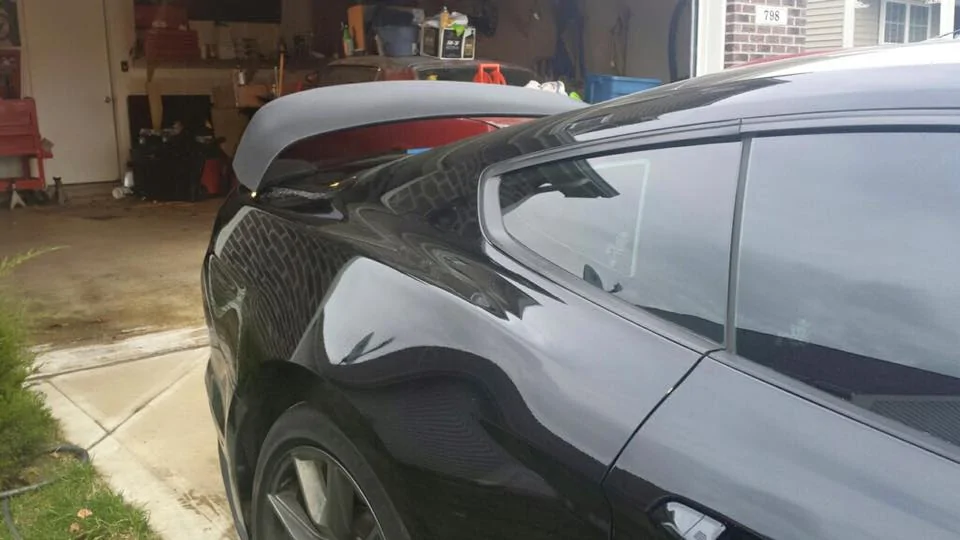

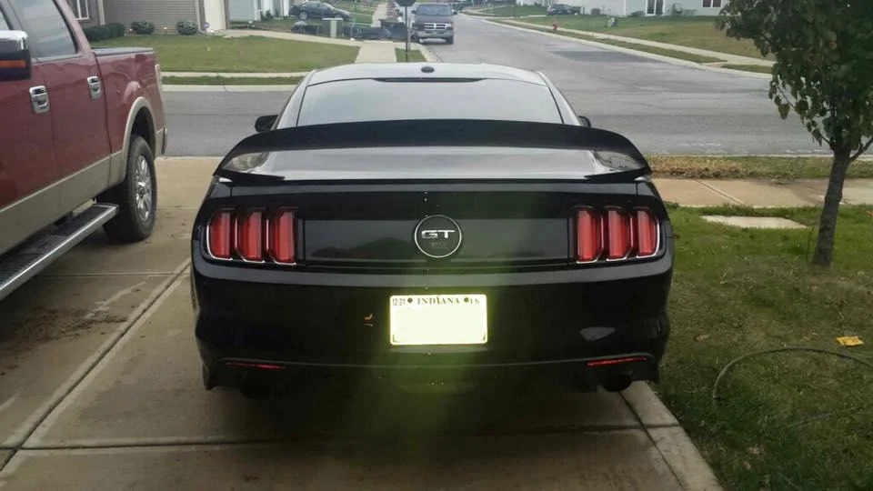

Nope... you have to drill 8 new holes. Also, the holes on the bottom of the lid have to be bigger to fit the bolt and socket through. It's a pretty extensive deal. I will work on the write up tomorrow.

Stunning! :)

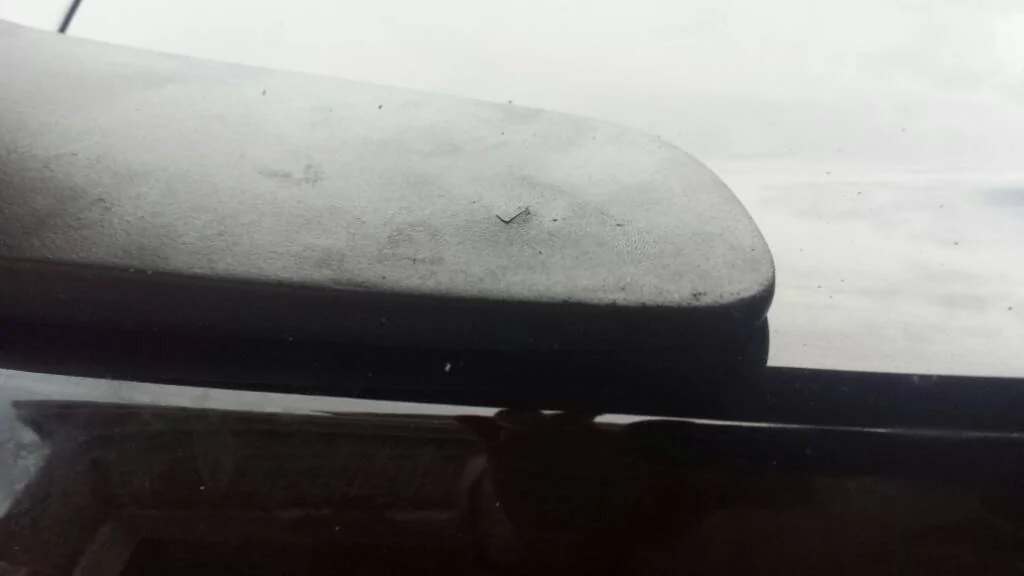

This goes out to everyone who has ordered and most importantly, the ones who have theirs on the way. The inside 2 holes on both sides are thinner than the outside. 4 of the 8 bolts that are sent are too long. Long story short, go buy 4, m6-1.0 bolts and some extra washers to use as shims. DO NOT USE ANY POWER TOOLS. I did mine with a nut driver, by hand, and still messed it up. Thankfully this is my test wing and I have another on the way. Here's a pic of what happens.

Is there anyway Carbon Dymanics could provide the proper nuts and bolts? Is the spoiler that fragile/easy to mess up?
