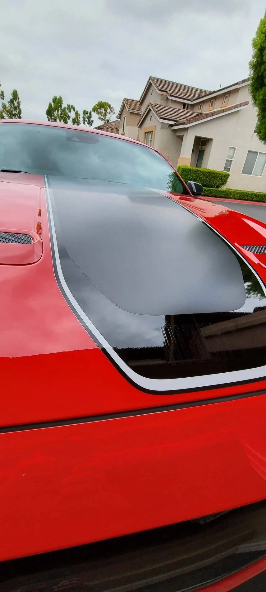

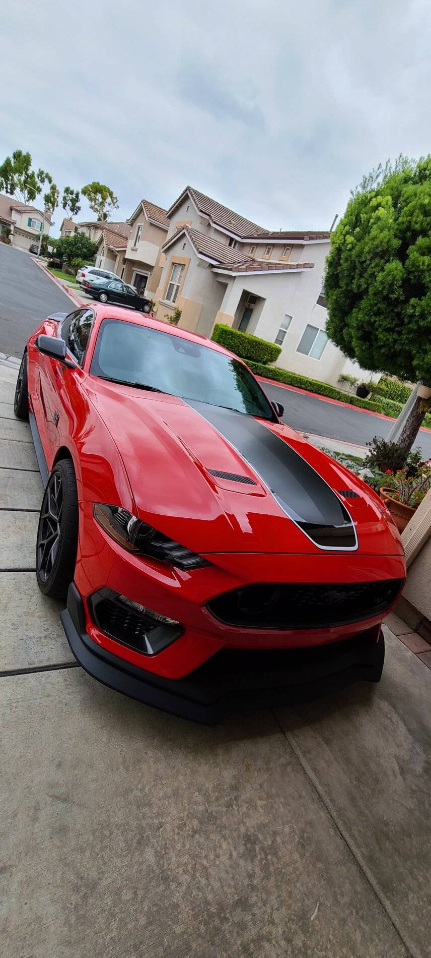

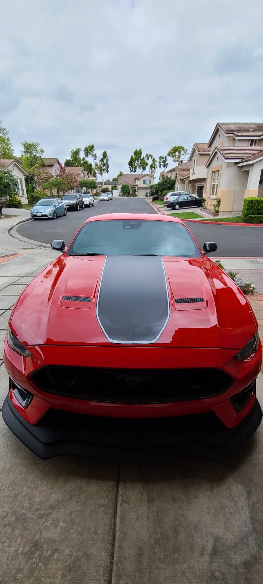

@murick, sorry for the delay. The film I installed over my hood is XPEL Ultimate Plus. My detailer also polished out the blemishes you highlighted, it arrived that way from the dealer. After about 2 weeks hoping the porosity would go away... it did not. Both the tech and I agreed that it had to be due to the texture on the matte section. Even though it appears to work on certain cars, like the FJ grey on YouTube, there's a high likelihood it won't on other cars. The adhesive under the film is not thick enough to fill the matte texture. And since I waited 2 weeks to remove the ppf, there was a risk of pulling up the stripe since the adhesive had cured. I opted to add a matte 3M vinyl layer on top of the ppf instead. They used knifeless tape to match the matte profile.

I did, my installer did a full gloss 3M Pro on the hood and then added the 3M Stealth over the section of the stripe that was matte. They explained that this solution would create the fewest potential failure points and it the matte ever needed to come off, it would lift the stripe because of the full gloss sheet under it... I'll take some pictures and post them...
