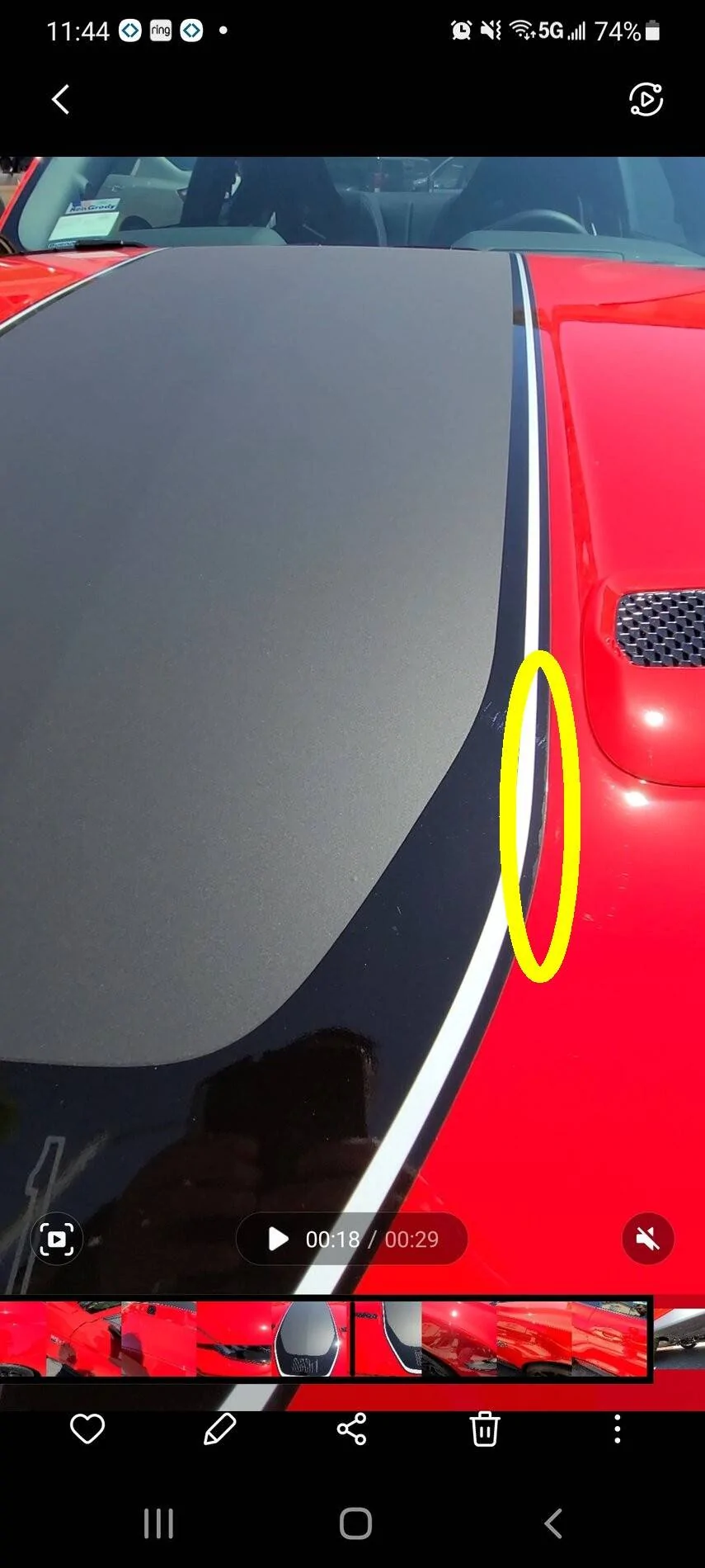

If this is before the PPF, then the highlighted edge looks like it had already a problem before, or was there some sort of protection film on the stripe which started to lift off?
I have seen three fresh made cars in two different shops (when I was scouting for one here) and while it is true that there might be some bubbles right after the film application, they should disappear (or the detailer makes them disappear) before the PPF dries.
There is also possibility to catch a dust/dirt which will eventually stand out (typically on black or dark paint), but even that is supposed to be without any bubbles and very rare (you have to really make an effort to find and notice one).
Apart from that all three cars I saw were spotless right when they finished them and were ready to be picked up by customers.
Since the defect seems to be localized to the "rough" part of the stripe (the glossy black edge does not have them), it looks like there was either some residuum on that part of the stripe which they did not properly clean up, or the material itself is not suitable for this particular PPF.
Which just makes me ask you again, what PPF brand did you use? My experience I described above was with XPEL Ultimate Plus.

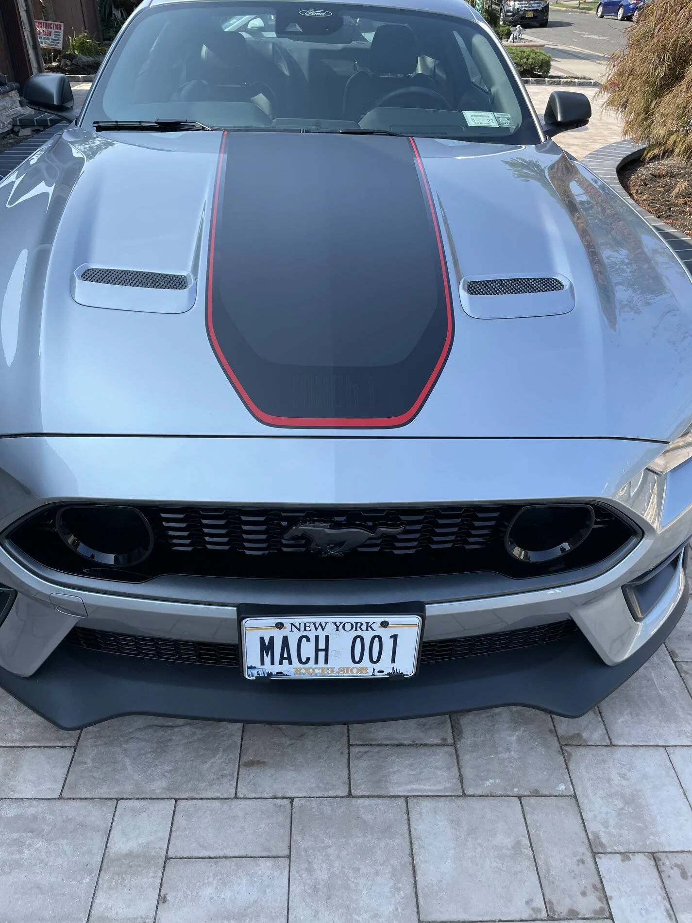

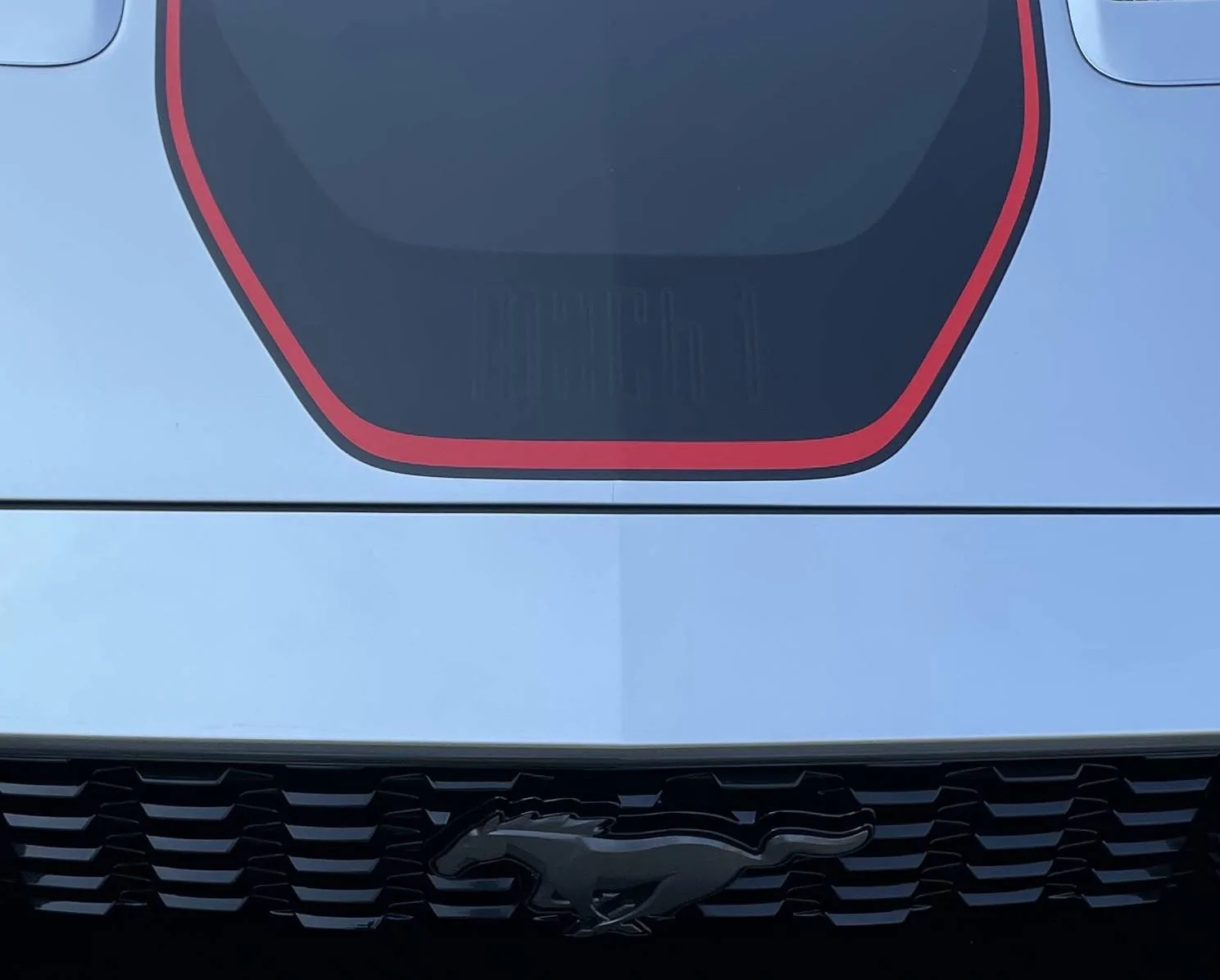

My guy cut around the stripe and was able to butt the PPF up to the stripe. He did it in 2 pieces and left a tiny 1/2 inch seem front dead center. Cant see it unless you're standing on top of it staring at it. He could have done it in 1 piece but would have charged me quite a few hundred dollars more. I'm fine with it. Had the rocker panels done and he covered the side stripes, since they're glossy you barely even notice. Very happy with his work.

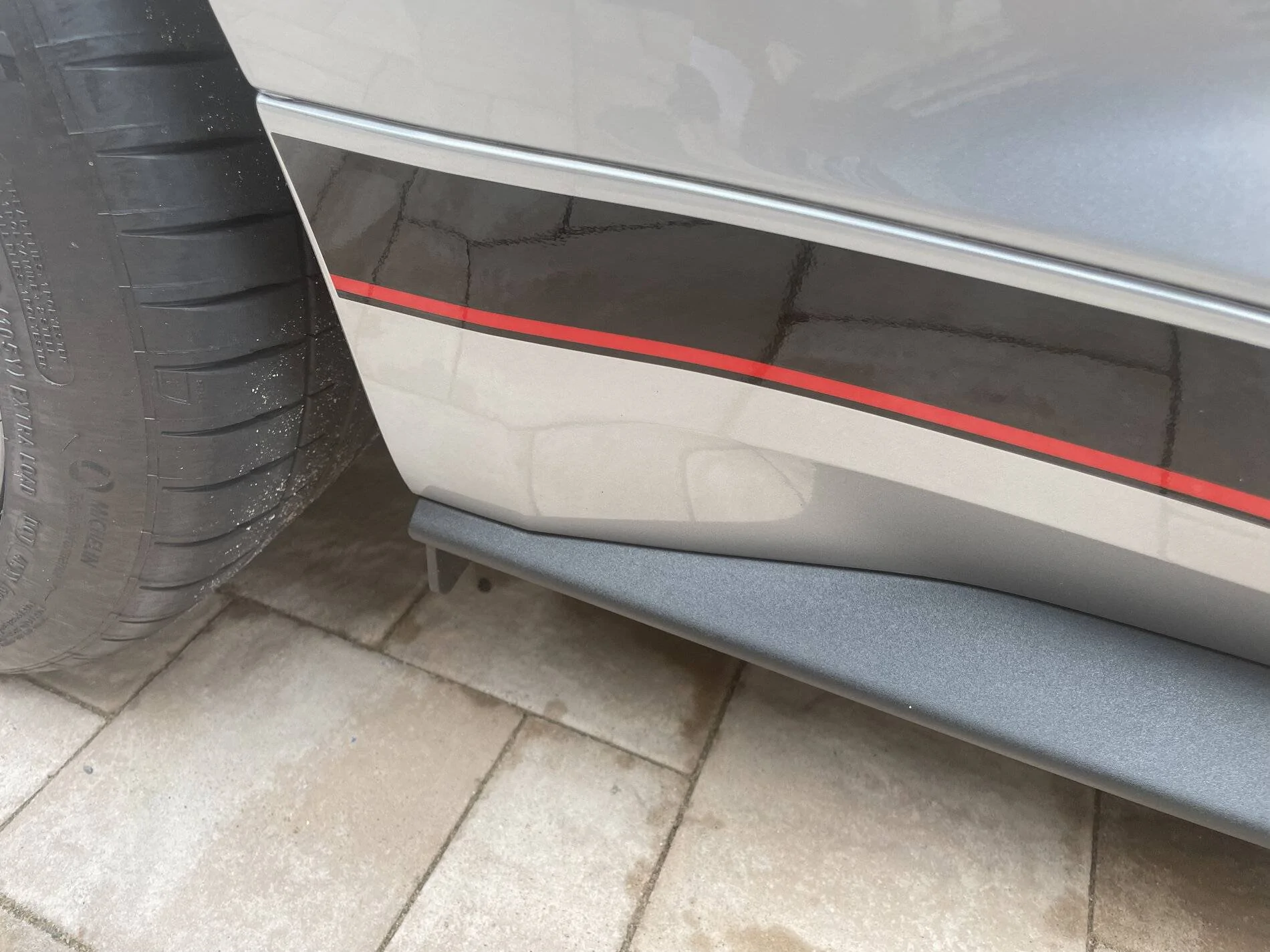

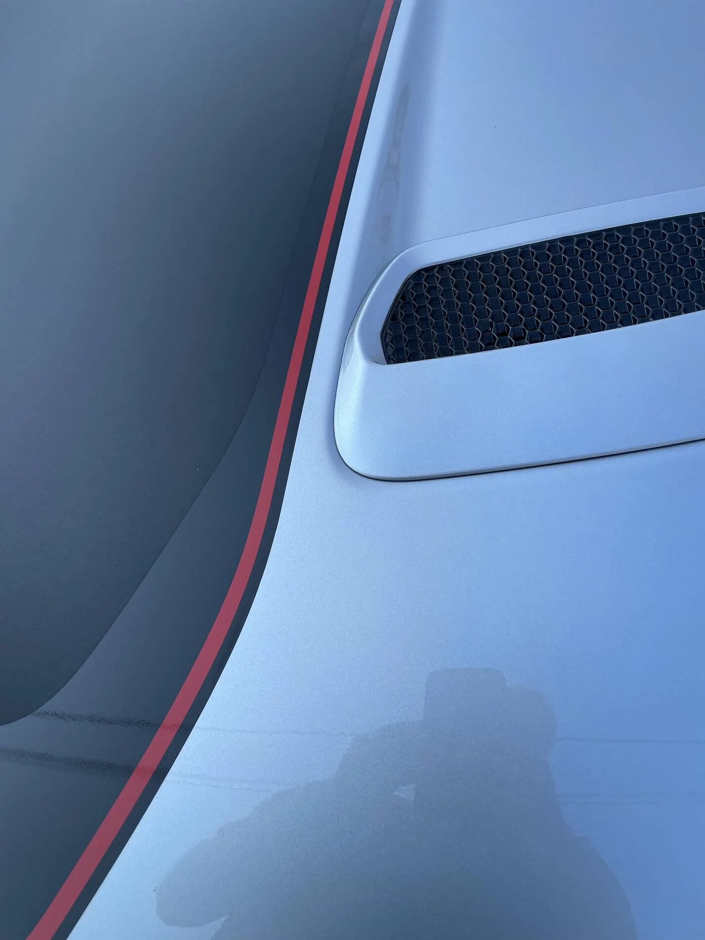

Here’s some pictures of the area in front of the rear wheels. If you look close you can see the line where the PPF is but in person no one notices it. The section on the hood is impossible to tell it’s there.
