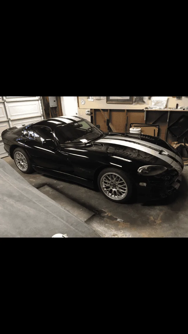

As explained the only reason a lot of front engine sport car, including my Viper, come with smaller tires on the front is indeed to promote understeer because it’s safer and easier to handle for average driver
the first thing that anymore having any modicum of track experience do on those cars, is to put bigger tires on the front
The Simple physics and car dynamics behind this modification is quite easy to understand

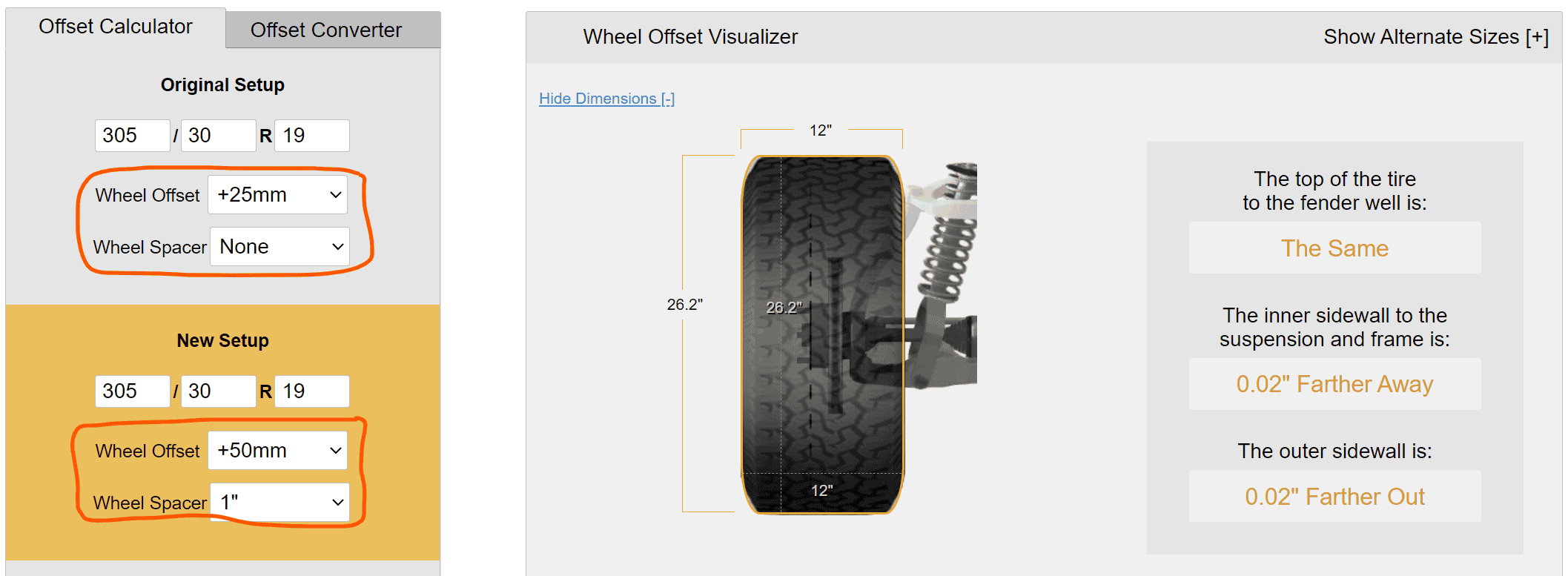

Let me try to explain
Let say that we are using a 1”/25mm spacer, that will move the wheel out by the same distance
A wheel with an extra 25mm negative offset will move out the wheel by exactly the same distance
The less load on a bearing would be a wheel with 0 offset, meaning the center, width wise, of the wheel would be directly in line with the bearing. Any positive or negative offset , because of the leverage factor, put some extra load on the bearing but a spacer only add extra negative offset and for the bearing there is no difference if the wheel has 45 negative offset or 20 negative offset plus a 25 spacer. In both case the number, therefore the load is the same
Hope that make sense
let me support this with a visual representation:
After all, wheel bearings/hubs are considered consumables in track duty and heat kills them much faster than spacers.
I understand, but to be clear, what I've read and understood about the problem also applies to more aggressive (than OEM) wheel offsets. From what I gather, you risk the life of your wheel bearings with either choice.
