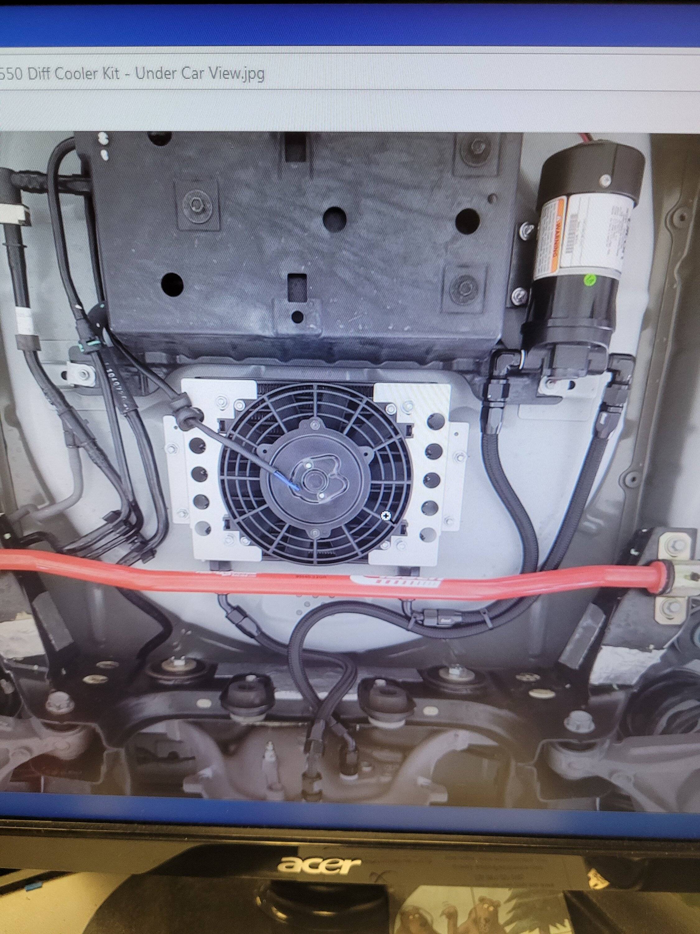

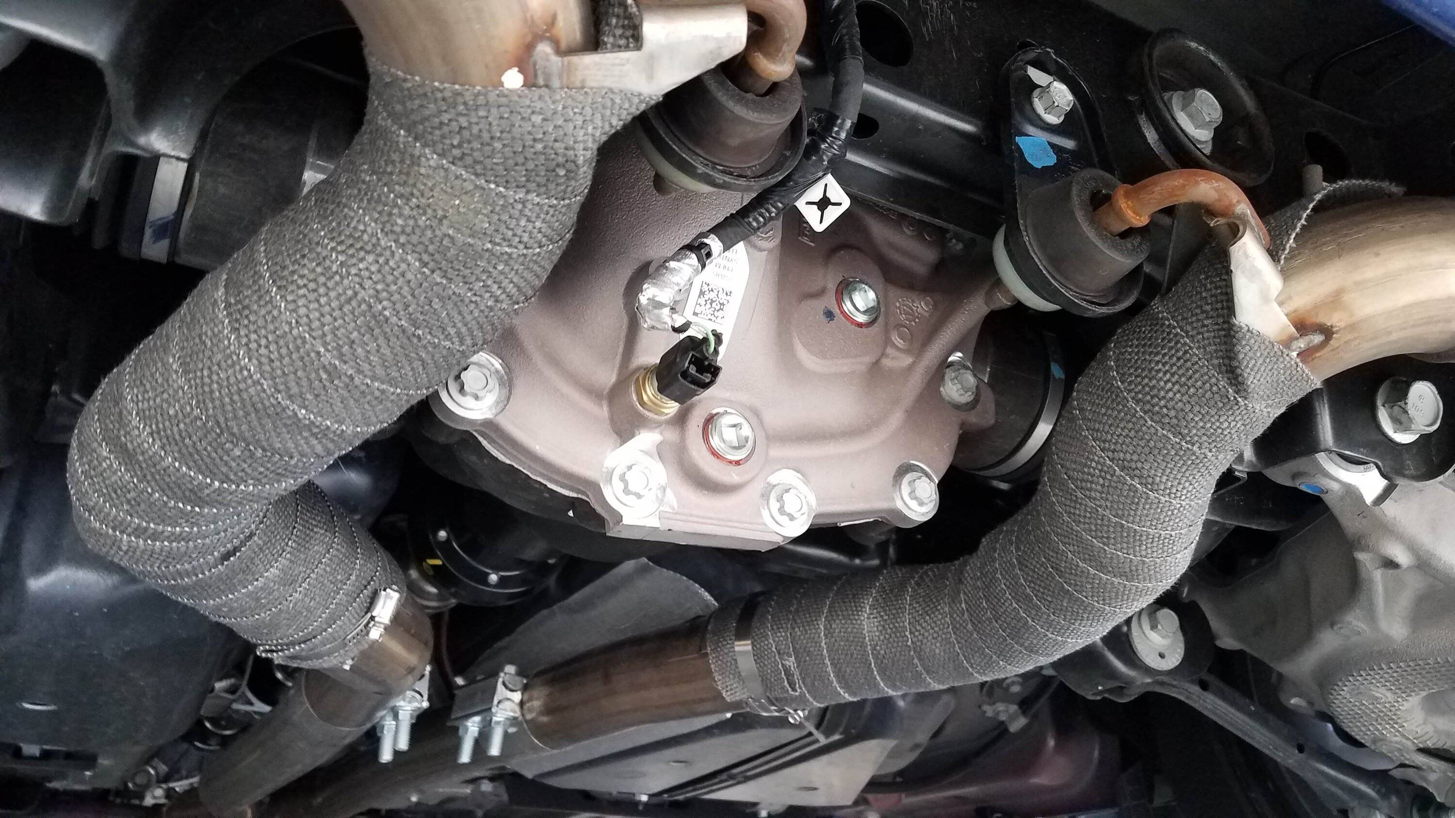

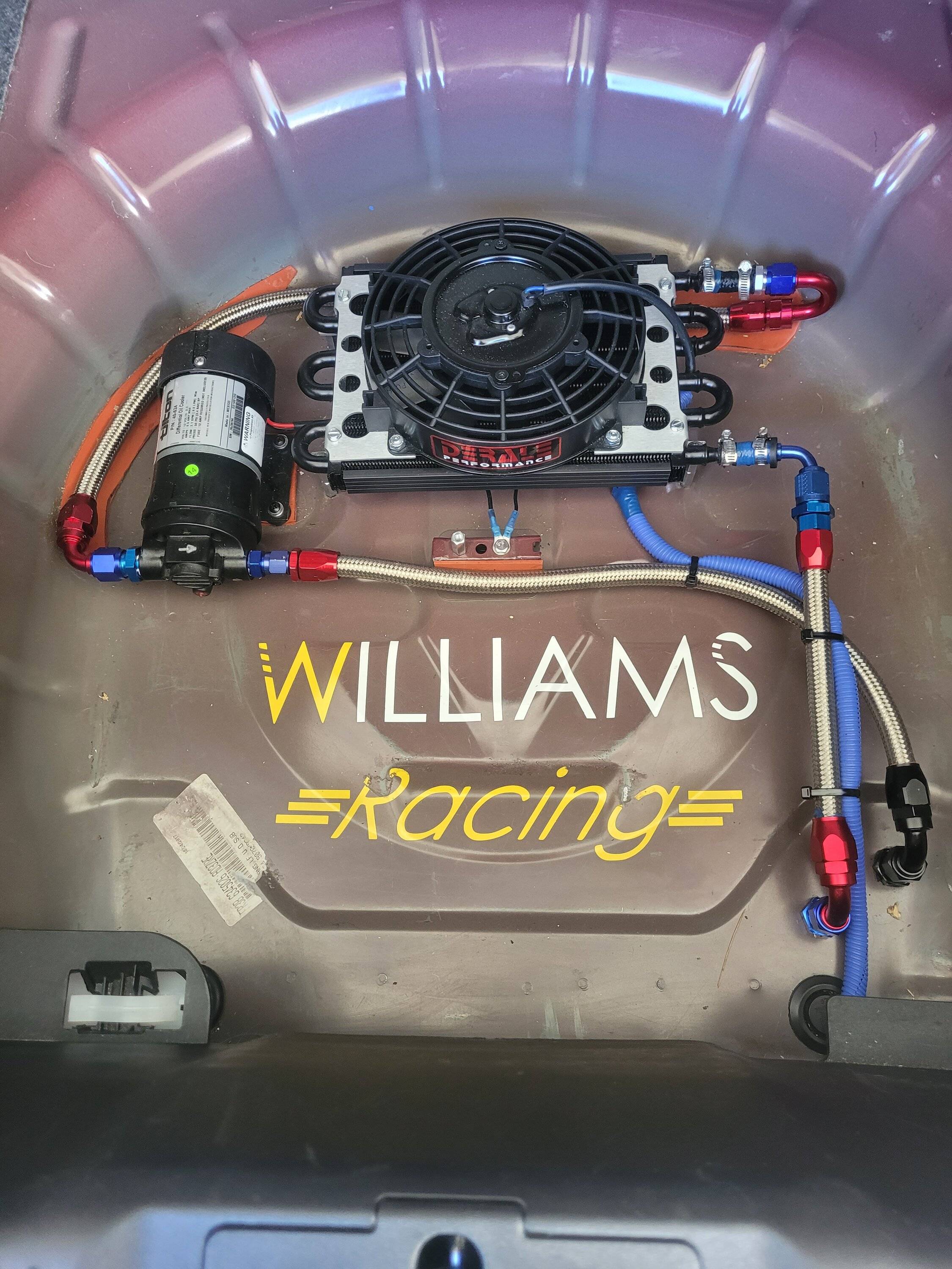

Diff cooler if needed after a good exhaust wrap. Do the wrap (first photo) and then when and if you need more cooling then buy or build a diff cooler. I put mine in the spare tire well (2nd photo) but many have put them under and behind the diff. (3rd photo) There is a How too in the DIY section of the forum. as far as oil they are several oil to air cooler out there at get the job for most HPDE runs.
