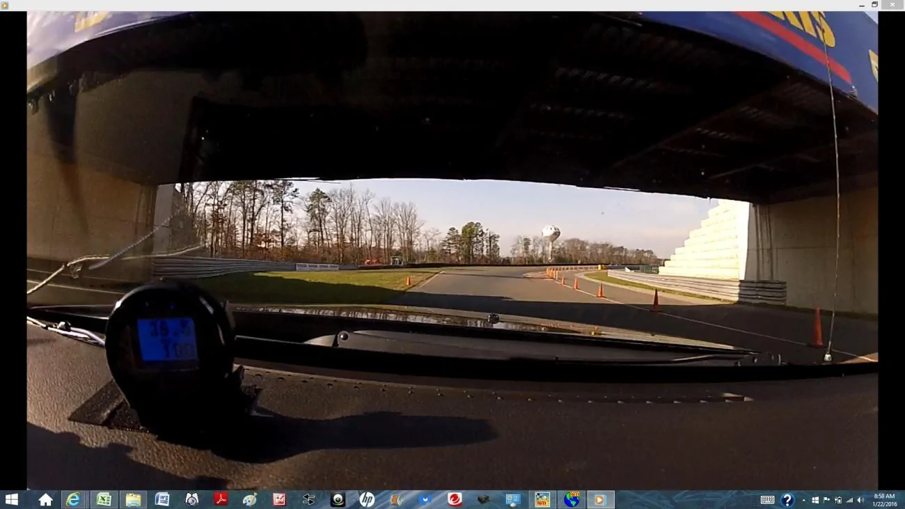

Tracking the car is different. Would you trust its composure equally well at 100+ mph through a 45° 1+g kink in the road while rolling the right-side tires
over the red/white striped curbing as you're beginning to feed in a little power?
You won't get any argument from me. But I wouldn't trust the PP GT for that, either. Would want either a GT350R or build up the car with some good aftermarket parts.
But how many folks track their car in any kind of serious event? I've dragged this car a few times, but never once taken it to a track event. Maybe someday, but even then... would be for fun. Nothing serious.
As a DD, stock regular GT is way more than anybody needs, even most Mustang guys. I remember one of the reviews (C&D I think) mentioned that the GT PP easily outhandled the Boss 302. Not too much of a stretch to think the regular GT probably outdoes the previous gen track pack, though I'd be interested to see the comparison.
Bottom line: if you're a track guy, at a minimum, go GT PP. Ideally aftermarket or GT350R. If you're not, pardon my French... who gives a sh*t?
do people do that in real life? I do that in Forza and end up in the grass
