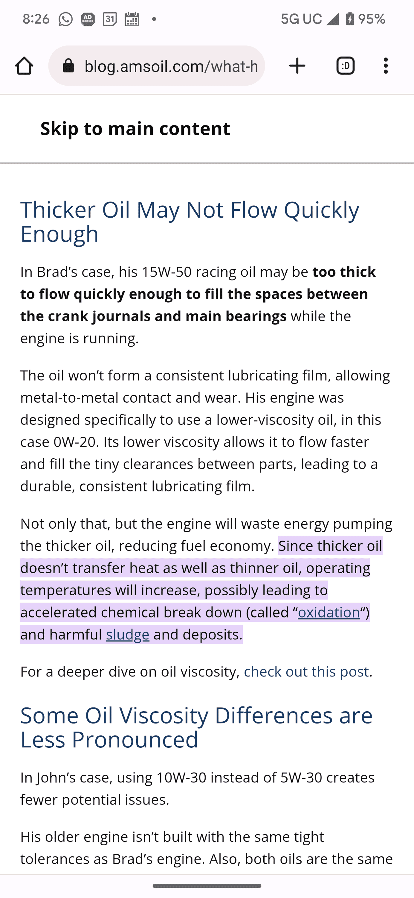

Last note. The "viscosity oil myth".
"I put thicker oil and life problems went away"....is sometime over estimate.
A thicker oil does not reduce temps
What it does it allows you to sustain higher temps without loosing the lubrication effect of the oil.
A thicker oil helps the engine to work at 280f without issue. Same with diff.
But a thicker oil also increases temps. Yes it does.
And last. Your diff is depending on oil viscosity. Changing it might modify the way it works.
