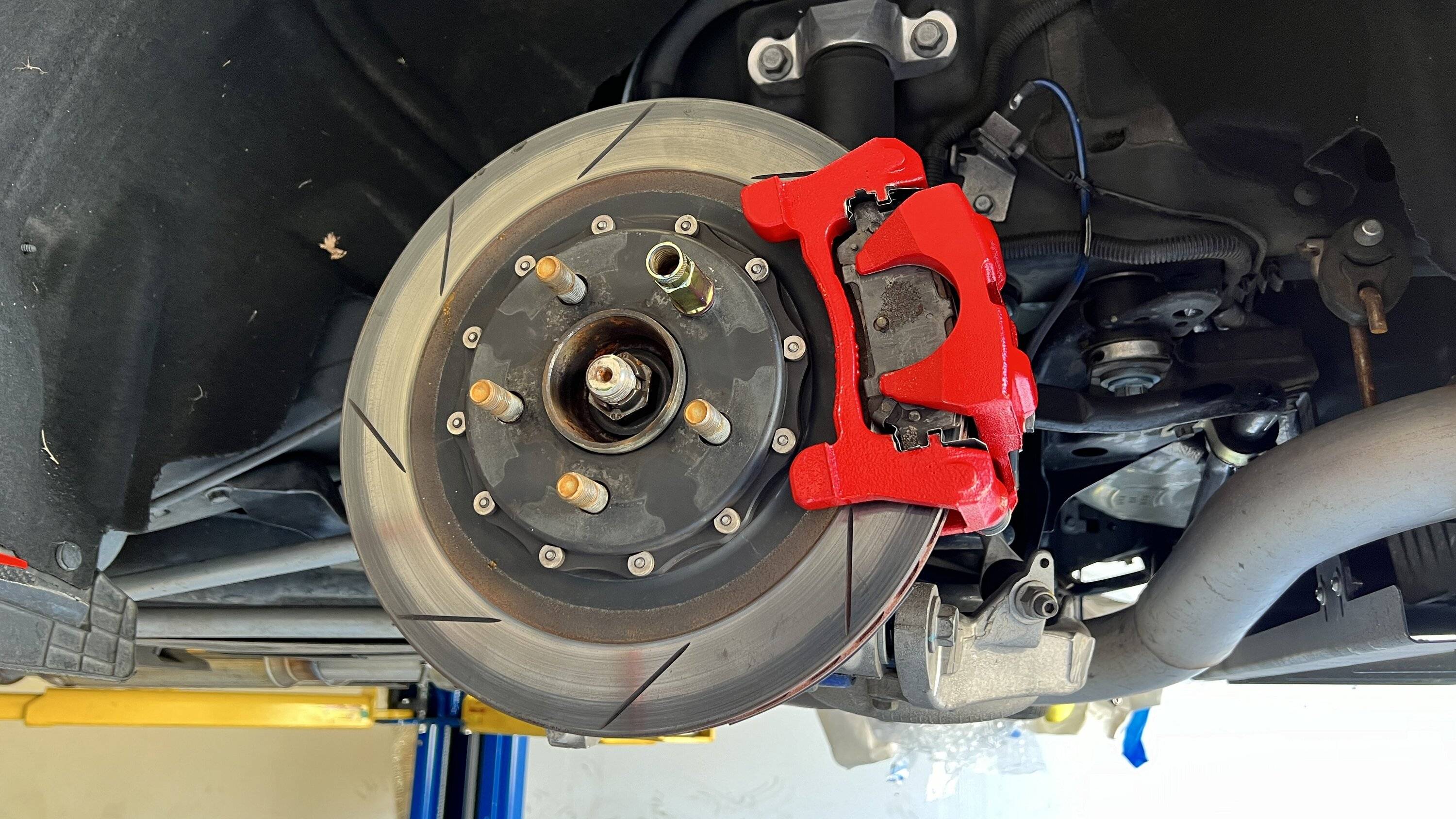

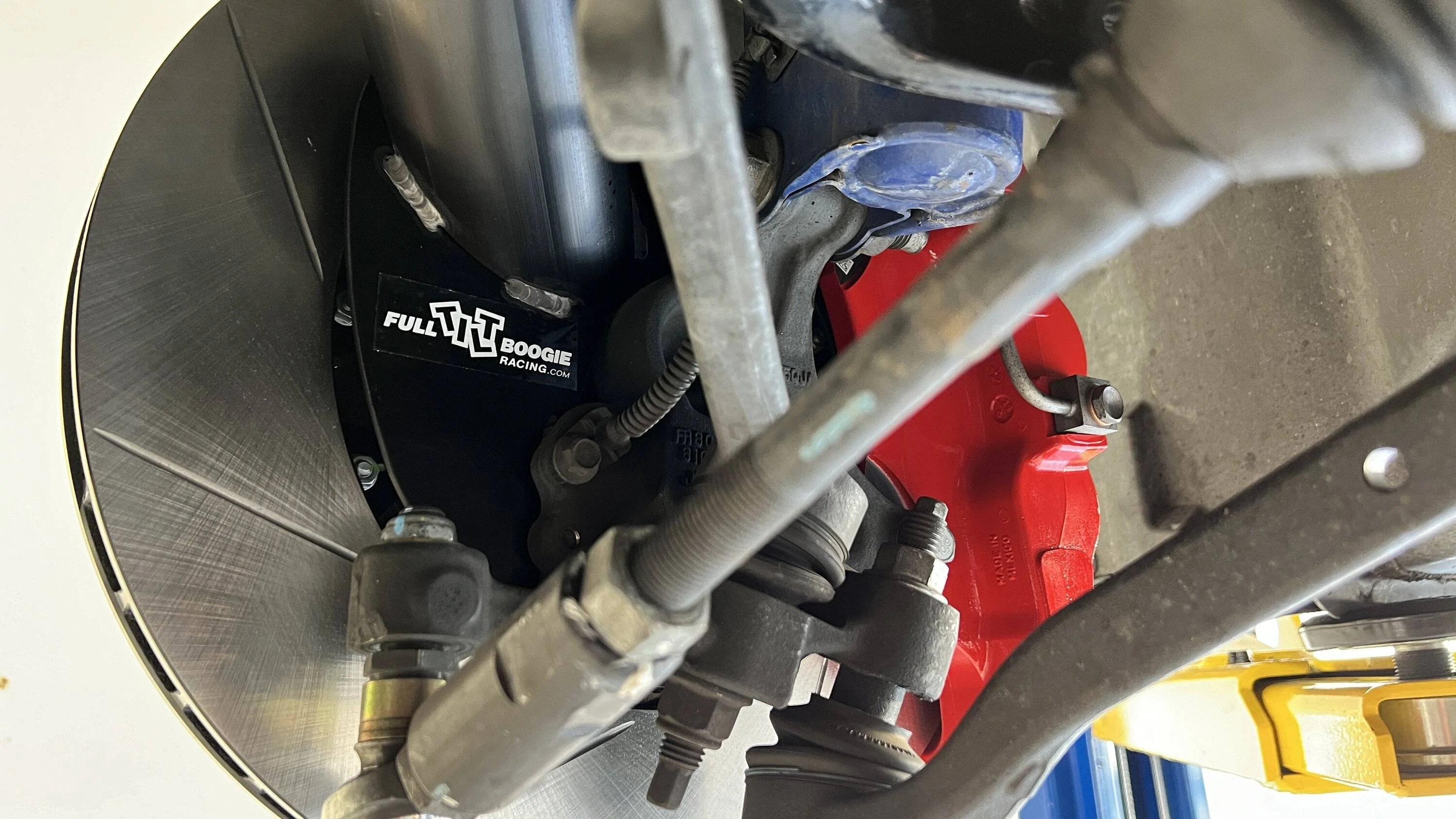

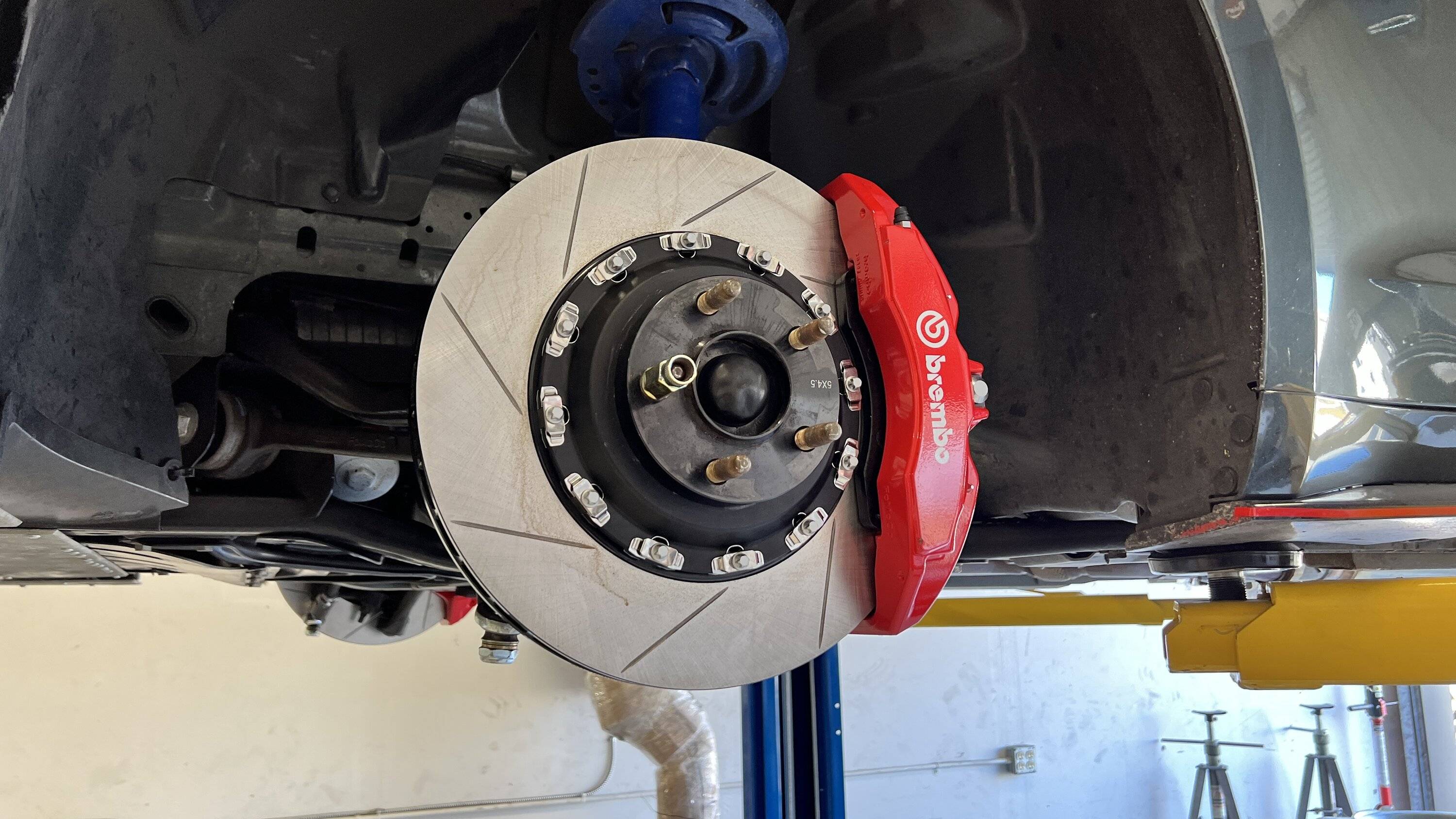

With all this brake talk I had to post a pic of my reworked brakes. New calipers all around, 2 piece rotor replacements in front (same in rear), new fluid and still using hawk track orientated pads. There’s also a FTB kit there that I’ll finish next weekend(ran outta time).
