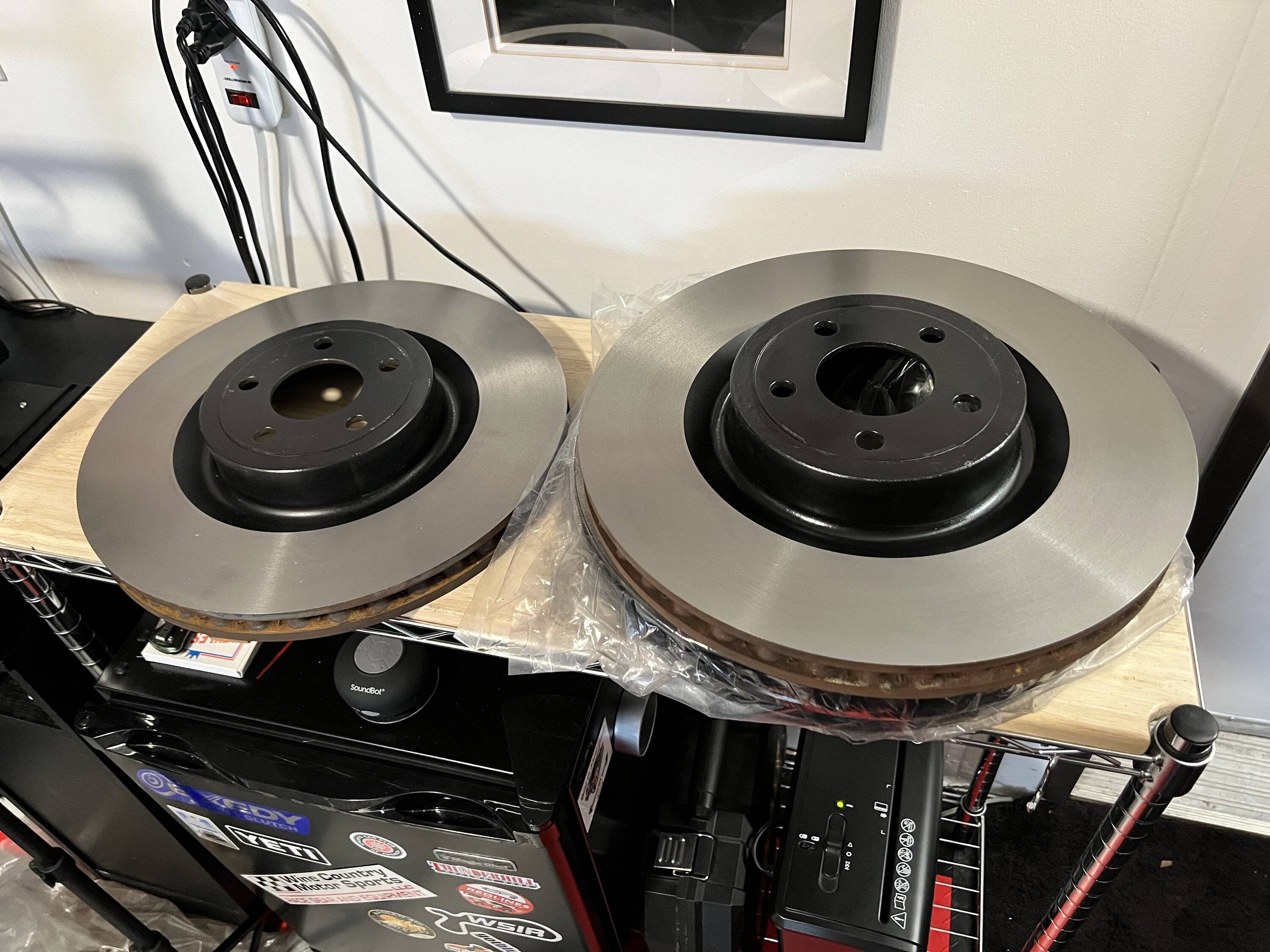

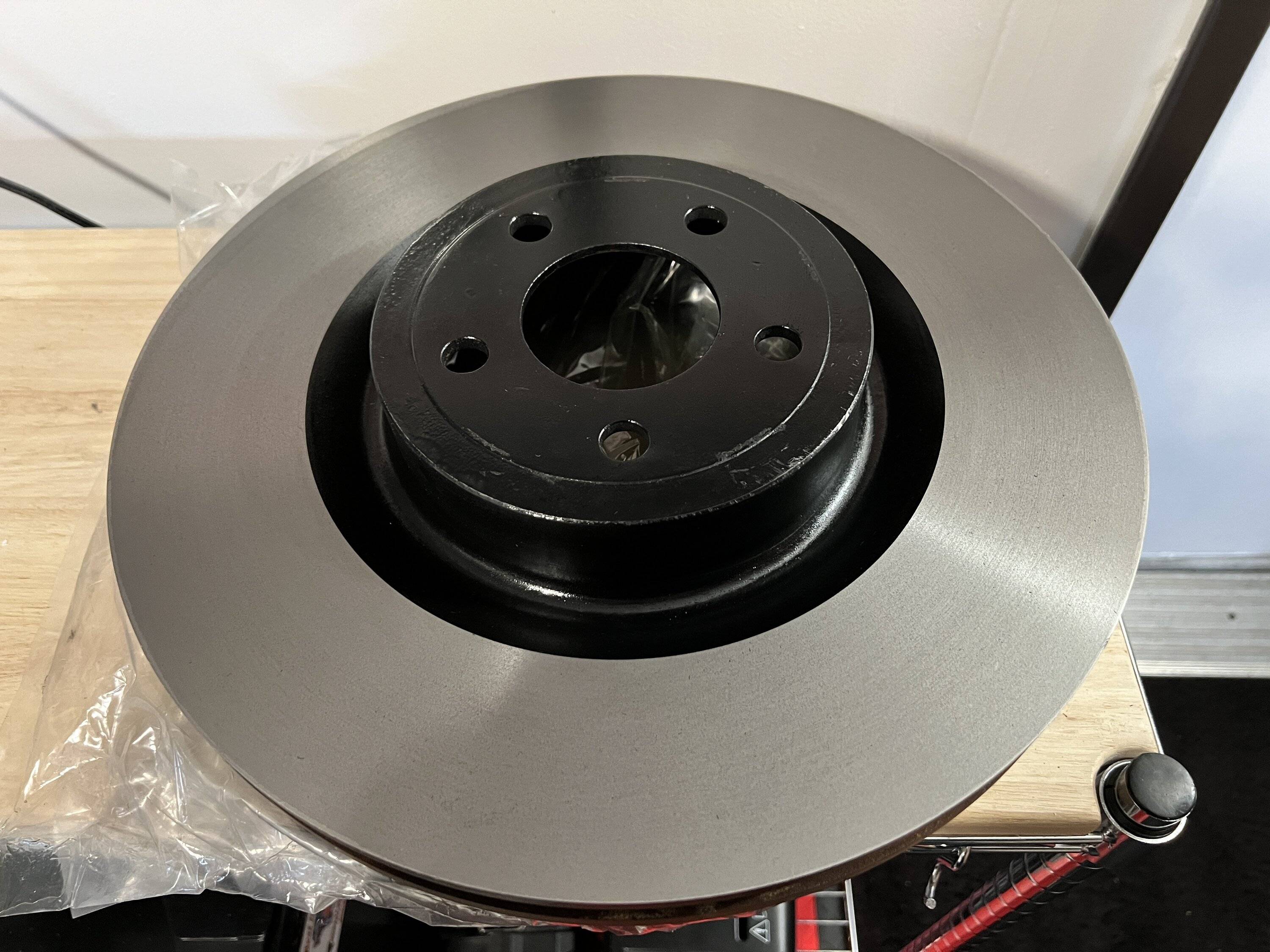

If your interested I have a pair ready to rock. They just got turned 2 days ago.
