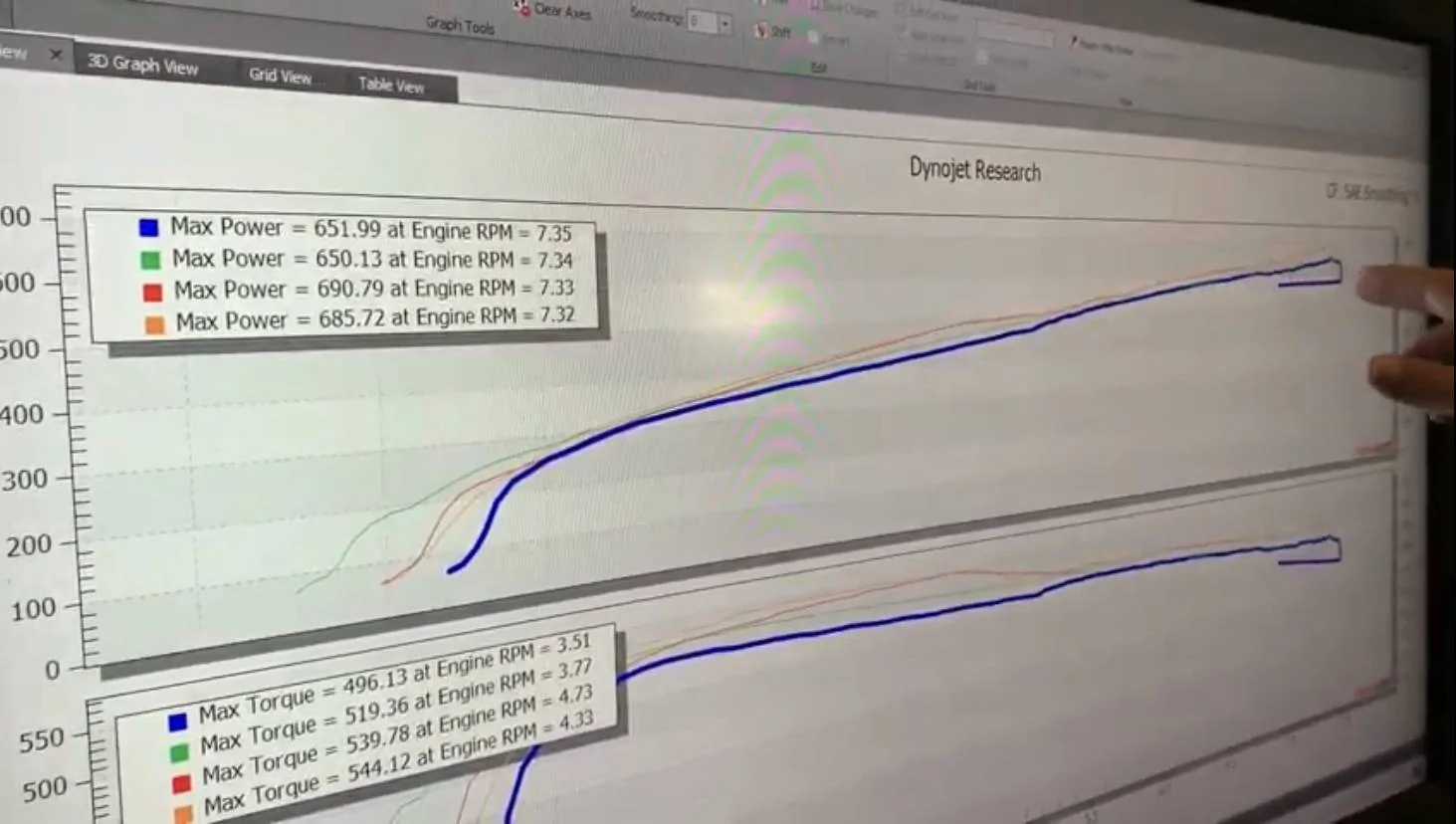

I’m not savvy enough on a computer to post a link, but here’s a picture of the power gains Brenspeed got with just a JLT intake no tune, 35-40hp! I’m impressed!if someone wants to post the link I’d very much appreciate. It’s on Brenspeed YouTube.

Why does the neck look like it has cracks/holes in at 1:48 when he holds it up? Anyone have one? Is this actually a quality piece?

If your talking about inside the neck, thats a glare from the light shining in.
The dyno pull with the JLT needs to be done with the hood "CLOSED" to compare with the "STOCK CLOSED" system!!!!
It’s not shown on video, I seen a pull without stock cover, still not even close to 690.

I like how they say they got it to seal as the best they could. It will never seal as well as the factory intake. In daily life the stock intake will be better. Maybe at the drag strip or full throttle it might give you more HP, but at low to mid throttle, or driving around town I'll take the factory intake.
I have had a few JLT intakes in the past, they may seal ok when new but give it a few weeks the seals will deteriorate or deform and you will start sucking in hot air. When someone comes out with a intake tube without the accordion elbow, that will fit into the factory closed airbox, it will smooth out the airflow and be better than the JLT
if you really want to cool down the air going into your engine, a intake isn't the way to do it, only upgraded intercoolers will lower air going into the engine.
Don't believe the JLT hype, do they really have air flow engineers who can design a more efficient intake, my guess is no. The intake for the GT500 looks the same as everything they have made for a decade, I don't see anything new or innovative
I had a JLT on my 2011, had trouble tunning the car. I am no engineer but have some common scene, designing my own intake from different new and used parts, the driveability was much better and it made 40 more RWHP. Yes I know it sucked in hot air, but at least it was tuneable

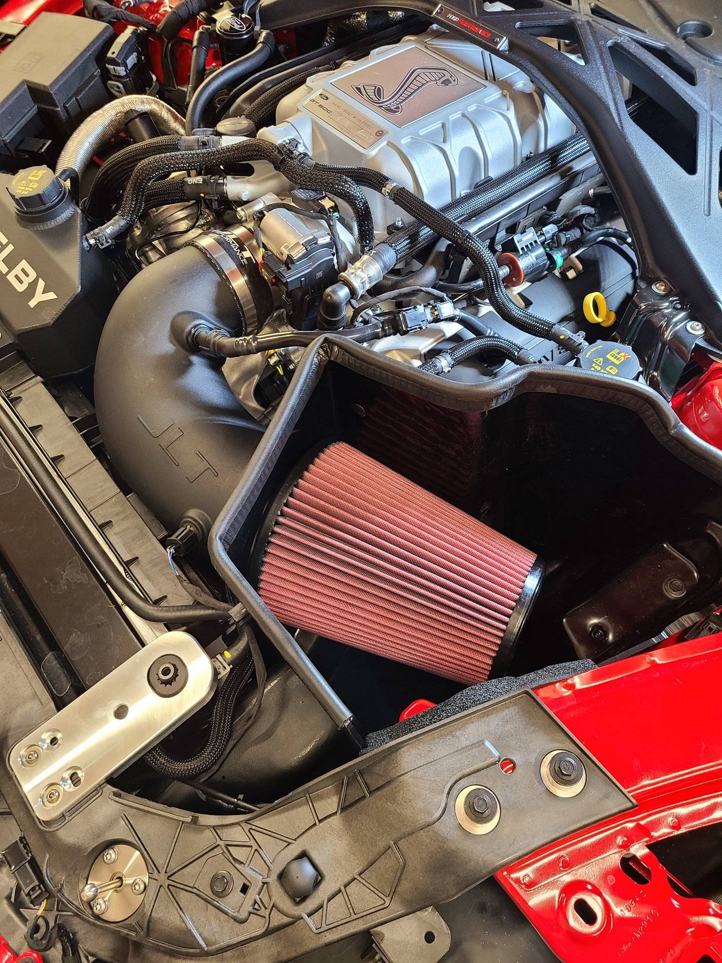

Well wouldn't you know it, my JLT intake came in! It was on backorder so i didn't figure i would have it this quick. I have to say it is a very nice piece. Fit and finish is perfect, it is tight squeeze but everything falls into place and lines up great. Still connects to the front grill scoop factory like. I have ZERO complaints. I honestly cannot see how or what to improve on it? I know many use the 1320 intakes and claim more HP, so i am puzzled how? The intake elbow is Very large necking down to still very large (larger than TB opening), the silicone TB adapter is necked down so I assume once i go to bigger TB i won't need a neckdown silicone spacer but just straight one. Filter is HUGE. I am happy and still very curious how the 1320 intake makes more power because i just do not see any flaws in this setup. By the way i got a outerwear prefilter for daily driving to keep the bugs out of it.
