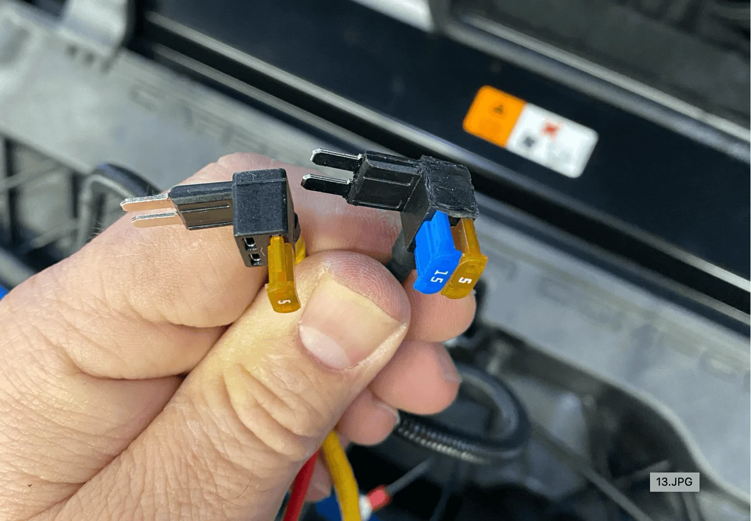

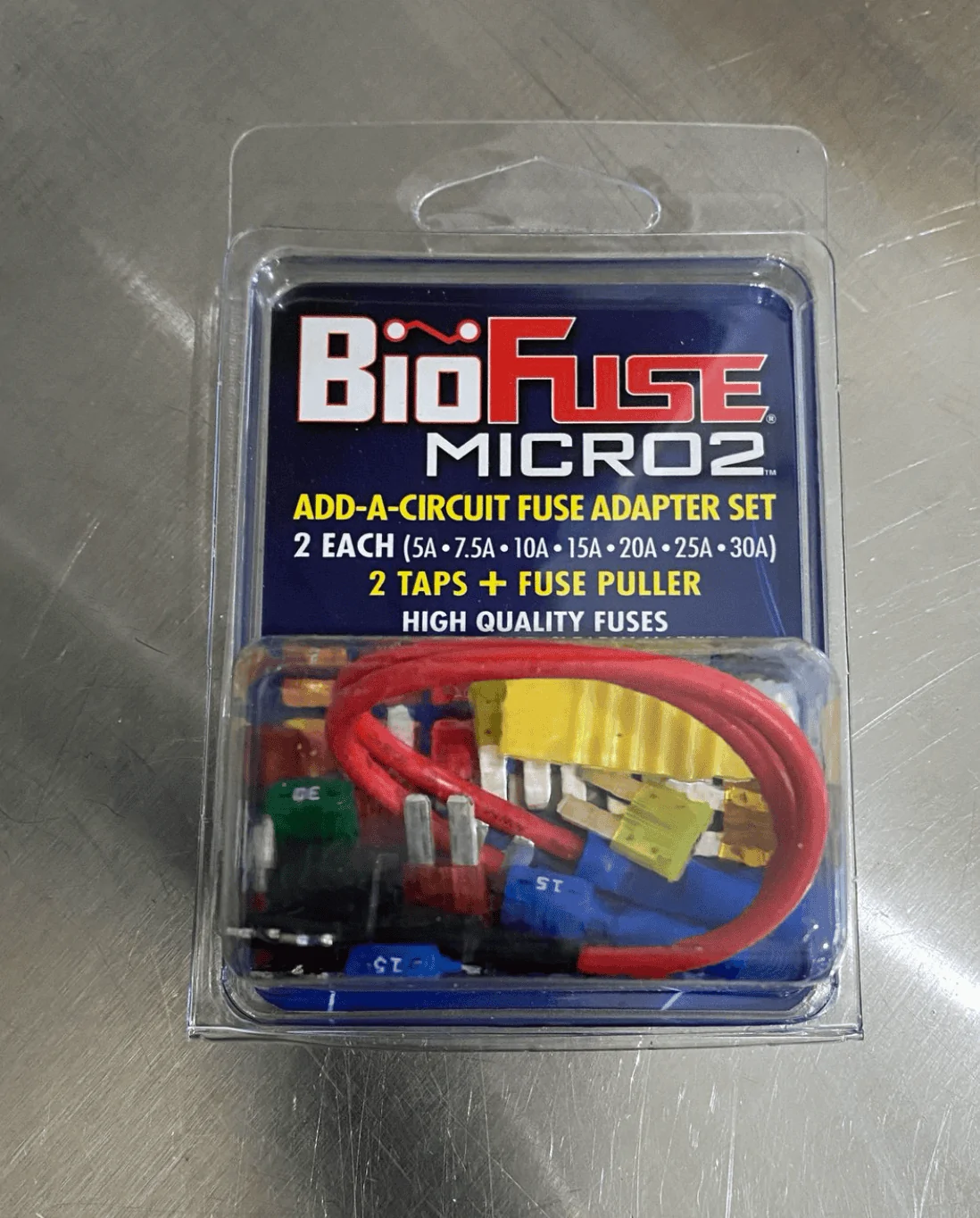

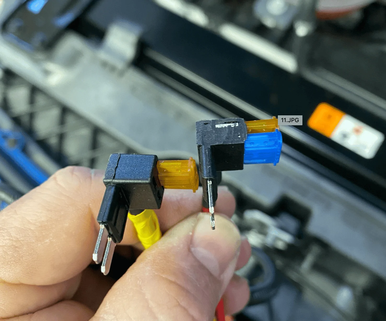

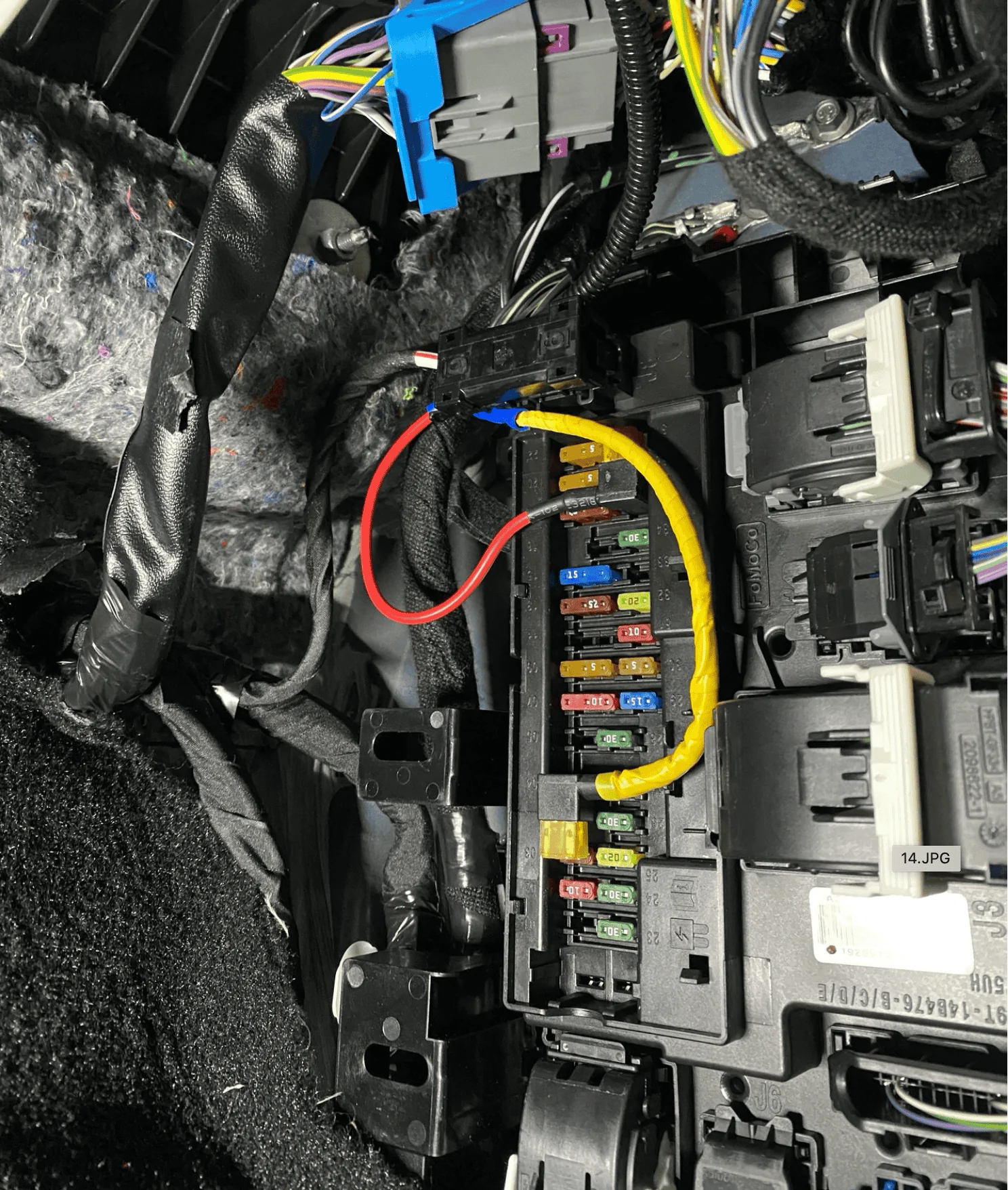

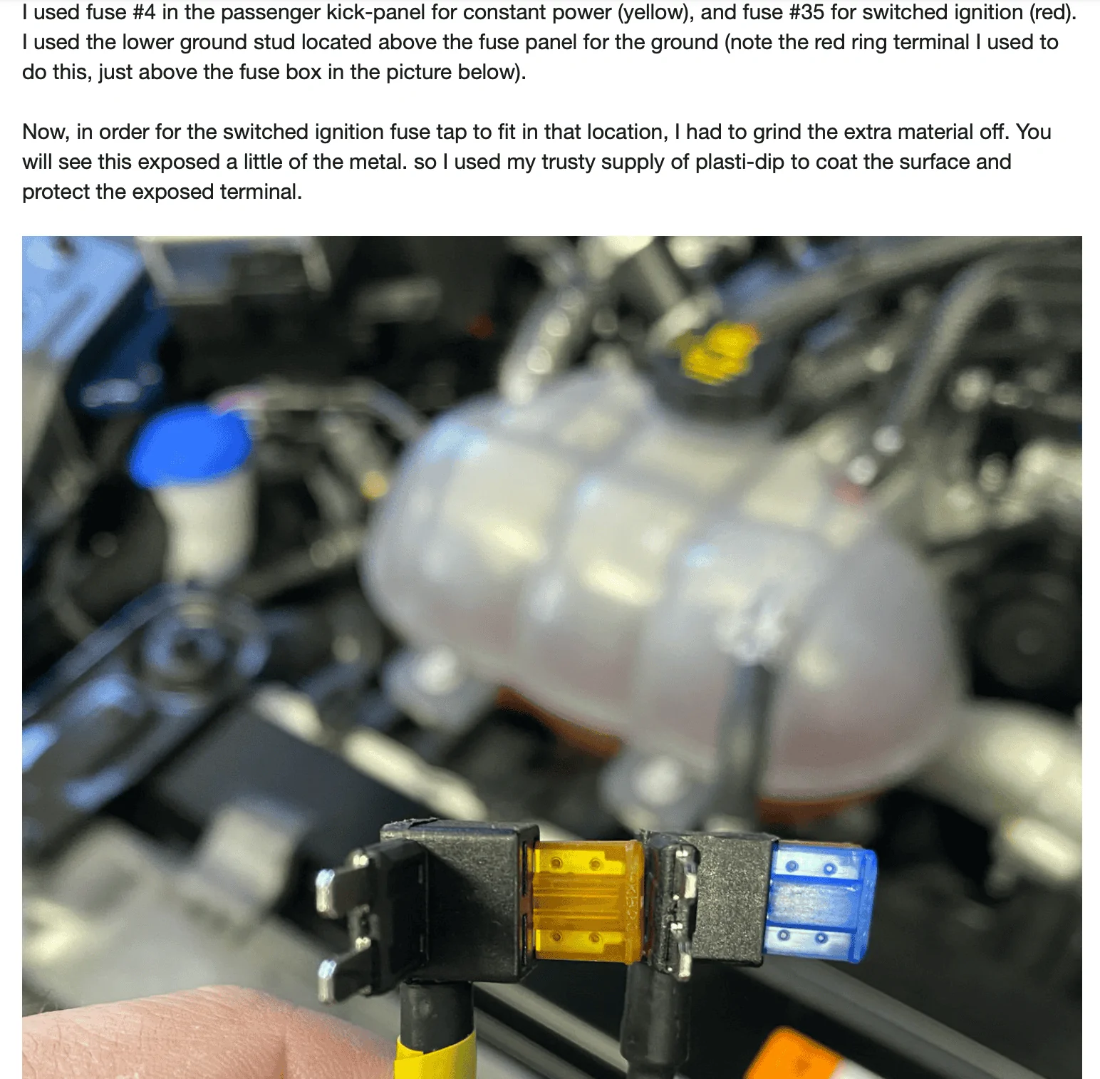

Us an "add a fuse tap" and grab switched power from the fuse box.

Thanks for the pictures and replies. I started off with #23 (the amplifier) and it was constant on. I’ll try the ones in your pictures.
