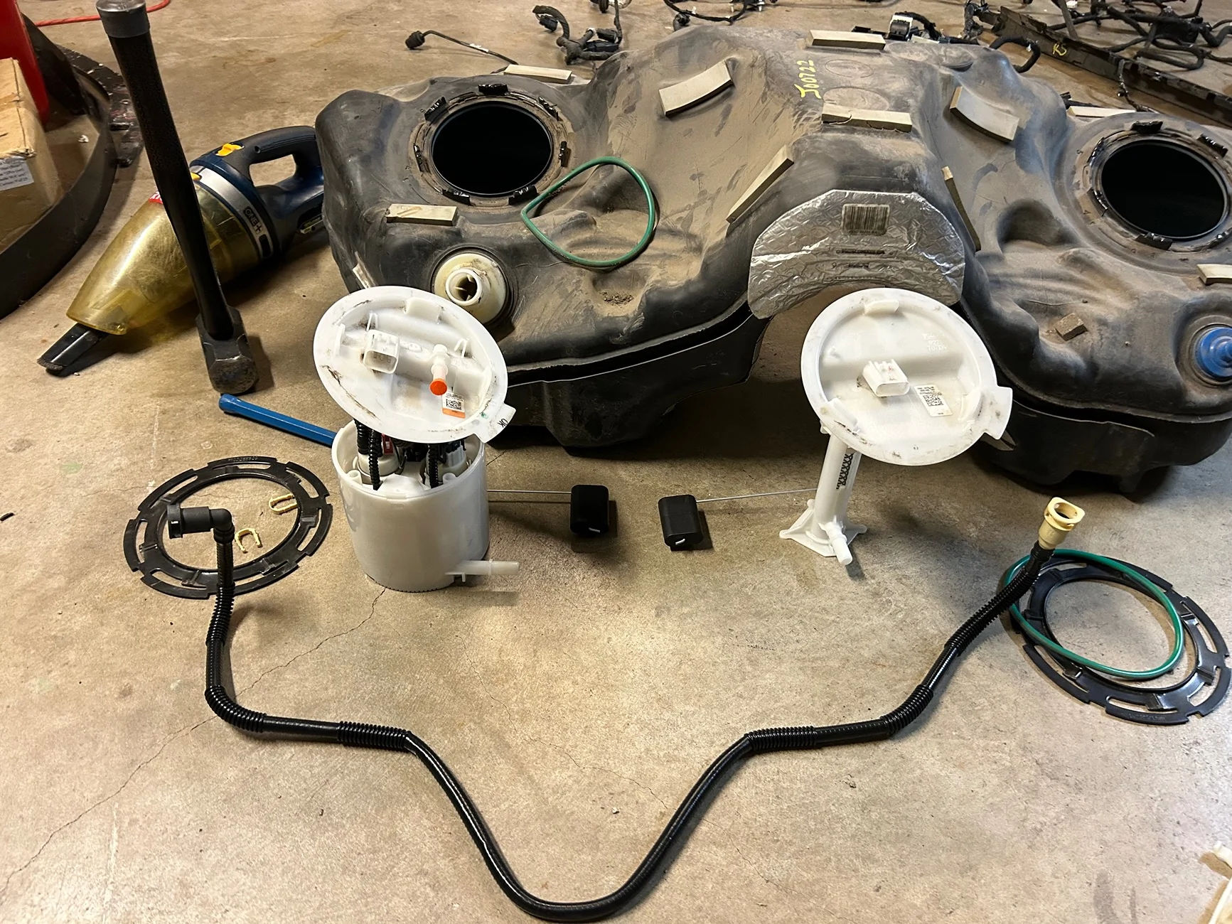

There's a connector on the passenger side hat. You can see where it is in my photo.
Yes on top, I'm asking if there are any connectors that are inside the tank. Doesn't look like it. Thanks.
