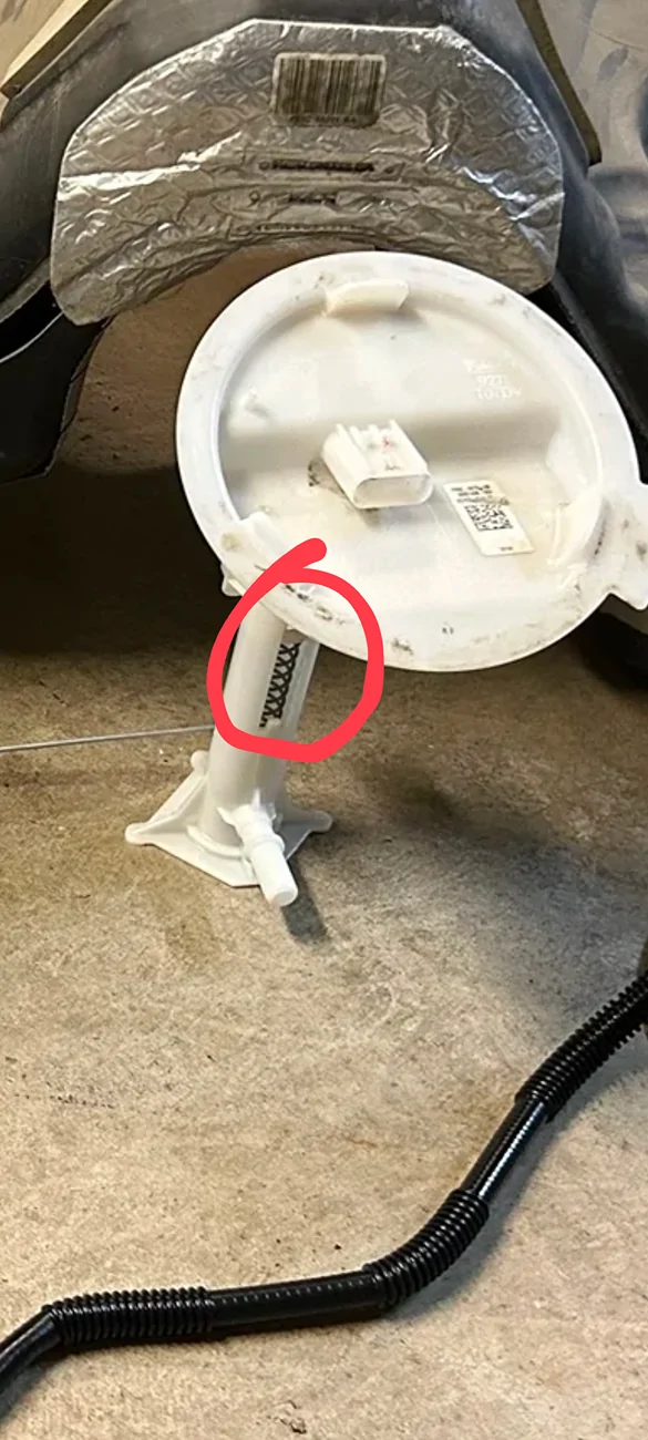

The PS is just a pickup. I suppose it's possible the pickup is plugged, but unlikely in my opinion. There are no small orifices in the PS.
What is the purpose of this spring here? From memory, there is also one on the driver side correct?
Both sides are spring loaded to ensure the pickups are as close to the bottom of the tank as possible. It spring-loaded with some travel to accounts for production variances.

Yeah the spring just allows them to sit at the bottom without actual bolts or fasteners on the bottom of the tank that presumably could leak or rust. It has nothing to do with fuel flow.

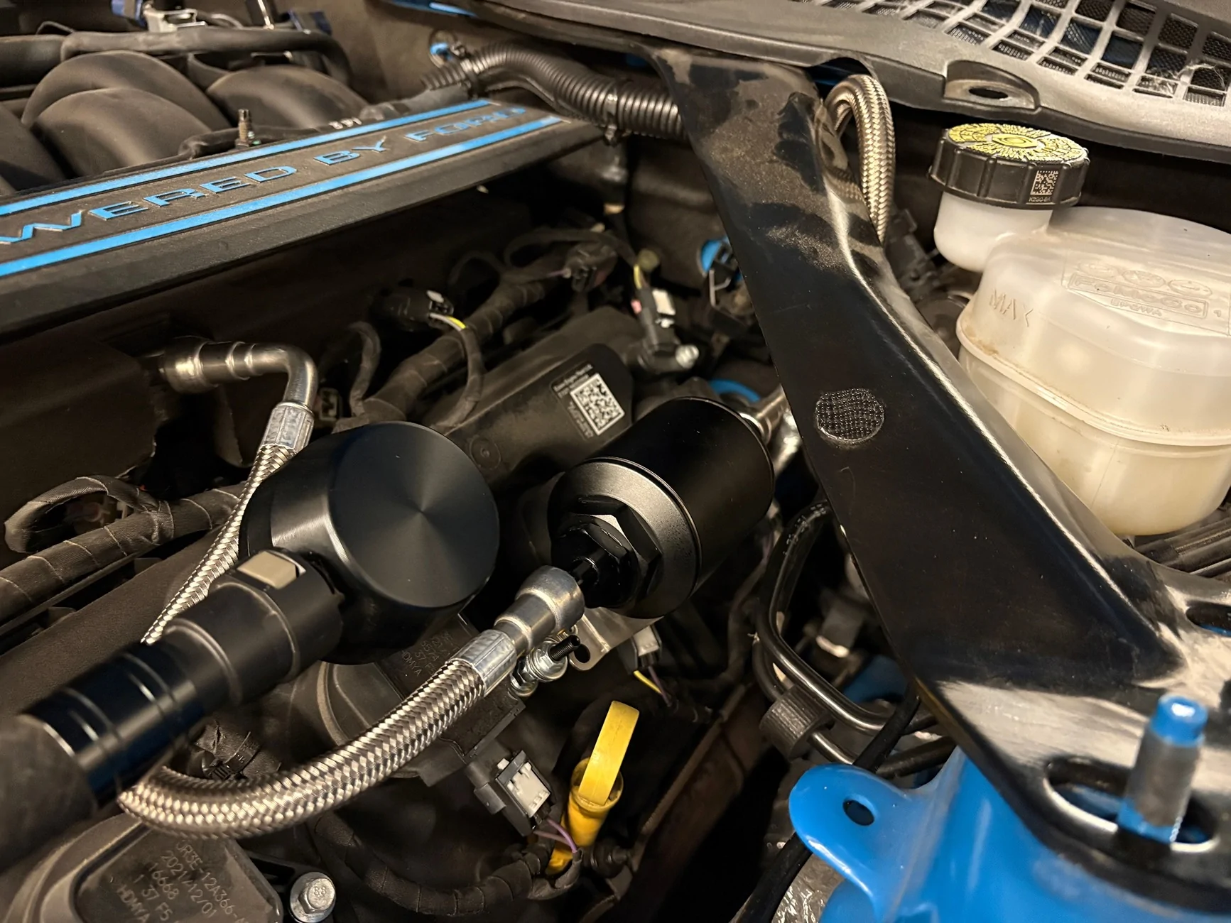

What’s interesting is that there is a tiny filter just ahead of the venturi nozzle which means the debris had to originate in the tiny space between the filter and the venturi block or from inside the block itself.

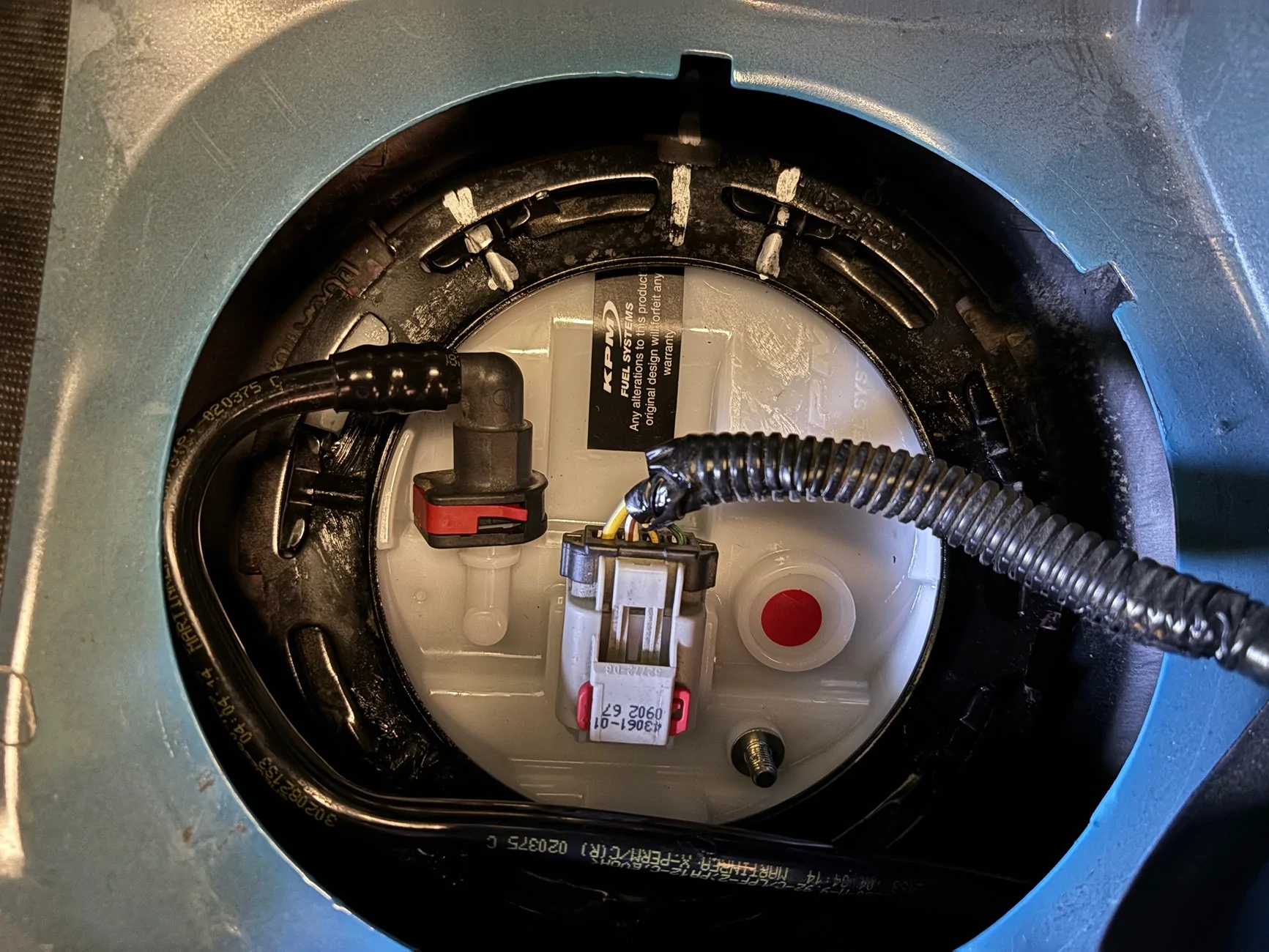

Since Ford is dragging their feet on the recall (how could they not even formally disclose the root issue one year after announcing the recall) and the OEM system design has it own venturi concerns, I took the easy way out and replaced my OEM pump assembly with the KPM800 drop-in bucket replacement, just like the Dark Horse Track Attack cars. Is there anything between the passenger side transfer line and new pump assembly that needs further attention?
If my interpretation is right, then you probably avoided the issue. However, I wouldn't run without a main fuel filter, which KPM now offers.
Did KPM revise the wiring on their lower end kits? I could have sworn that there were wiring changes in the instructions but I don't see them now. I appears to plug right into the stock connector with no additional wiring.

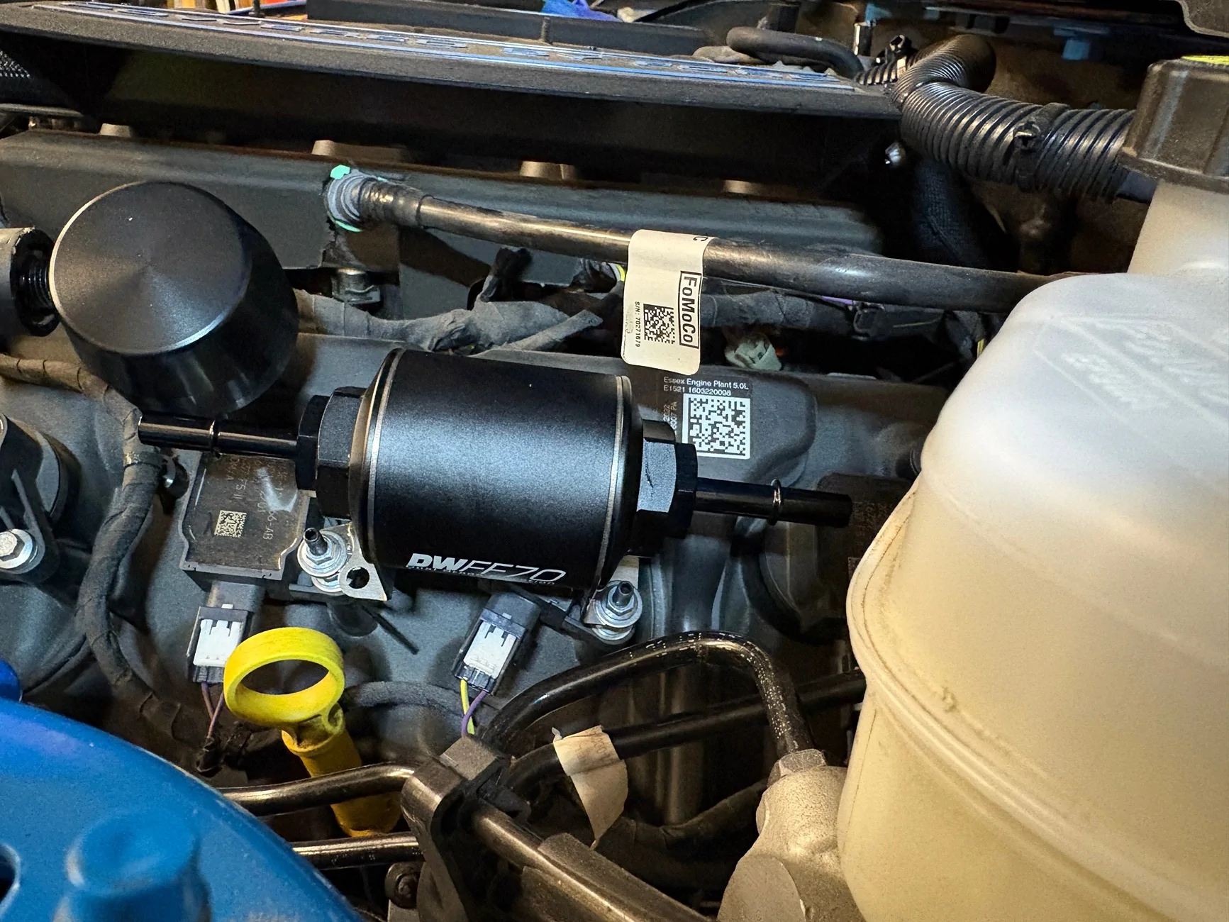

KPM's Bosch single-pump replacemt assembly is as simple as it can get and installs in just a few minutes with the biggest challenge involving removing the float sensor from the OEM assembly and installing it on the KPM Bucket. Snaking the new bucket asssembly and float sender into the tank takes some finesse but so would the OEM unit. The factory pump harness plugs directly into the KPM module and the OEM FPDM should have no concerns managing KPM's single pump.
The filter is still a concern, I'm running E85 and I originally installed a Deatchwerks Ford direct replacement fuel filter with reusable 10 micron stainless steel mesh media mounted on the valve cover but I've since been advised that the 2018+ Coyote Direct Injection system is better protected by 6 micron microglass media so I'm switching to a larger capacity Radium Filter system I'm going to relocate somewhere under the cowl brace or strut tower brace. (That's this weekend's project if I can tolerate the heat and hazadardous air polution from the Canadian wildfires.)

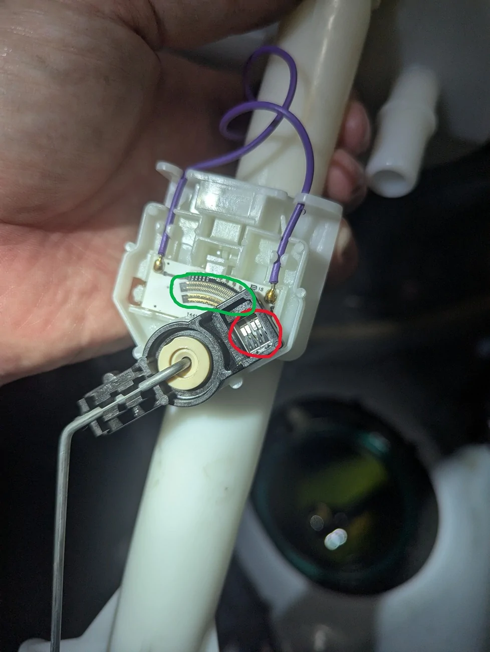

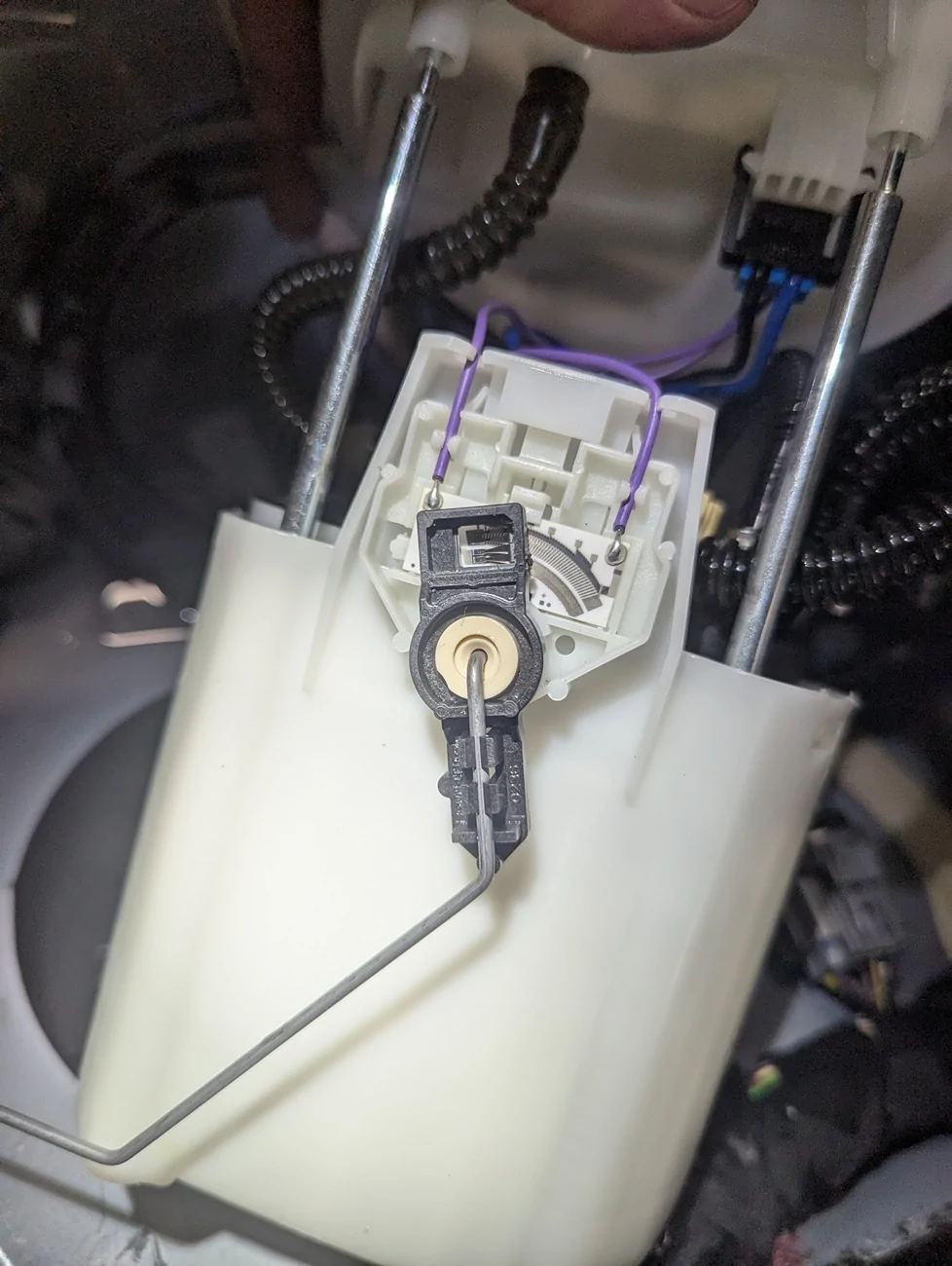

Alright so I was finally able to run the fuel down low enough to pull both sides without making a complete mess. I pulled the passenger side out, everything looked fine. Everything was in order. Same goes for the driver side. Nothing interferring with the level arms and theyre moving normally.
The ONLY thing I found that I may suspect being the issue here is the little metal tabs (in RED) that make contact with the metal plating (in GREEN) were pretty corroded. Definitely not shiny metal like you see in the picture here. I should have taken a picture before I brushed it a little, but I didn't think of it.
I ran the arm up and down many times with a little bit of pressure on the metal tabs and it cleaned them right up. Both sides were like this. I hope this is the issue. Running e85 for a long time and the car being nearly 7 years old would make me think this may be it. I only have 23k miles too, that means gas sits in the tank quite often.

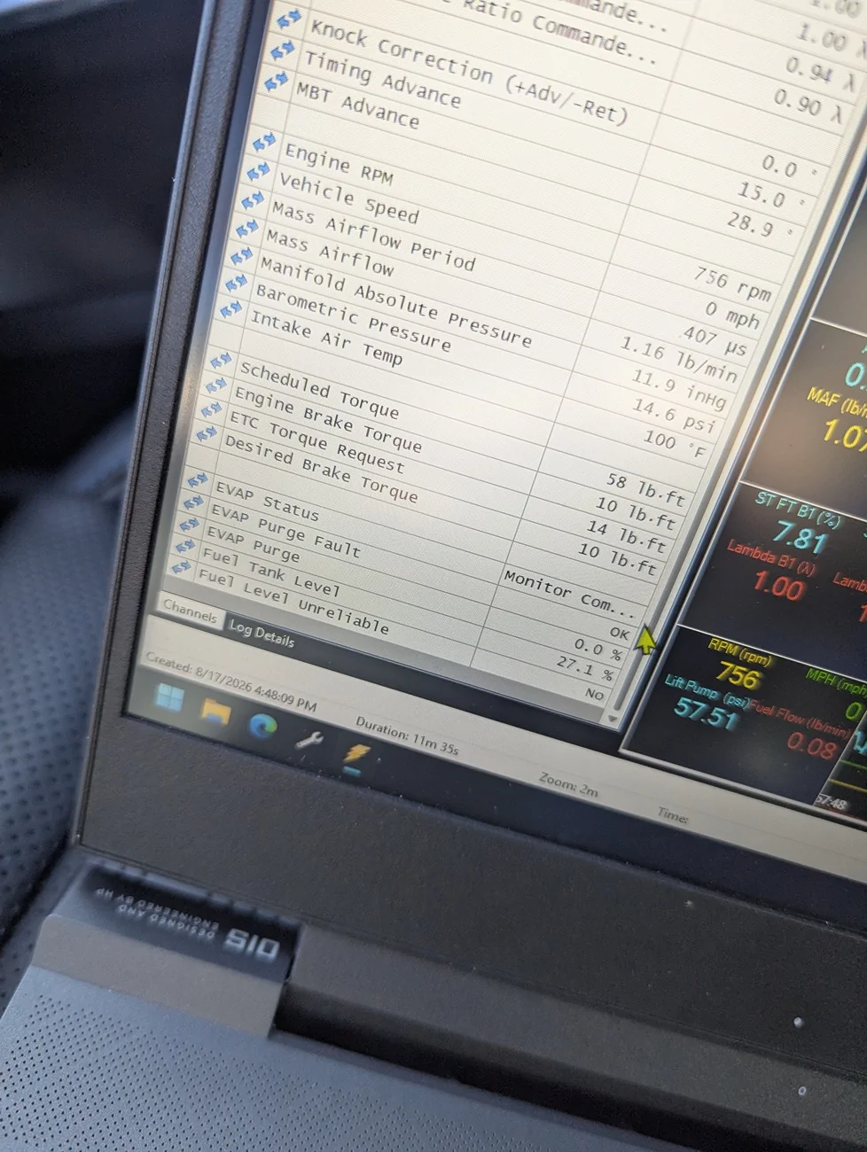

Update:

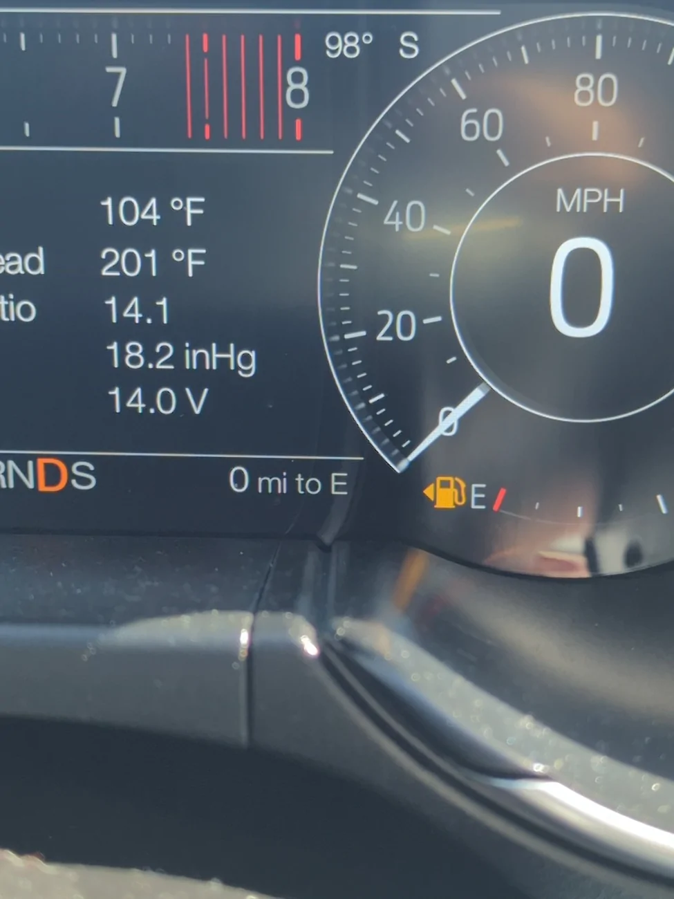

I wanted to run the fuel low again to see if the last issue presented itself again. It's even worse now. I was driving and it went from 60 miles till E to 3 miles to E in a split second. The VCM scanner was showing roughly 25% left. It was correct. I continued another 5 miles to work on 0 miles till E.
Does anyone know exactly how the VCM scanner pulls this calculation? Where from? Why does it differ from the cluster. Is i because it runs through the cluster for the miles till E calculation?
Either way, this points to a bad sender, correct? Question is which side?

Driver side handles the E-1/2 tank so I would think that side is the issue.
Mine has been good all year after I fixed it and just started acting up again 3 days ago... tomorrow or the next day I am going to pull my backseat and see if the sending unit possibly fell off the bucket. So annoying. Doesn't seem very snug on the Fore bucket, wonder if I can use some type of metal zip tie to secure it in place better?...
