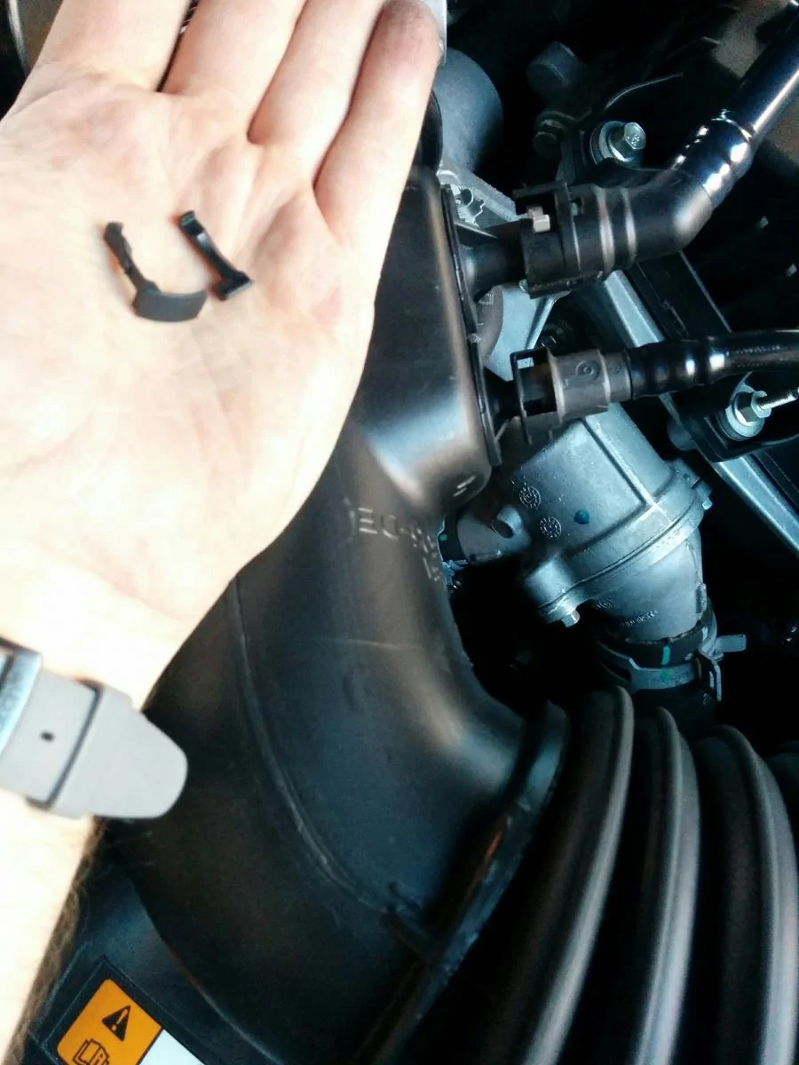

The first problem I ran into is how they say (and show) to remove the tubes connected to the factory intake for the crankcase breather, sound tube, and whatever that third thing is.
The instructions say to remove the plastic clips but you do NOT want to do that. Instead you want to push in on the clip and remove the hose. I didn't know that though, and following the instructions I spent about fifteen minutes carefully removing one of those clips. Once I got it out I was just thinking "this can't be right, I almost ruined this thing!" and sure enough, one peek at a competitor's intake installation video revealed the easy truth!
Here is the pic PMAS includes in the instructions. Don't do this!
So, if you happened to have broken that clip... :doh:
Where do you get another one?
TIA-
4V Mayhem
May 20, 2016
1,368
529
US
2015 Mustang GT Premium M6
Any parts store will have it. You get a set of like 5 or 6 for about 3 bucks. They are 3/8 Ford vacuum thingies.
