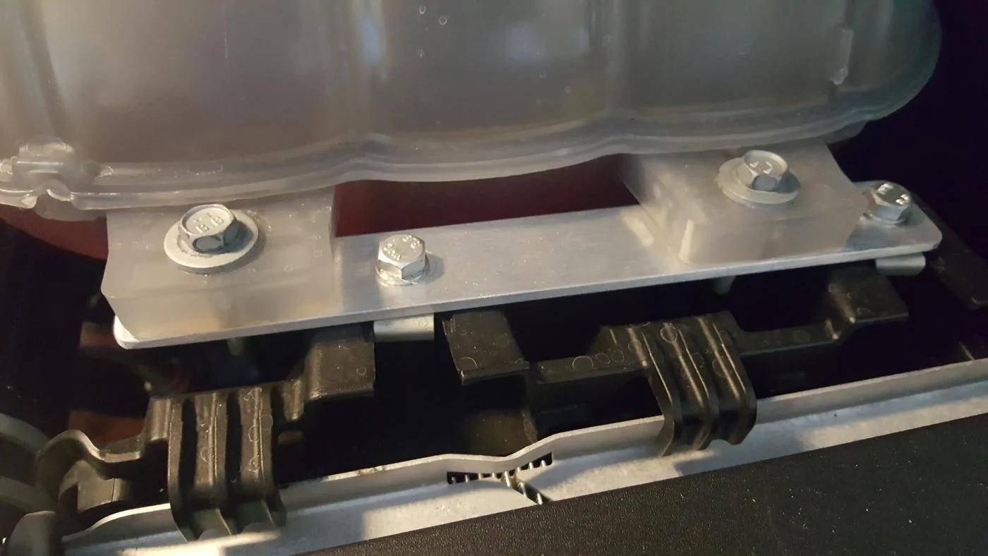

Didnt realize you need to move the coolant res. For this monster. Any body have pics or tip on install for that part? The instructions are useless

I just unbolted the coolant tank and attached the bracket to it first using the bolts included with the kit. Orient the bracket so that the right most hole is the one closest to the edge and the coolant tank will attach to the 1st and 3rd holes (from left to right). Attach the bracket to the original location with the 2nd and 4th holes using the bolts that were originally on the car. Hope that makes sense.

Put the new bracket on so it shifts the coolant reservoir towards the left if you're looking at the engine from the front...

Stole this from the main PMAS thread.
