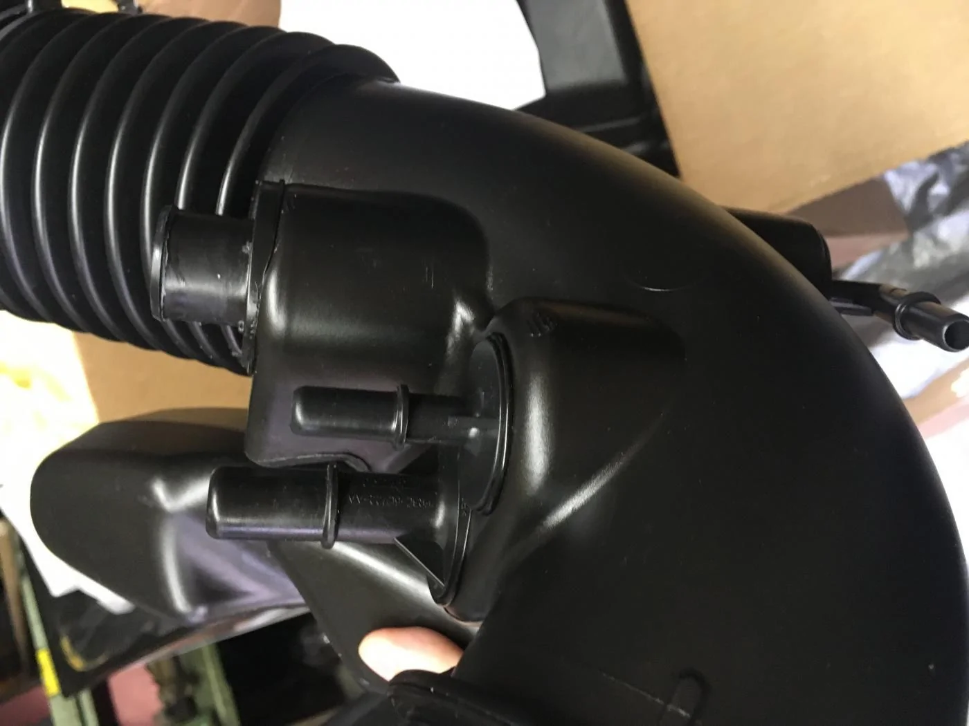

Doing this install today and almost finished. The problem is I have three places for hoses and only two hoses to connect this doesn't include the sound tube connection which is capped. What am I missing?
[/URL]In my photo of the '16 compared to your '17 intake, it looks like the smaller one is missing. I would just see which of the two on the aftermarket intake is closest in size and close the other. Looking at the pics, plug the smaller of the two.So found this with regards to the 17's,
"Tech Tip: For 2017 GT Mustangs manufactured after 9/2016, the vacuum for the CMCVs (Charge Motion Control Valves) is no longer picked up from the intake tube. This will require a plug to be used with the unused port/fitting on your new cold air intake tube when installing this system. The production date on the vehicle (month/year) is located on decal in driver side door jamb."
So question, does it matter which port I plug? The smaller hose will fit either of the smaller ports. I prefer to use the one under the large port but think originally it should have gone to the other. I prefer this one as the other has an extension that is suspect, to begin with. Any advice is appreciated.

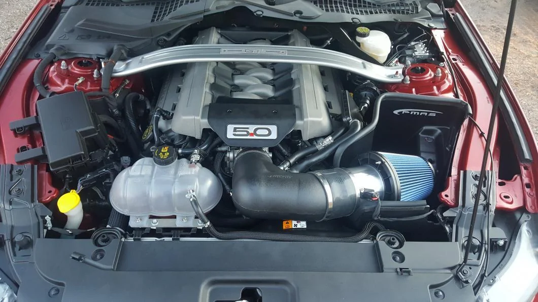

most installs i have seen guys going with the tube rotated so the MAF sensor is inside the box. not visible at all from the top. something about better fit and less stress on the wires.I definitely agree the instructions were annoying and they could've just added the little washer needed.
Other than that, the intake is great. I installed mine exactly as shown below on American Muscle, it's at around 10 o'clock looking from the drivers fender:
I did it because I was worried about getting the clearance wrong and crushing the MAF sensor with the hood.most installs i have seen guys going with the tube rotated so the MAF sensor is inside the box. not visible at all from the top. something about better fit and less stress on the wires.
I just installed mine in the box and your correct, less stress on wiring.most installs i have seen guys going with the tube rotated so the MAF sensor is inside the box. not visible at all from the top. something about better fit and less stress on the wires.
I'm thinking I'll just rotate mine down like that. Wasn't too worried because it is still much lower than the coolant reservoir and the huge intake elbow.most installs i have seen guys going with the tube rotated so the MAF sensor is inside the box. not visible at all from the top. something about better fit and less stress on the wires.
