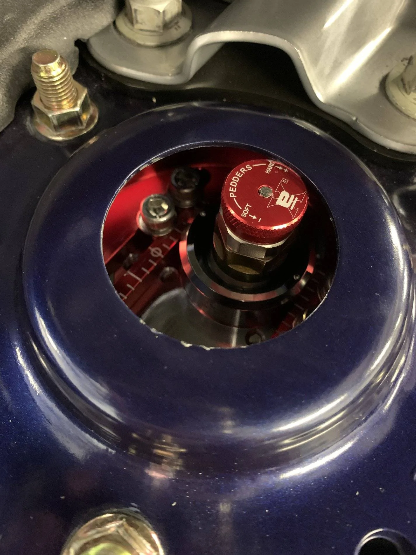

So I got the kit installed today, and what I was told was correct, you do not have to cut your strut tower to access the bolts. But with that being said you have VERY little movement with the hole being so small so I’m actually going back to cut it. Found a tool by Vorshlag to make sure the cut comes out clean.

I opened up my strut tower holes

Over all I like the kit, it doesn't ride as rough as I'd expected, and I like the fact that you can adjust the height and stiffness of it. I didn't like the fact that I had to cut the strut tower openings, but this isn't the only kit that you have to do that way apparently. On a 10 scale I'd give it a solid 7.
