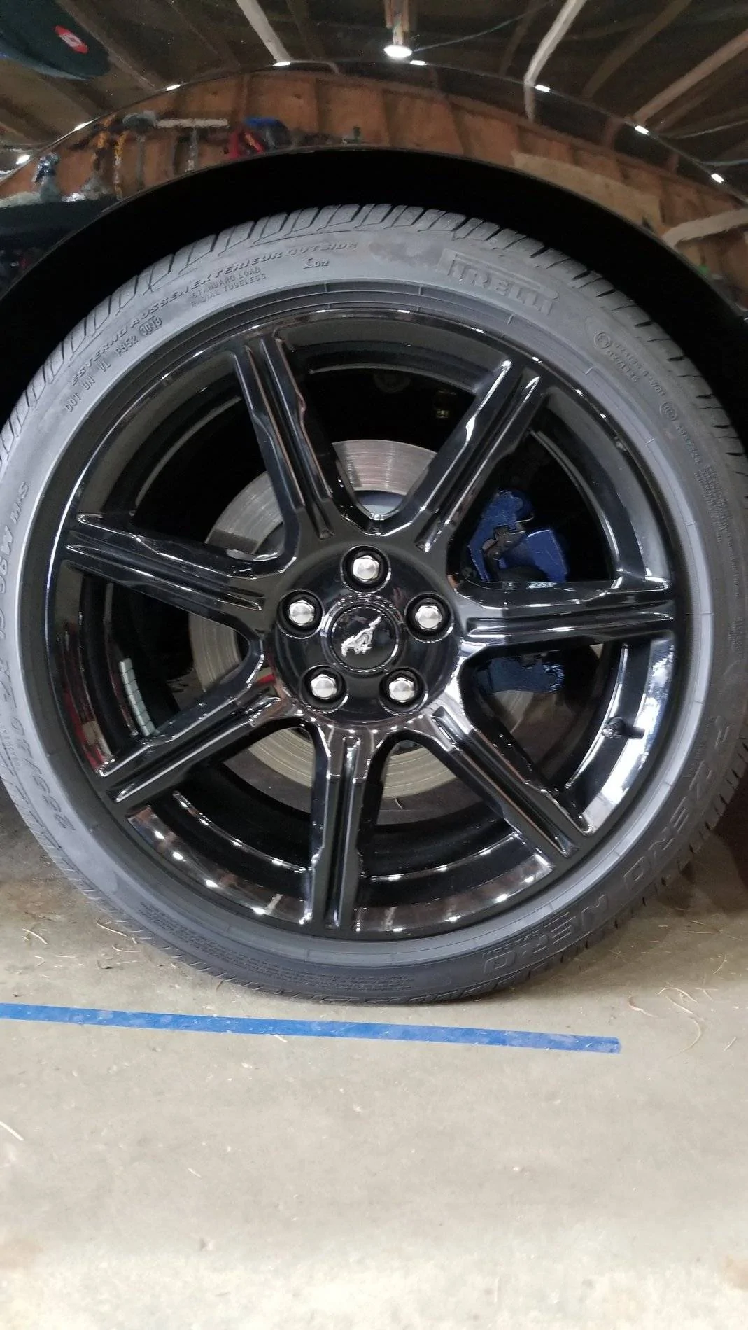

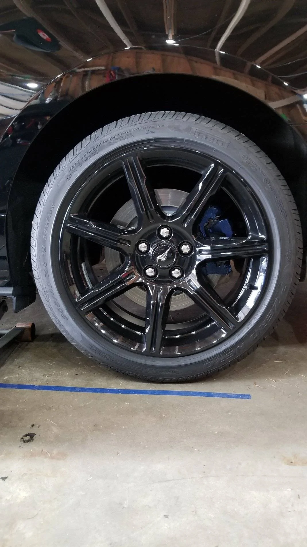

so right now i'm at 27 1/2 sitting, and 29 1/2 with weight taken off the rear, so sounds like im in line with your suggestions.
This is my first car with coil overs, so it could just be me getting used to it, on the roads here in Mass.
Pic attached
