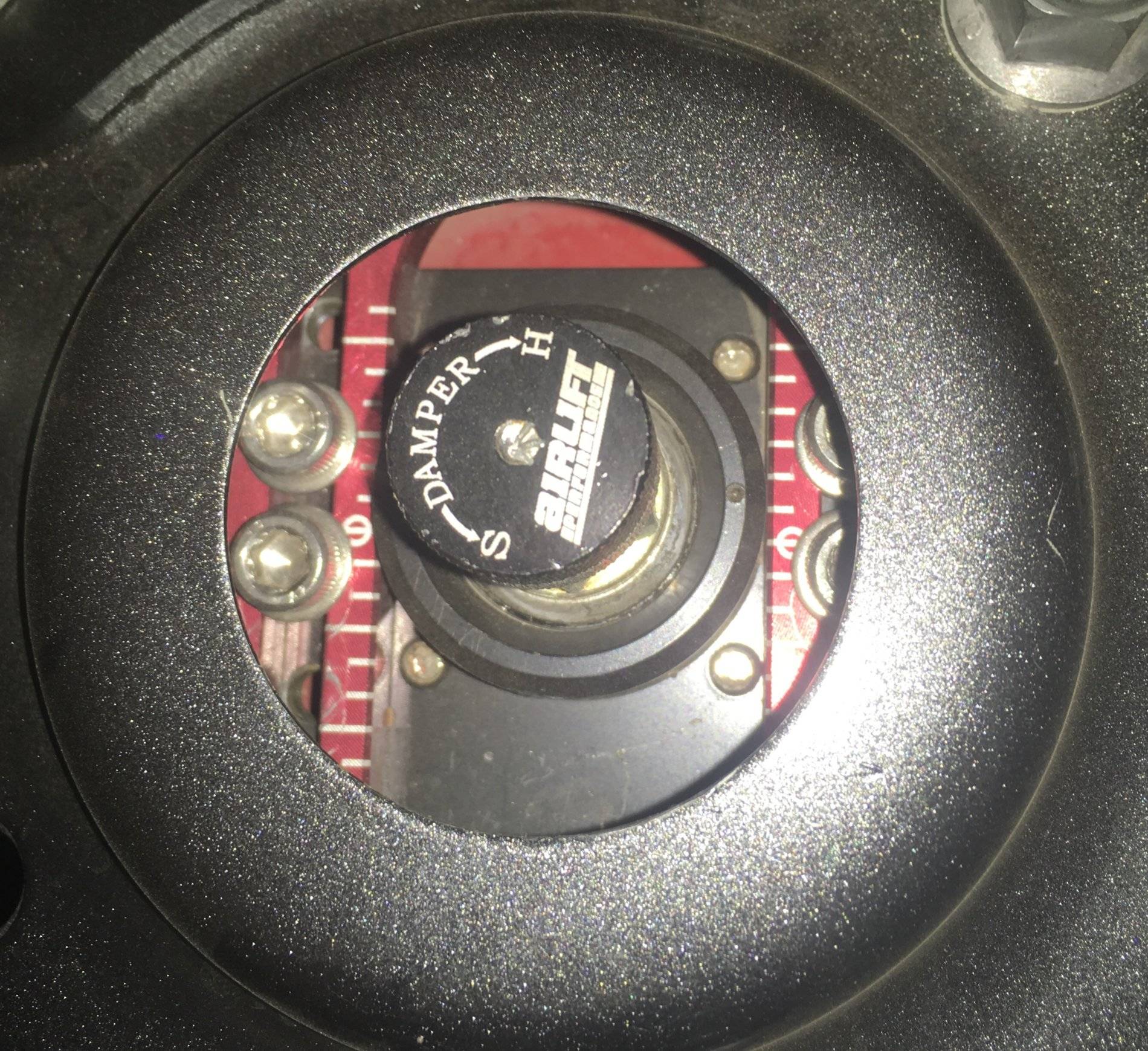

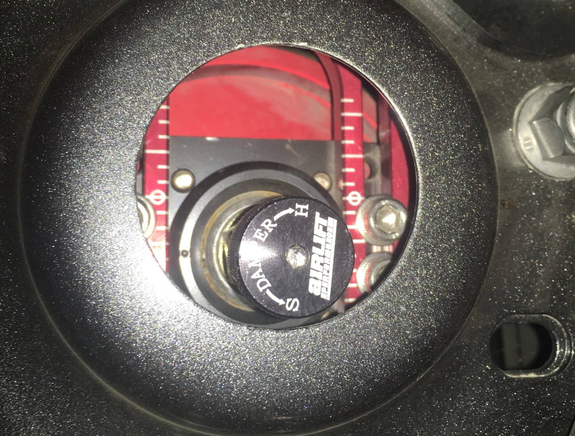

@Steven9194 rather than reply to your PM, I thought it might help a few more people if I share this publicly.
In both pics, the bolts have been moved to the inner holes.
Top pic is how you’d set them for more or less neutral camber, easily accessed.
Bottom pic is pushed out for basically max positive. Note the the installer failed to relocate the outboard bolts to the inner holes, hence they’re a bitch to tighten....
It’s a simple game yet so many get it wrong. Then they start hacking their car up because someone told them “it’s the only way” :punch:
NB: Airlift use BC racing dampers/camber tops, as do Pedders. Ergo, your setup would be identical to what I’m showing you.
Very helpful. Thanks for posting.
Definitely reply to this thread with your thoughts after a install. @Steven9194
