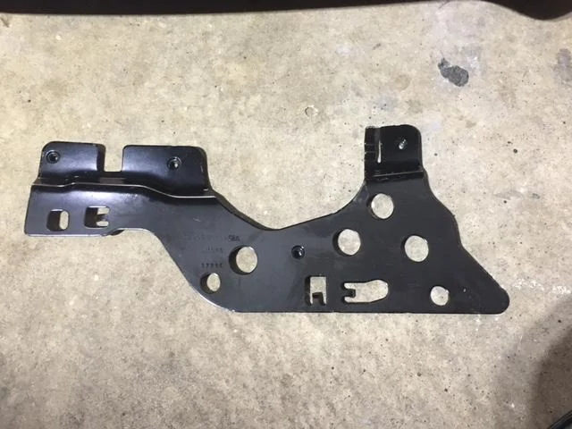

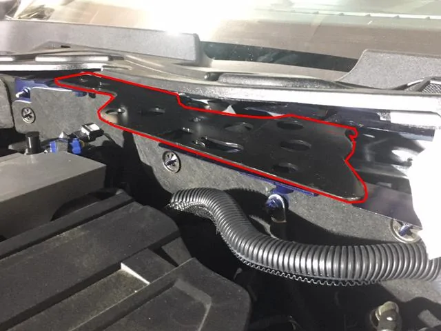

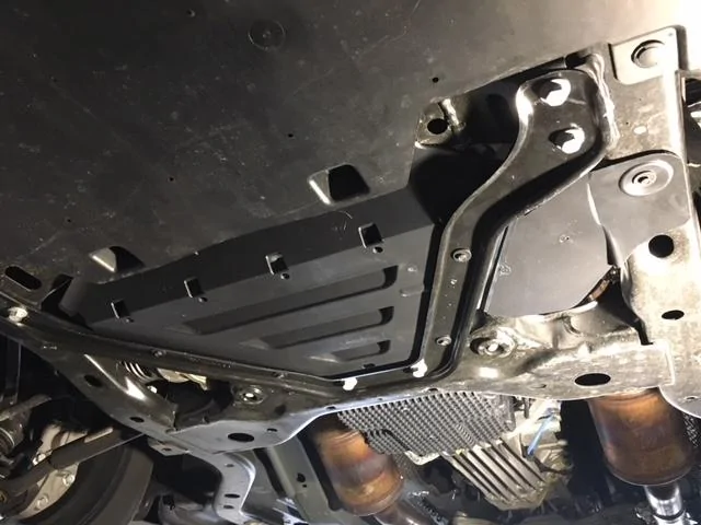

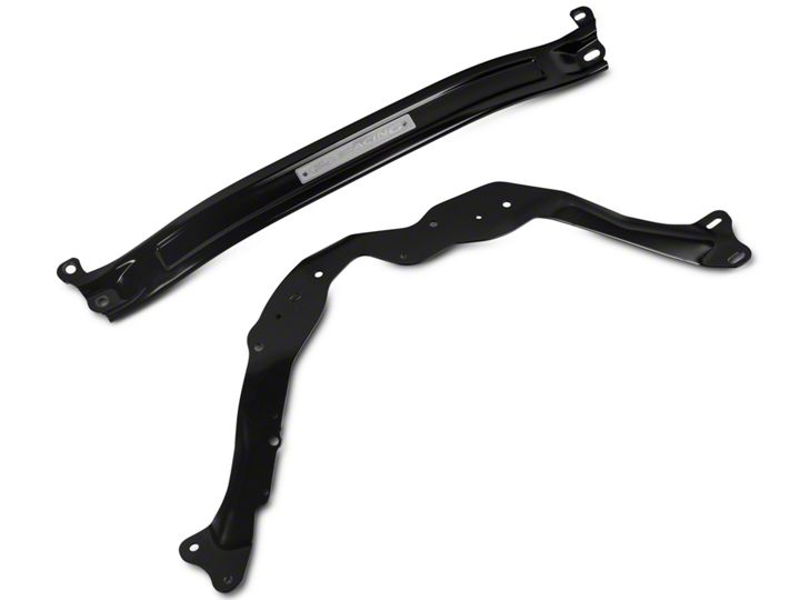

Well the strut brace by itself is not very useful. You need the two K braces and the firewall connector that are mentioned in the link above in order to really get anywhere. Those parts (standard on the performance pack) make a very significant difference. I have all of that plus what you listed, and it didn't really come alive till the plush springs and dampers were off. The bracing really, really helps with consistency and not feeling like the front is a noodle, but the car is still way too soft.

I ordered the bmr k brace, what other k brace are you talking about? The Ford one? Do you have a link?
-paul
Last night I ordered the bmr k brace, cradle lockout, jacking rails and an sr performance strut tower brace.
