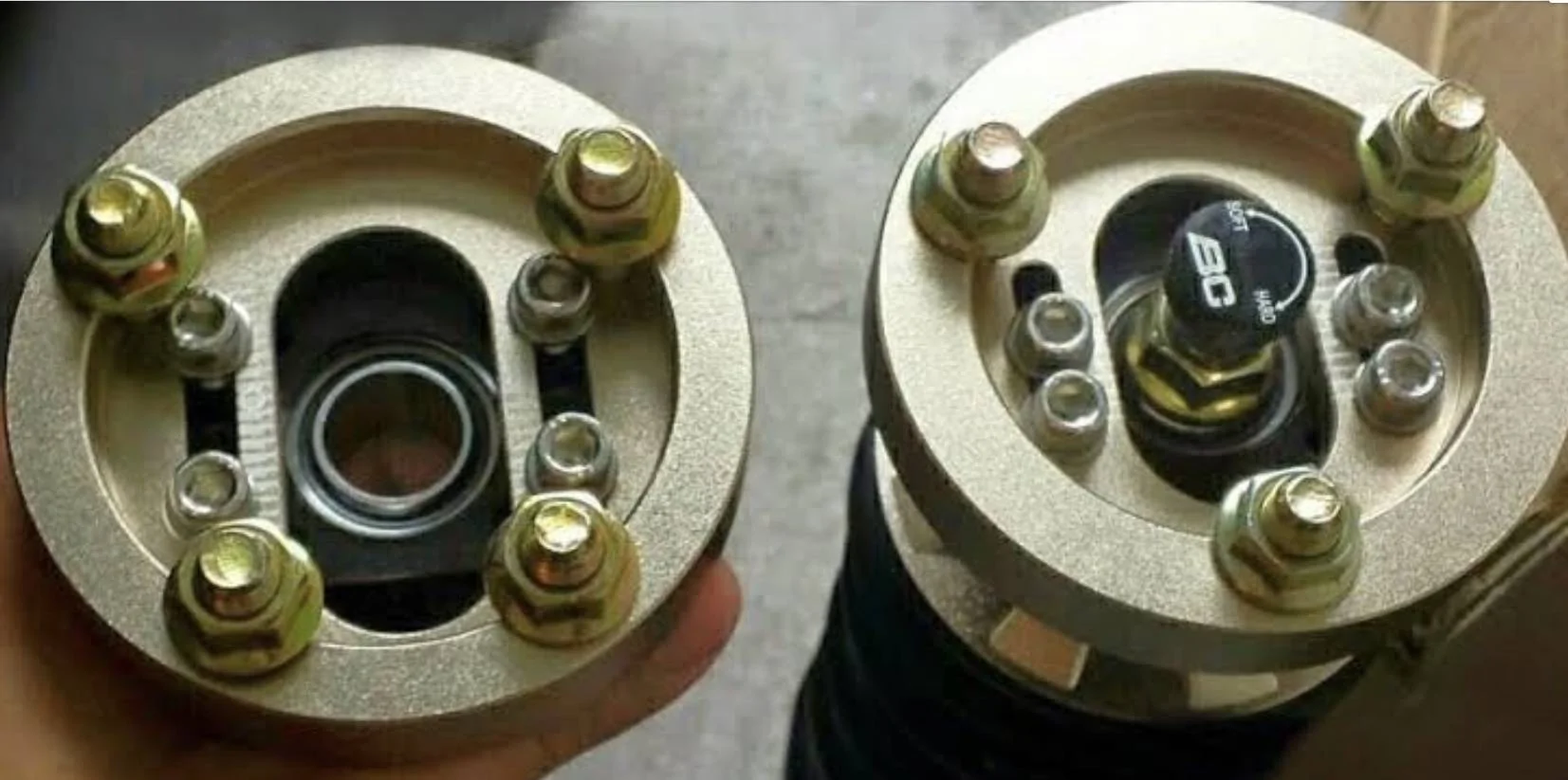

In order to adjust the camber you will need to either remove the assembly from the car or cut a larger center hole in your tower.
I keep seeing this thrown around and it’s quite simply not true.
The camber tops have 8 holes per side for the adjusting bolts (as shown below)
They come supplied with the bolts fitted at the outer position.
Shift the bolts to the centre position.
Want more negative camber?
Remove the two inner bolts entirely.
Slide camber top inward, place the bolts in the holes that are now easily accessed.
@Steven9194 just bear in mind that the Pedders setup is a rebranded BC Racing setup.
I’d assume the valving and spring rates may be different though.
I know plenty of people running the BC racing gear with zero issues so far.
Just remember to double check the tension on all the bolts and particularly the lock rings, prior to fitting.
So just to verify, you’re saying you do not need to cut the tower, or remove the entire assembly to adjust camber?
Burkey
Feb 9, 2016
87
5,524
3,512
Australia
2016 Mustang GT
Correct. I’m running the Airlift kit which uses identical camber tops. You can adjust the camber to the extreme in either direction if you remove the bolts and place them in the correct holes (the correct holes being whichever ones are accessible once the camber is set).
The main trick is a ball ended Allen key.
