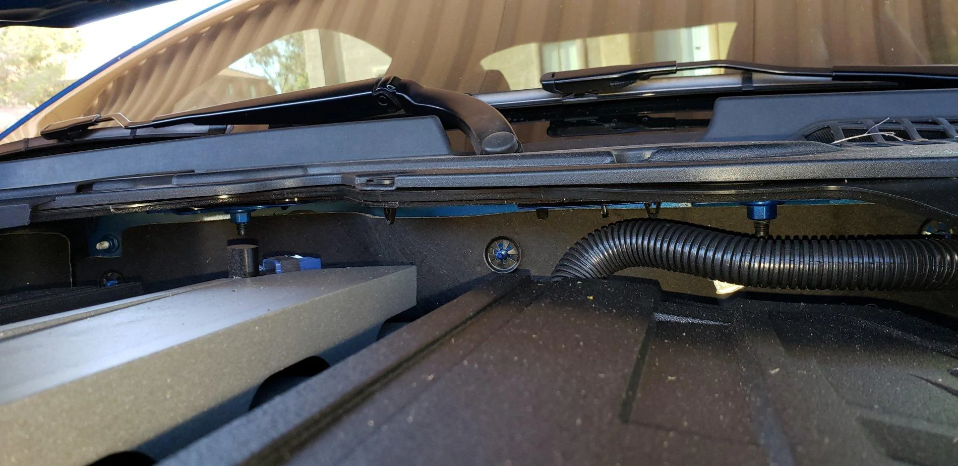

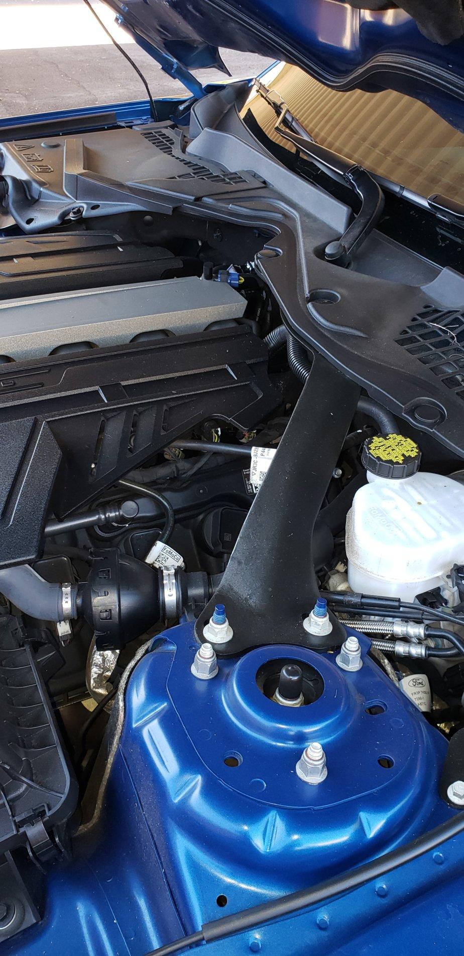

I think i have the upper brace already
almost absolutely sure i dont have the bottom one, which i found for under $50. Im not sure if the firewall connector is there with the upper brace.
-paul
-paul
Yes it appears you do have the K-brace and firewall connector (they come together). That's good. The lower one adds some stiffness there and makes oil changes quite a bit easier.
