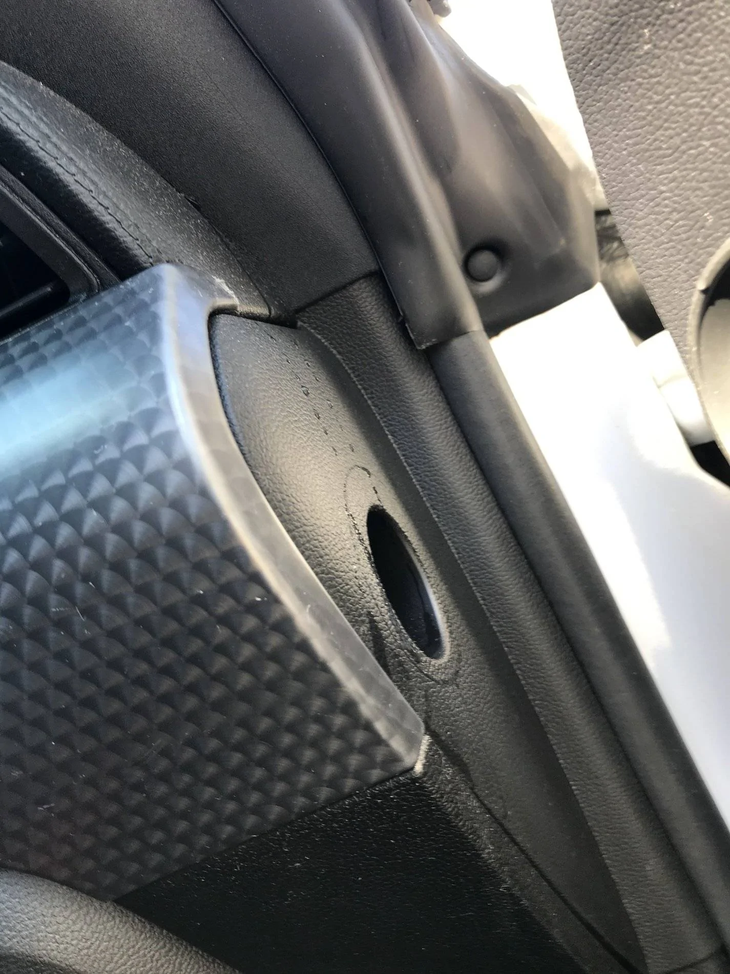

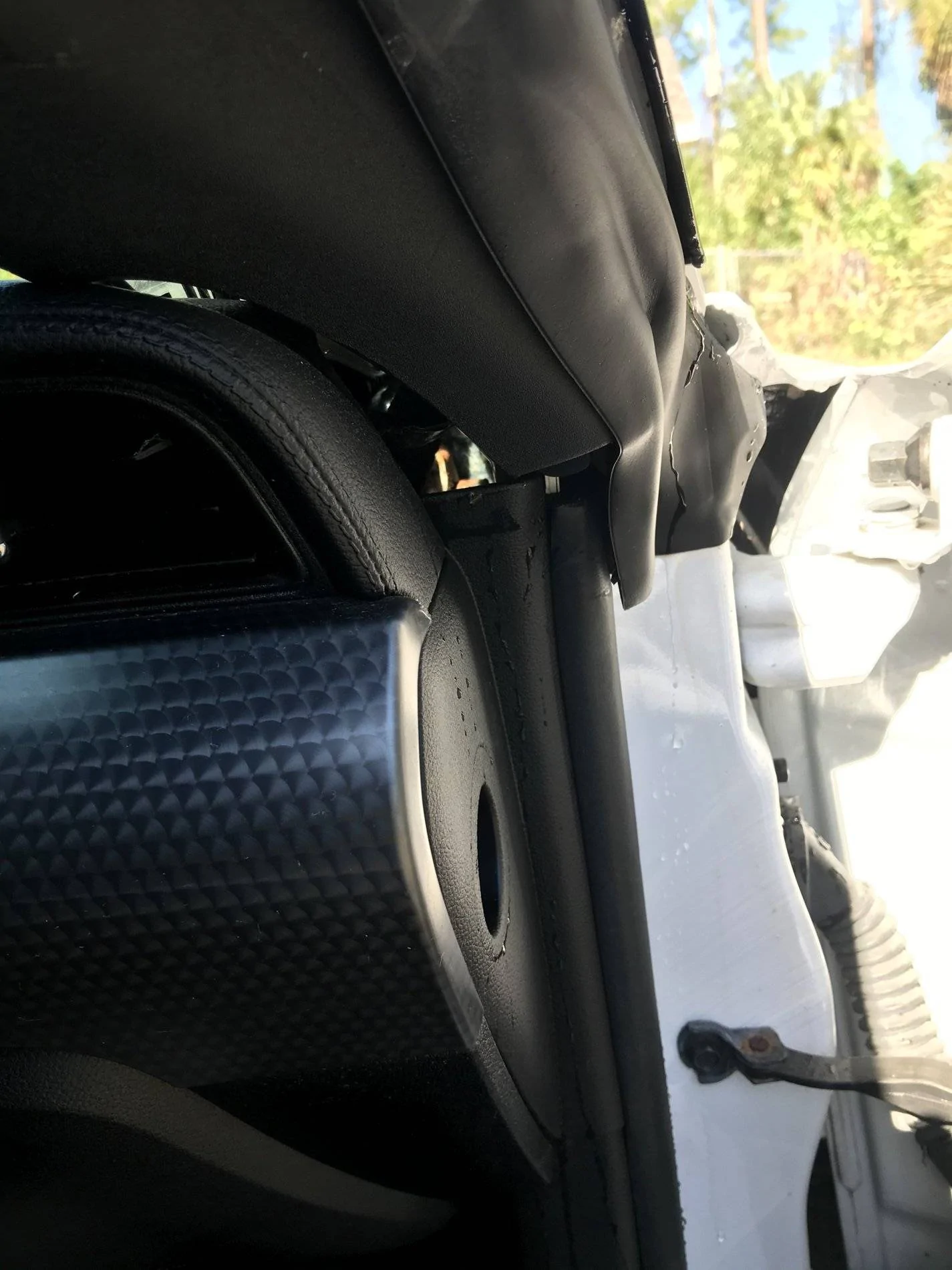

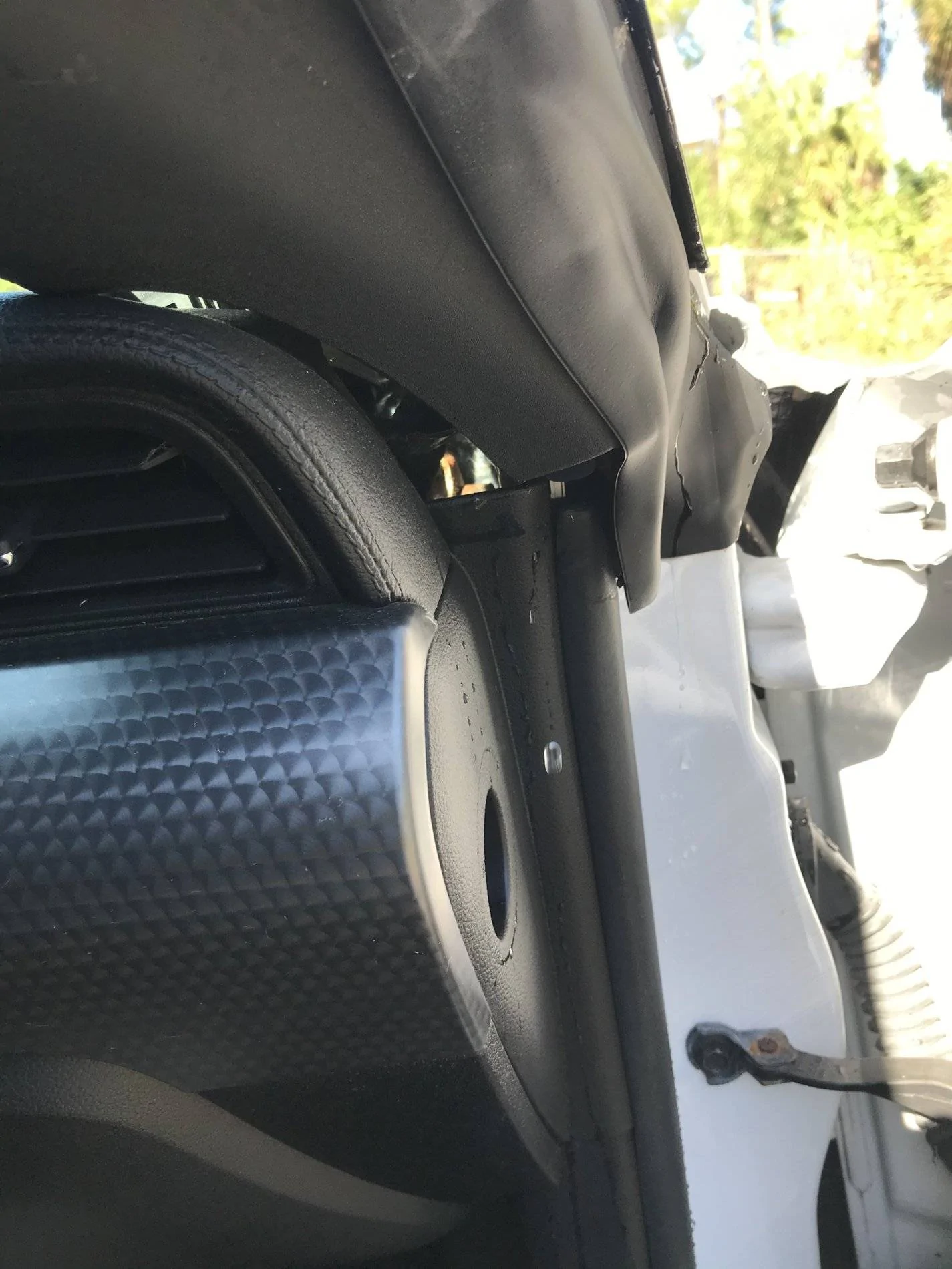

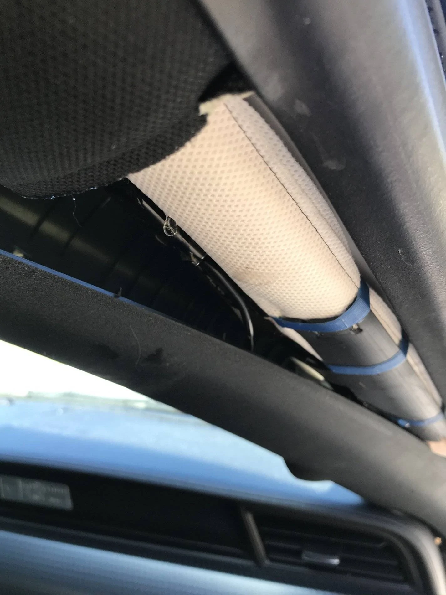

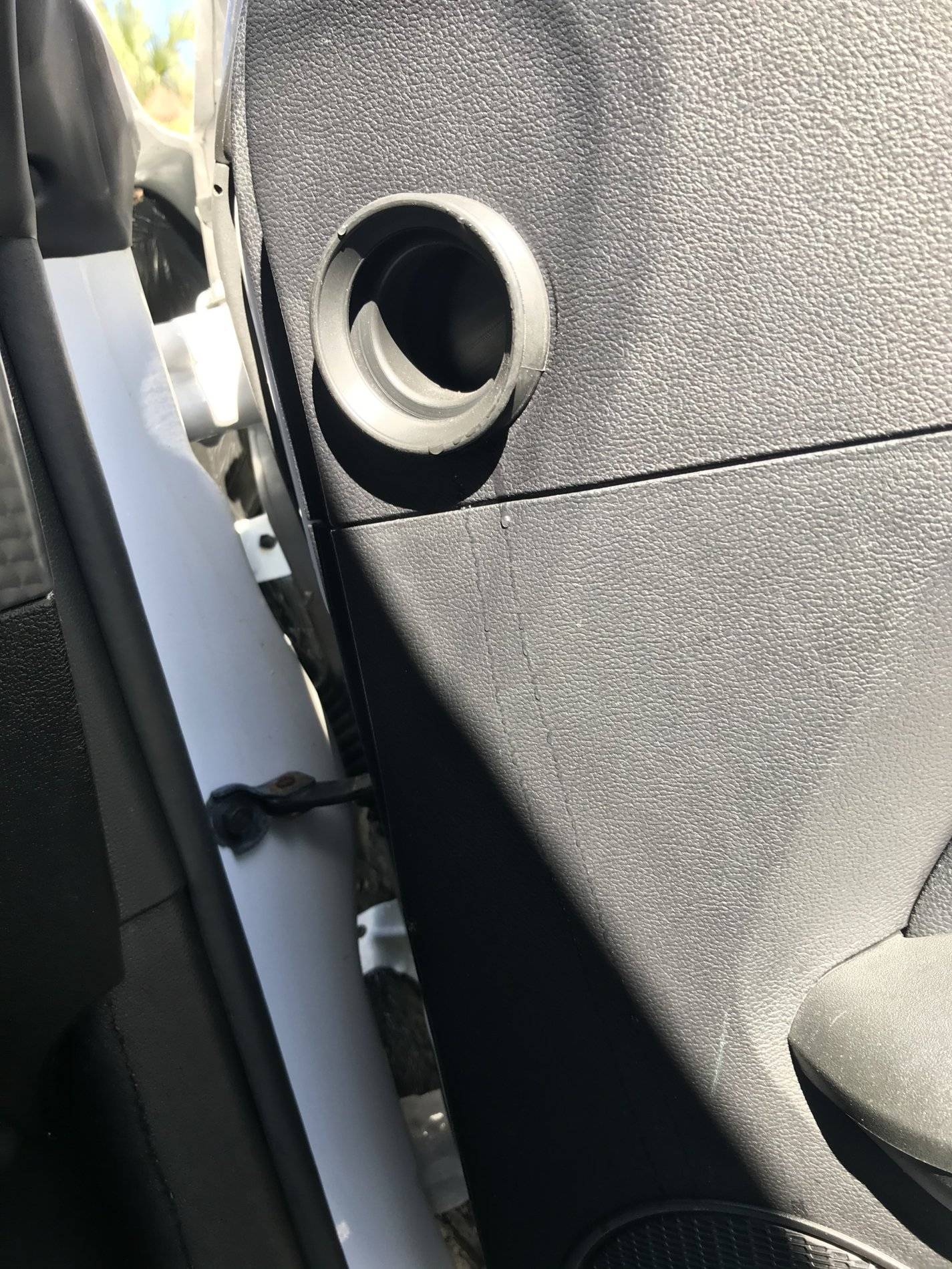

Well I sat in the car after hosing it down really well. A trickle started to come in from around the side of the dash where it meets the door panel and dripped on the floor. I pulled the a pillar trim off and found that its getting in somewhere between the a and c pillars as the headliner behind the a pillar trim was wet too. I don’t see how it could be getting in around there though. Any thoughts?

Possible leaky windshield seal, or some other sealed joint in the sheet metal up near the top RH corner of the windshield.
