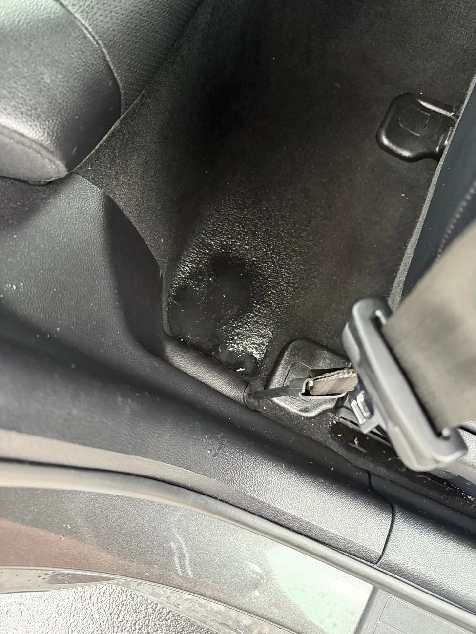

Hey everyone, I have a water leak that seems to only occur after rain leading to soaking wet carpet on the passenger side. I recently put rubber plugs in the A-pillar body holes and it still flooded after the next rainstorm. I have checked the passenger side cowl drain (under the battery tray) and will check the driver side one today. I have also replaced the passenger side weather strip that seals the passenger door window. I noticed some water dripping from the passenger rocker panel so I removed that but could still not find any source of the water intrusion. I haven’t noticed any water dripping from the windshield and everything seems dry in the interior apart from the passenger carpet. Any other common places for water intrusion that I should check? 2020 Gt Coupe
