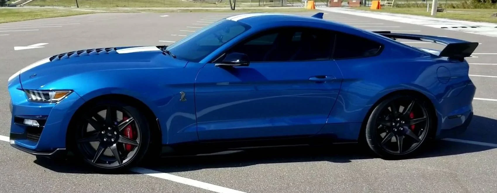

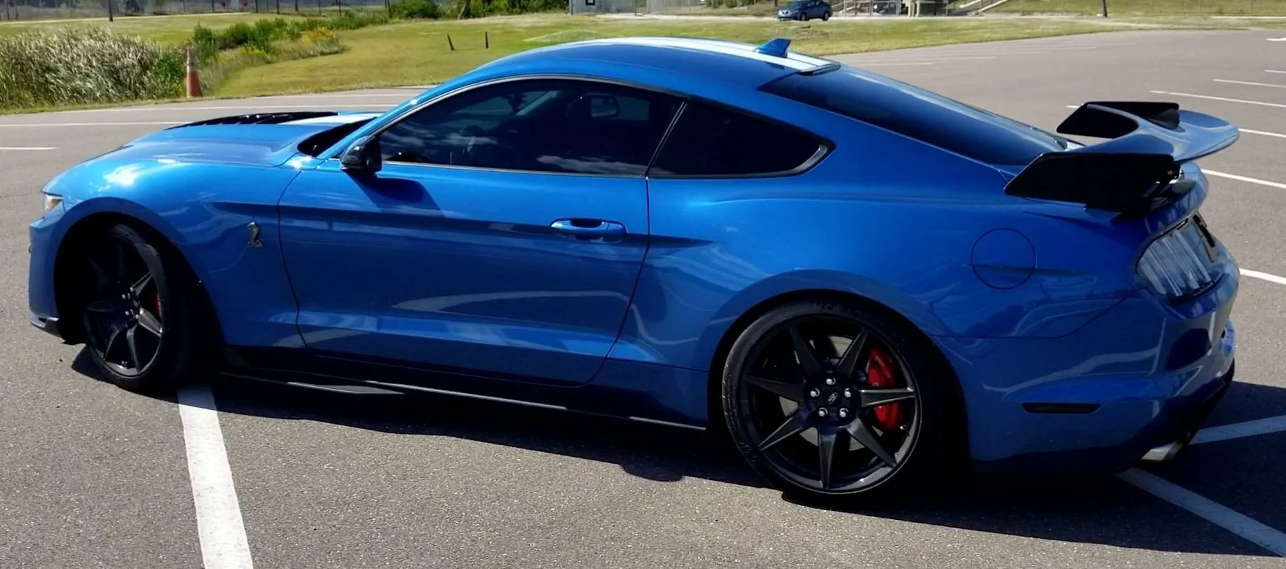

Yep, definitely agree. I try to keep the visible seam as clean as possible. Also I've noticed the films must have evolved over the past 5-6 years compared to my old Viper - with mine it's _really_ hard to tell the difference between covered / non-covered panels.
The partial rear quarter panel seam won't even show in pictures:
Wow that's really impressive! You definitely can't see seam in picture. I didn't realize the ppf had a slight tint to it though. Really don't want the color to be different where ppf is.
But again, I don't see any difference on your car. Looks really good!

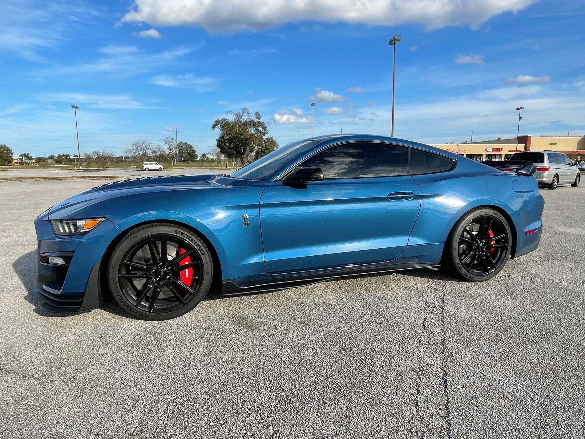

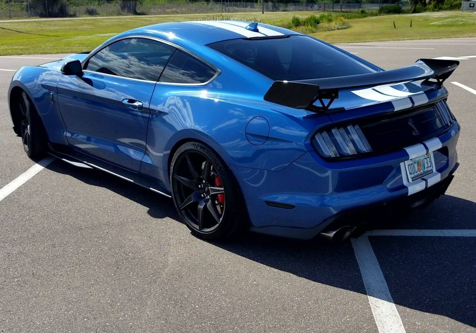

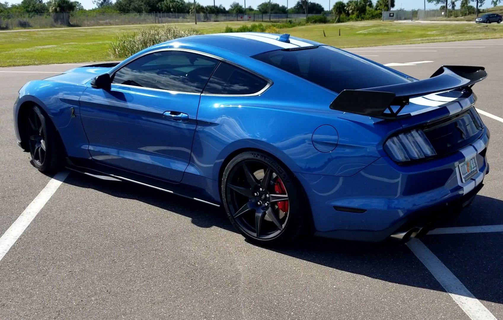

My car is FP blue, and did a "partial" (2/3rds) PPF from front to rear. Full front, roof, doors, A pillars, and the rear panels. You cannot see the seams in photos and have to point them out in sunlight. Car was also ceramic coated, which brings the shine, but not necessarily armor. While PPF prevents chips, it's not 100% and I have several small chips already, mostly in the front and on the hood, which are visible when looking for them, much to my dismay. Without the PPF, the chips would likely be significantly worse.
These pics were shot on a mostly sunny November day in Florida; you can follow the sun tracing the body panels right over the where the PPF seams are located.
