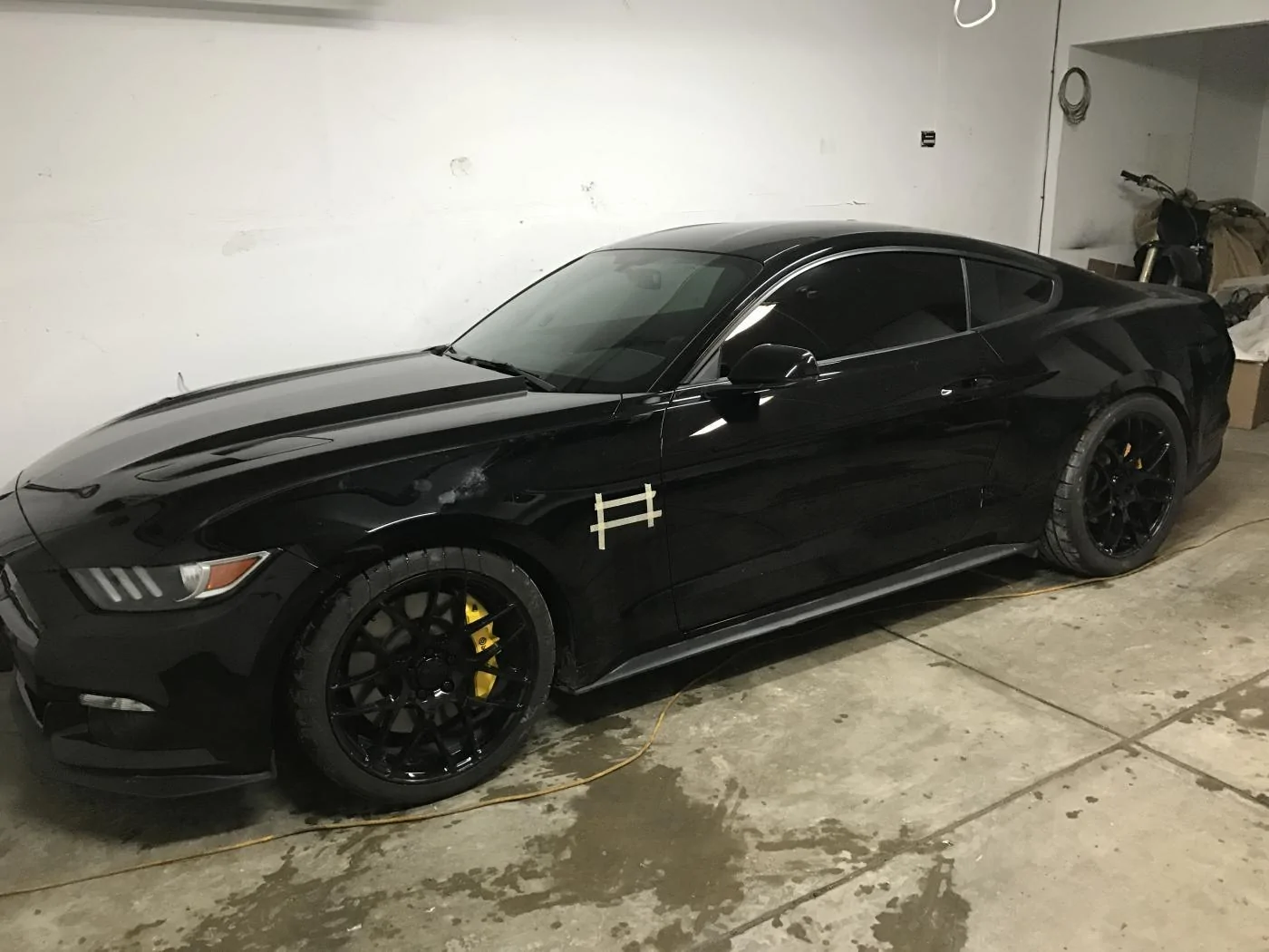

My car is blacked out and will be using the g2 paint ! Will be here today I went with yellow so I will post pics on how it comes out !!

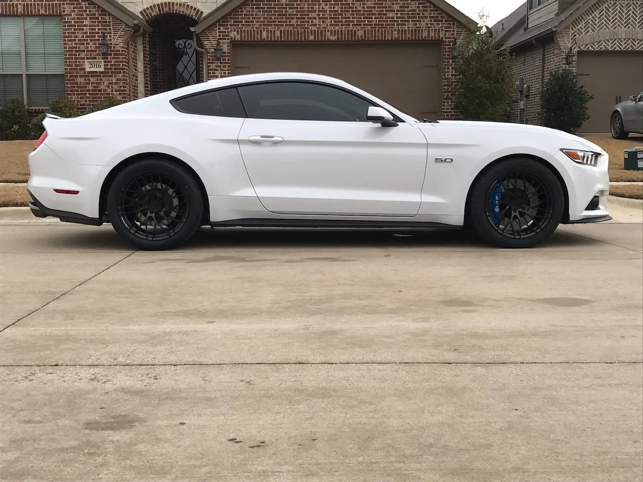

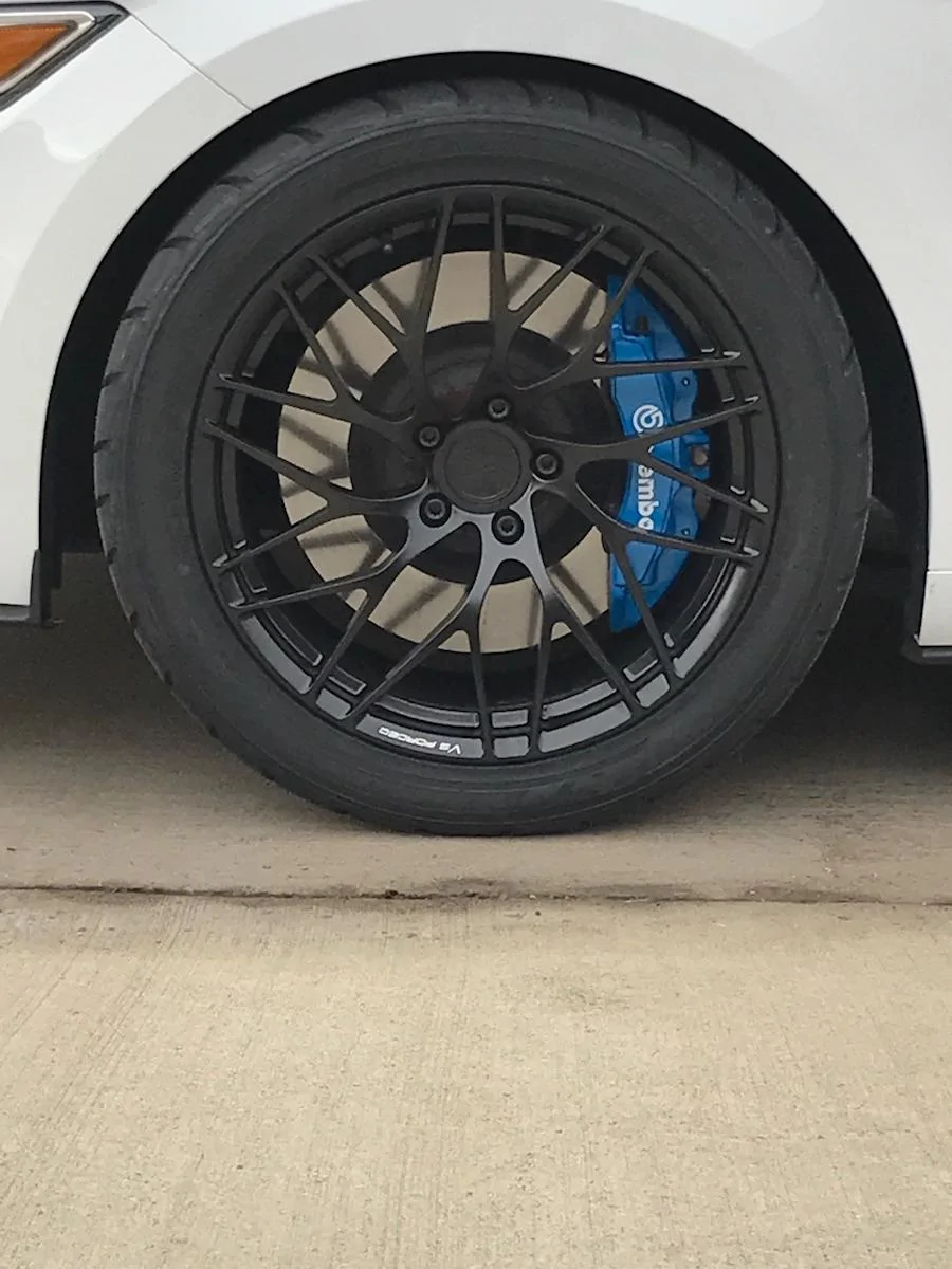

I did mine grabber blue. Be careful if you get their spay. Shit gets everywhere.

Here is mine I just did yellow calipers came out good !!!
